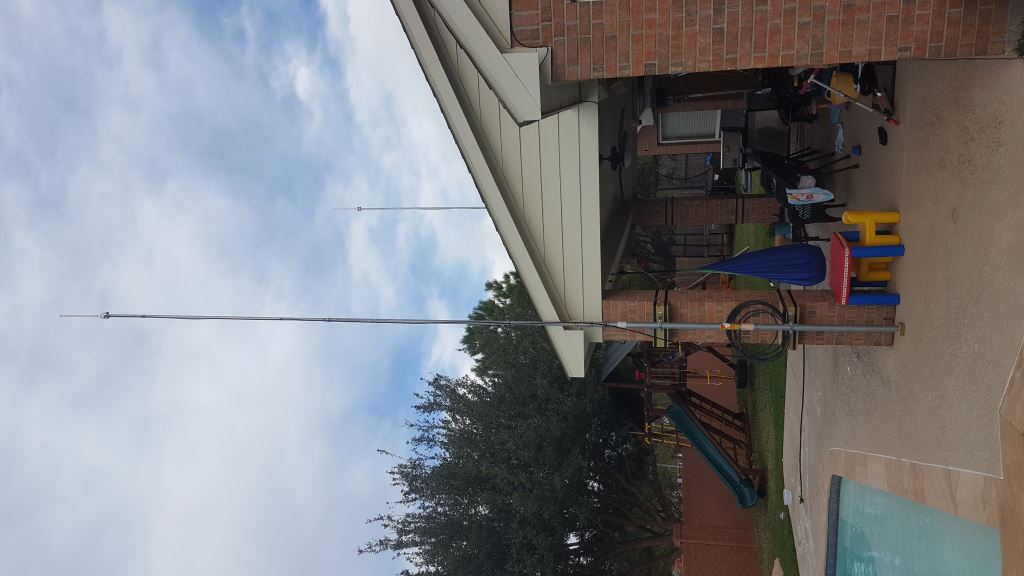

Only going to try on the rx and see if there is an improvement. Just so happened to get to talking with an engineer by chance and stumbled onto this subject. He said he's been doing this for years and his components were very similar he's using 2 20w amps on a retractable mast mounted at opposite ends of the house. He said he could penetrate through trees 3 miles away and when he emailed me a pic I was impressed. He has set up several for clients that don't really have much mobility and this is a perfect solution to view anywhere on the property. Here is a pic of his gear.

Pretty awesome! I seen something similar except they had there antennas in trees with a good spread like that. Did he mention which antennas he used?

I can find out. I ended up with a 10w version of the amp he was using. But basically said any good 9dbi out door omnidirectional. I need to separate mine but just haven't felt the need based on the results I have now. I am still blown away every time I fly.

OMG!!! I need that!!!
What's a setup like that run?? Looks pricey! Amazing...but pricey.
