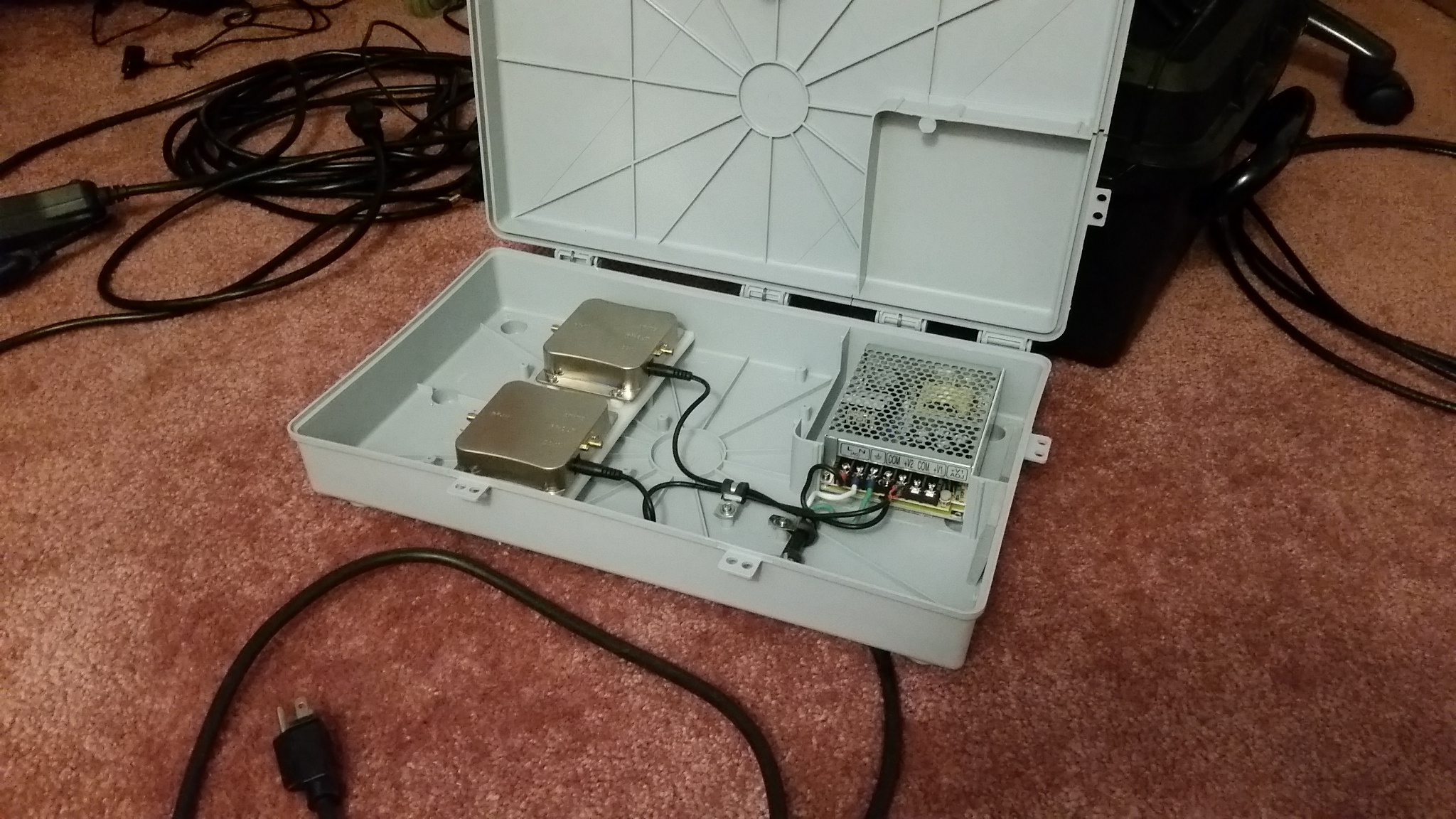

Spent a day fabricating a enclosure for amps with a dedicated switching power supply (4 amp). Was going to put the
RF Linx in it and prbly still will, but I'm missing some hardware for those and still need to open their cases up to power them up (Not using injectors).
These puppies here are 8 watts and I already tested them out with exellent results.
Ordered several assembled N-connecter LMR-400 cables and all the needed N-adapters. Spent the weekend finishing up amp and power supply wiring. Now hafta wait for flying weather to try it all out. Here is my RF-Link internal power bypass. Decided against drilling out the proper power jack, but this will work well.
These puppies here are 8 watts and I already tested them out with exellent results.View attachment 72342
