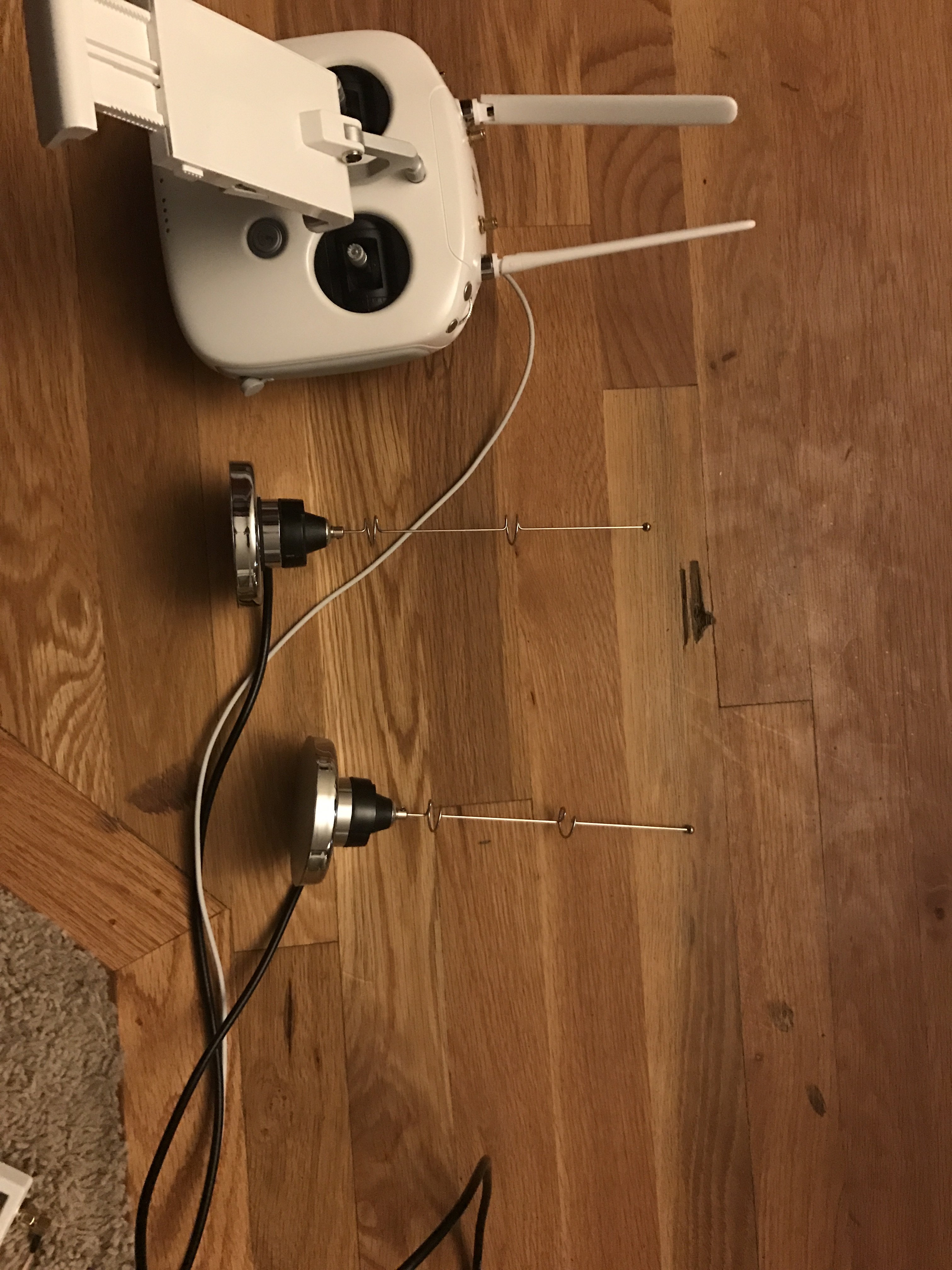

Getting ready to test these. Couldn't believe how small they are. L-com 2.4ghz 5dbi Omni. Hopefully the performance is acceptable. Nobody would even notice then.
Oh my word...please do let us know how they perform...

I installed those
TP-LINK TL-ANT2415D 2.4GHz 15dBi Outdoor Omni-directional Antenna, N Female connector, weather resistant https://www.amazon.com/dp/B004I5J2XY/ref=cm_sw_r_wa_apip_V81BRCTmybq9t
And I got two sunhans 3 w golden amplifier
However the result is not satisfactory.
1- the range is very limited if I do not use the amplifiers , and I use the control signal before loosing the video feed.
2- if I use the amplifiers the control signal is very good , however the video feed deteriorate and I found all the channels have too much noise.
I understand that I can only use one amplifier on the control side , but how can I determine which side is the control one .
I installed those
Attach small WIFI antennas to controller. Turn drone/controller on and stand 50/75 feet away from drone. Quickly unscrew one at a time the wifi antennas to see which is which. Don't allow much time to pass while antennas are disconnected, just long enough to tell what is control/video. Another method would be to cover each wifi antenna with foil while standing far away from drone, blocking signal to identify the video/control sides.

Well for one the preferred antenna would be 8.5 to 9dbi. Do u use the channel hack? High loss cable would give this result as well. Any details on that or did I miss it?
