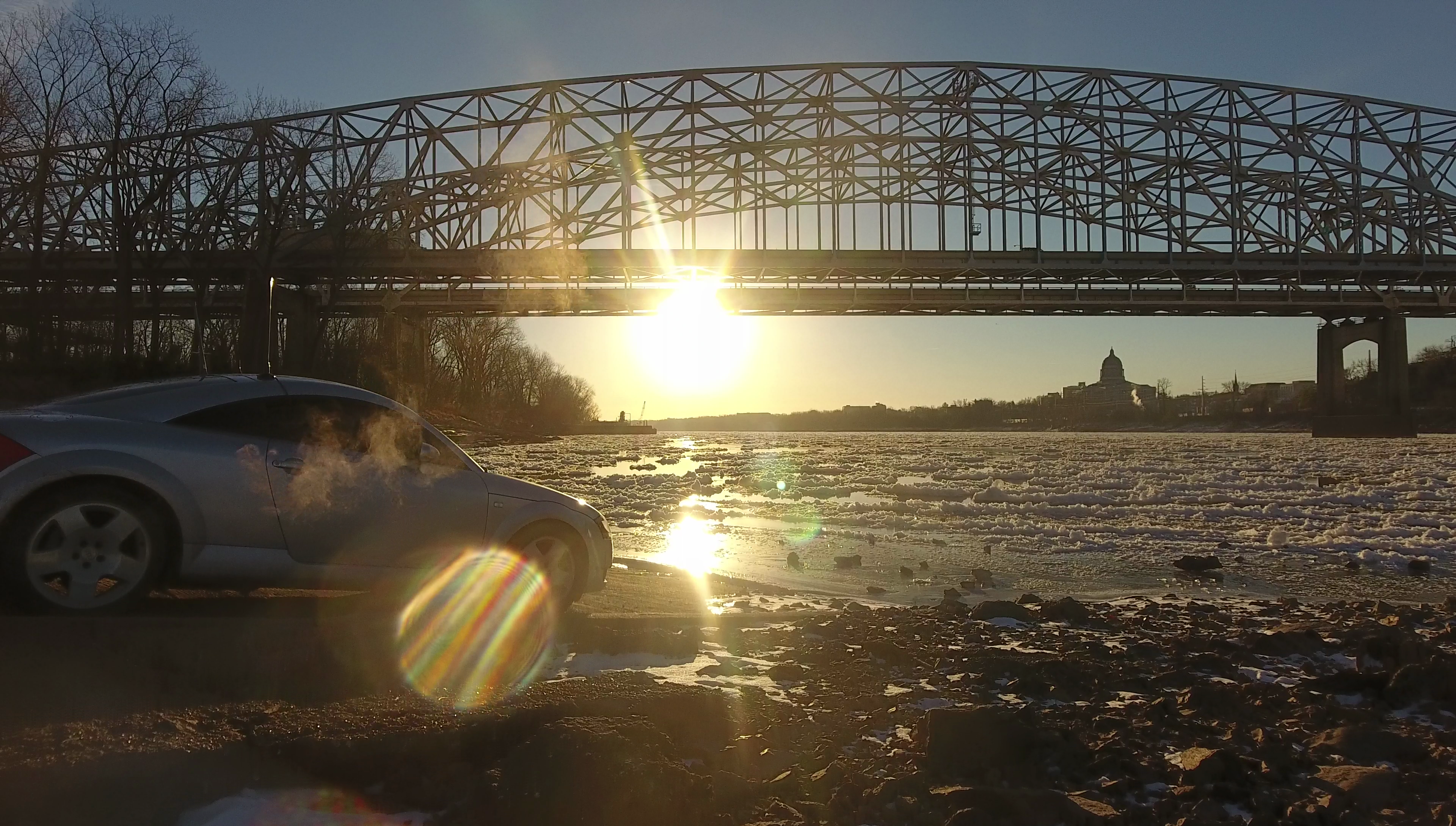

Idk really. I am just sharing what I found today. The videos in the beginning of this thread I used to go into this creek next to the river behind some trees. I could follow the creek skimming the water a good ways. I was using the older black ones then. I couldn't do that today with the gold one. But it still did very good otherwise. Here is where I parked this morning to get a pic. The capital was 8000ft away with two huge steel bridges in between. I flew feet off the water a good ways there signal was full the entire flight.
Reactions: Bear501 and JohnnyB
lol well ive never had a faulty power connection
Idk really. I am just sharing what I found today. The videos in the beginning of this thread I used to go into this creek next to the river behind some trees. I could follow the creek skimming the water a good ways. I was using the older black ones then. I couldn't do that today with the gold one. But it still did very good otherwise. Here is where I parked this morning to get a pic. The capital was 8000ft away with two huge steel bridges in between. I flew feet off the water a good ways there signal was full the entire flight.View attachment 71330 View attachment 71331
Pretty darn good pics.
