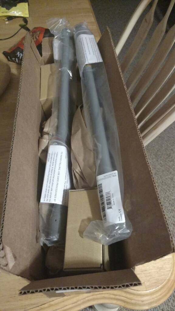

All my cables are in now including the clean install cables. Now Amps and antennas and I may have to take a couple days off.. [emoji16] They're working the snot out of me so hard to find time to do anything else at the moment.
So, how you liking your LTX's? About to get them tuned in the way you like?
