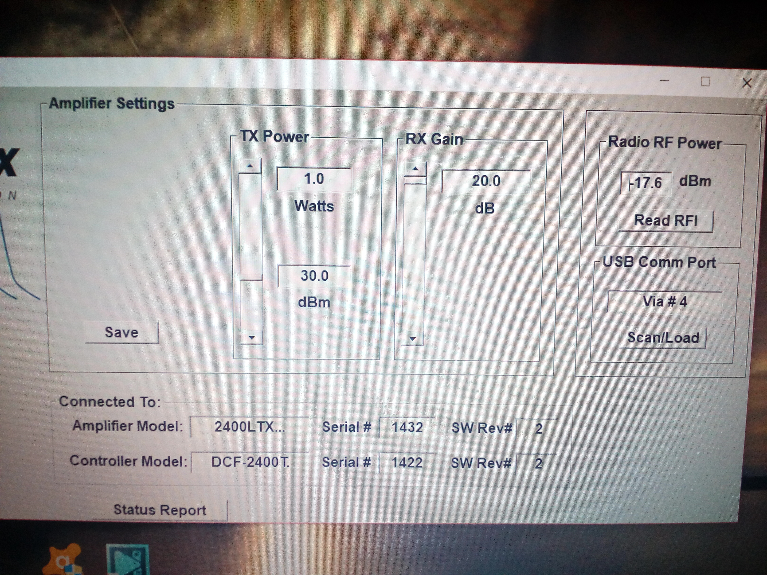

So I finally had a chance to fly using my itelite panel antenna. I flew straight south like normal and went over 2 miles no problem as long as I kept the panel pointed right. So that means that something is wrong with my antennas on the roof, I guess.
This is the numbers from my antenna booster.
Your antennas and boosters are probably no good anymore and need to be sent to my address for disposal........

The new update requires more memory so where I didn't have to do this before, I had to start using a lesser video quality and couldn't use auto channel anymore. Now fly on channel 20 and 6mbps with no problems. Have you tried changing any of these settings yet?
"What's a update?"..............

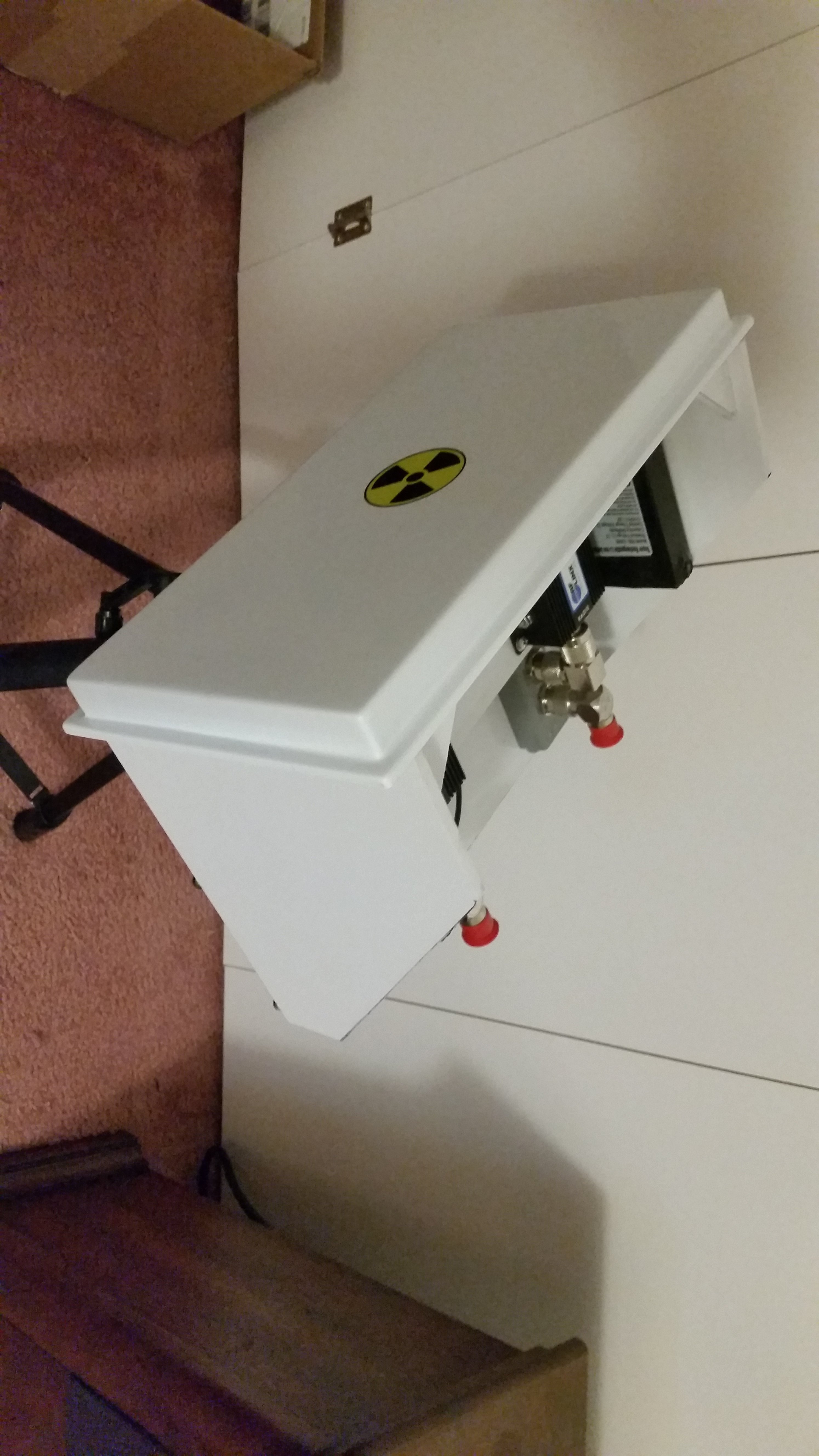

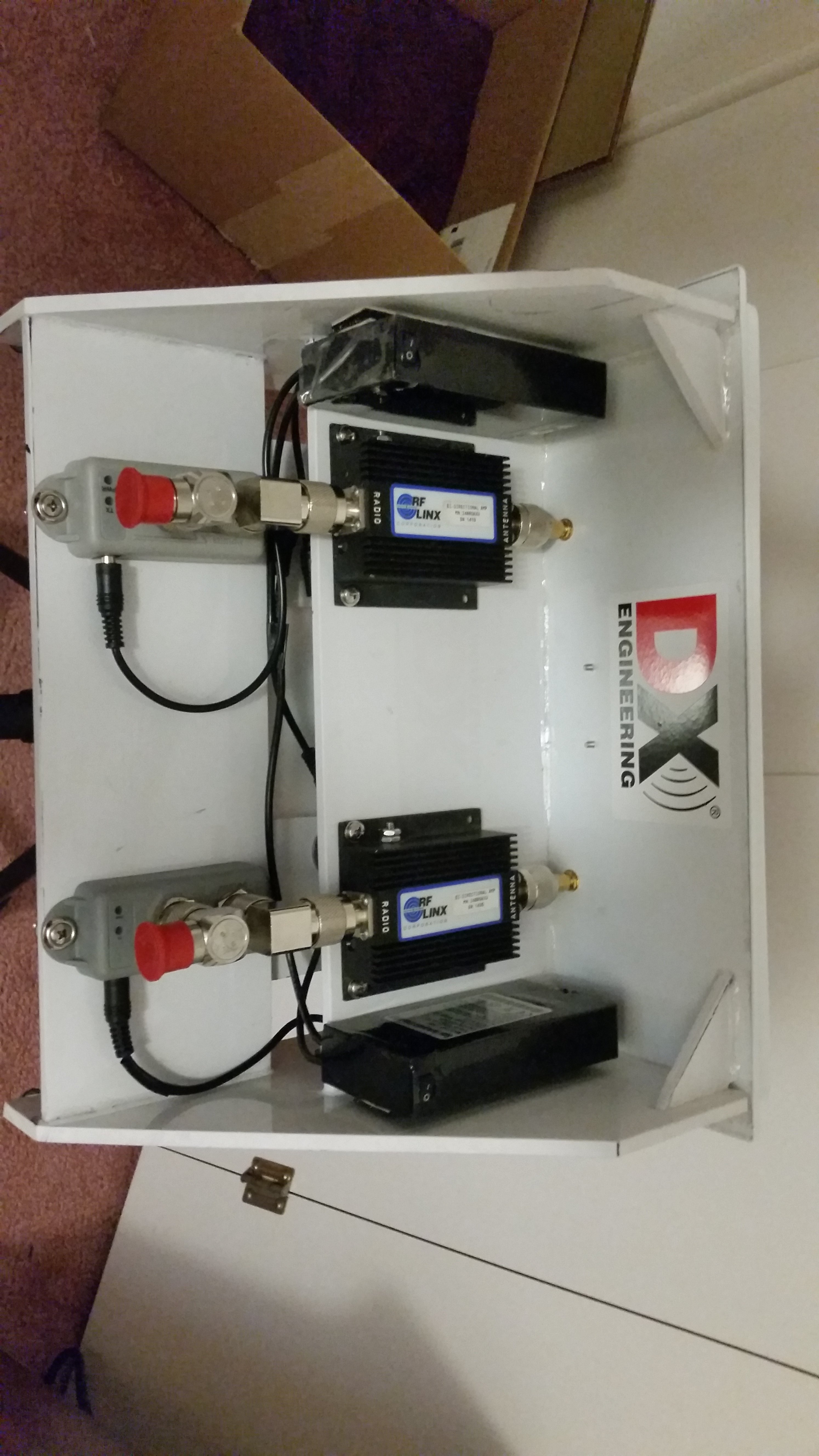

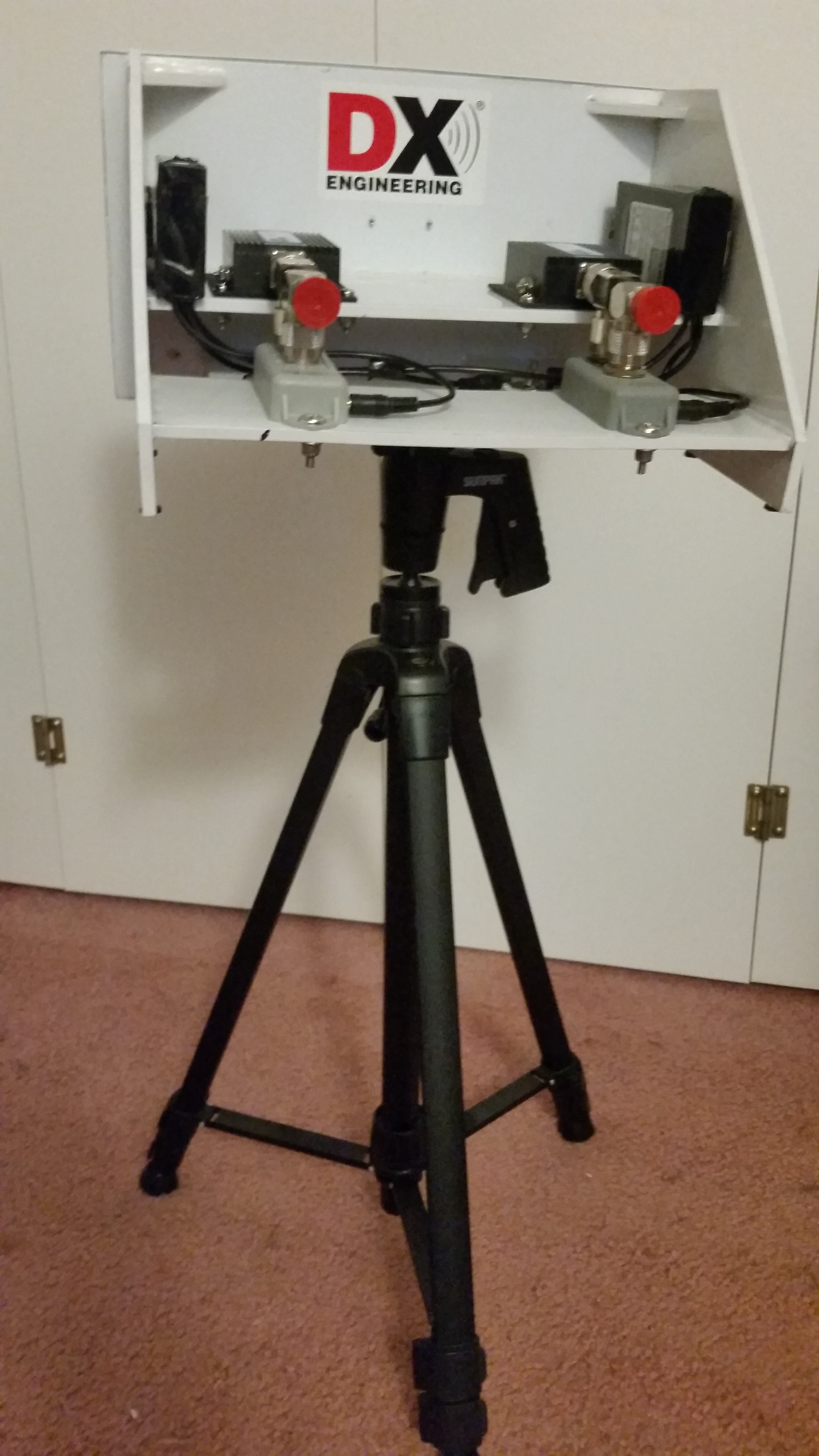

Here is my latest amp/antenna build. Using a Maxx uav 14db panel and 20db(RX) Rf-Linx amps. The module can be removed from the tripod and set on a dash or roof of the vehicle. It also doubles as a mobile microwave oven to cook eggs and bacon while out in the field.
View attachment 92188 View attachment 92189 View attachment 92190
Son.. that's about as good as it gets!! Brilliant! I love the direct mount of the RF-Linx and the way it looks on the tripod... Then you with the Goggles standing behind it... And eggs and bacon a few meters ahead... Love it! Super great build Gram!
According to this document for the rf-Linx 2400LTX, the RFI reading is for a TX cycle only..... last paragraph
