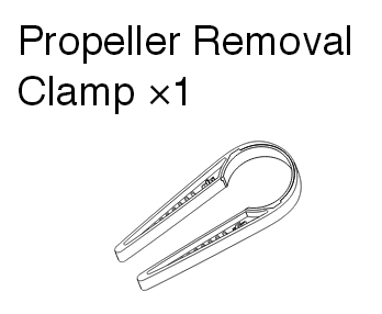

I hand tighten and then quarter turn with the supplied wrench to be sure (as opposed to hand tighten alone)
What tool is that?
I don't think i got one with my P3P, i purchased it 4 days ago and its the revised motor/shell version.
