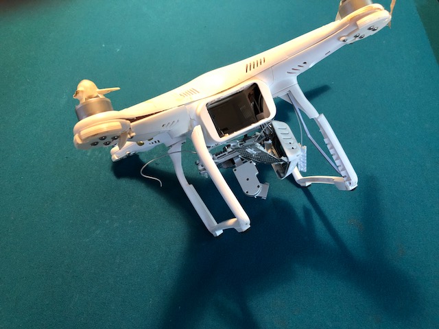

    As I have used the search feature I am sure I have found the why...but will get the data as others have linked it and will get that figured out as well.
    I was 2 minutes into a flight and climbed straight up to about 150 feet and was getting my bearings for a flight over a house that burned down a 1/8 mile from me. It was a cloudy overcast day and I did NOT calibrate compass first mistake. Drone was out of site and I had clear picture..I was about to head over to my destination when screen went black and into ATTI mode. My screen went black and it continued to say atti mode. I can not tell you if screen came back as I was anxiously looking for it and until I heard it screaming towards ground about 150 yards away from me was first sight of it. I tried to quickly recover but it happend in a split second.
    I was reading this happens from time to time and you should always have line of site to fly it but how can you do that when we frequently fly out of site?
    Other question is it worth trying to find another "drone only" or just buy another set up? 54310387166__7E9ED0A6-37F2-45DB-823F-121DC1BB46D2.JPG

    Yeah, get the data from your mobile device.
    Instructions are on the link.
    DJI Flight Log Viewer
    Ouch, that really sucks.
    Rod

    If you have already linked your data, might I ask why you started another thread for this? And just for the sake of saying it. Not calibrating the compass was not a mistake. You rarely ever have to do that.

    You were not very clear in your statement about that data. We can give you some answers when we get the data to look at. My first guess and its only a guess is that there was a compass error, yaw error and or speed error someplace. Cant tell you anything posititively until we see the data.

    it looks pretty bad, I would look for a second hand unit.

    @Himark Just to give you a heads up on one thing. I am taking a guess that this data will not show us anything. I say this because you mentioned the fact that your screen went black, which I can only assume means you lost FPV, which in turn means you also lost data transmission. It is still worth a look though, there could be pre data loss factors that may be present. That is your call.

    Repair this one. New body shell, few new parts of gimbal, new OMFD board cover.

    If the compass is out of calibration, you can't fly straight and you would get into trouble within a few feet of launching.
    But the compass does not lose calibration and recalibration should never be necessary under normal circumstances.
    If you want some help, you will need to supply flight data.
    Without data, no-one has any idea what happened to your Phantom.

    Just an update..I have not been able to get the data as we sent our mac computer the the repair store as it would not boot up. Hoping to have it back soon so can get that data. One question I have is....Is there any salvage I can use from the craft?
