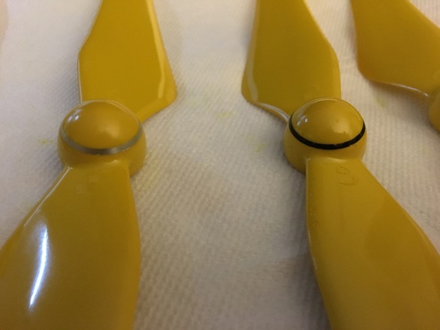

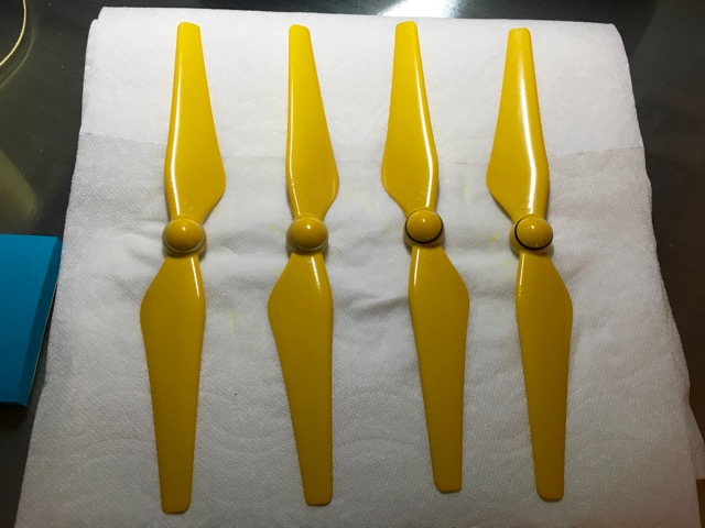

Just dyed these yellow using the same process and dye...
Reactions: Sim597 and nhoover
Can you still see the black prop rings versus the gray prop rings? In the picture, it looks like you can't.

It's incredibly easy. First, the dye costs about $4.99 a bottle. You put a pot on the stove at least as wide as the props. Heat up the water to between 180-211 degrees (212 is boiling, so just under boiling). Pour in the bottle of dye. Mix well. Drop in props. Stir every min or so for 20 mins. Place pot in stainless steel sink. Run cool water into pot until dye runs out and water is clear. Wipe off props a bit and let them dry. Thats. it.
Im looking for electric blue or green seems RIT doesn't make the synthetic in those colors :(
I know these props are pretty glossy, does the surface become any tackier or less slick afterwards? In the pics they have a shine but want to ask.
You let them sit in color for 48hrs?
Yup, a gallon of water and about 4 caps full of rit. I looked at them at 12 hours and they were splotchy and the color wasn't even. They had light and dark streaks. There are still a few faint color variations but less noticeable now.
