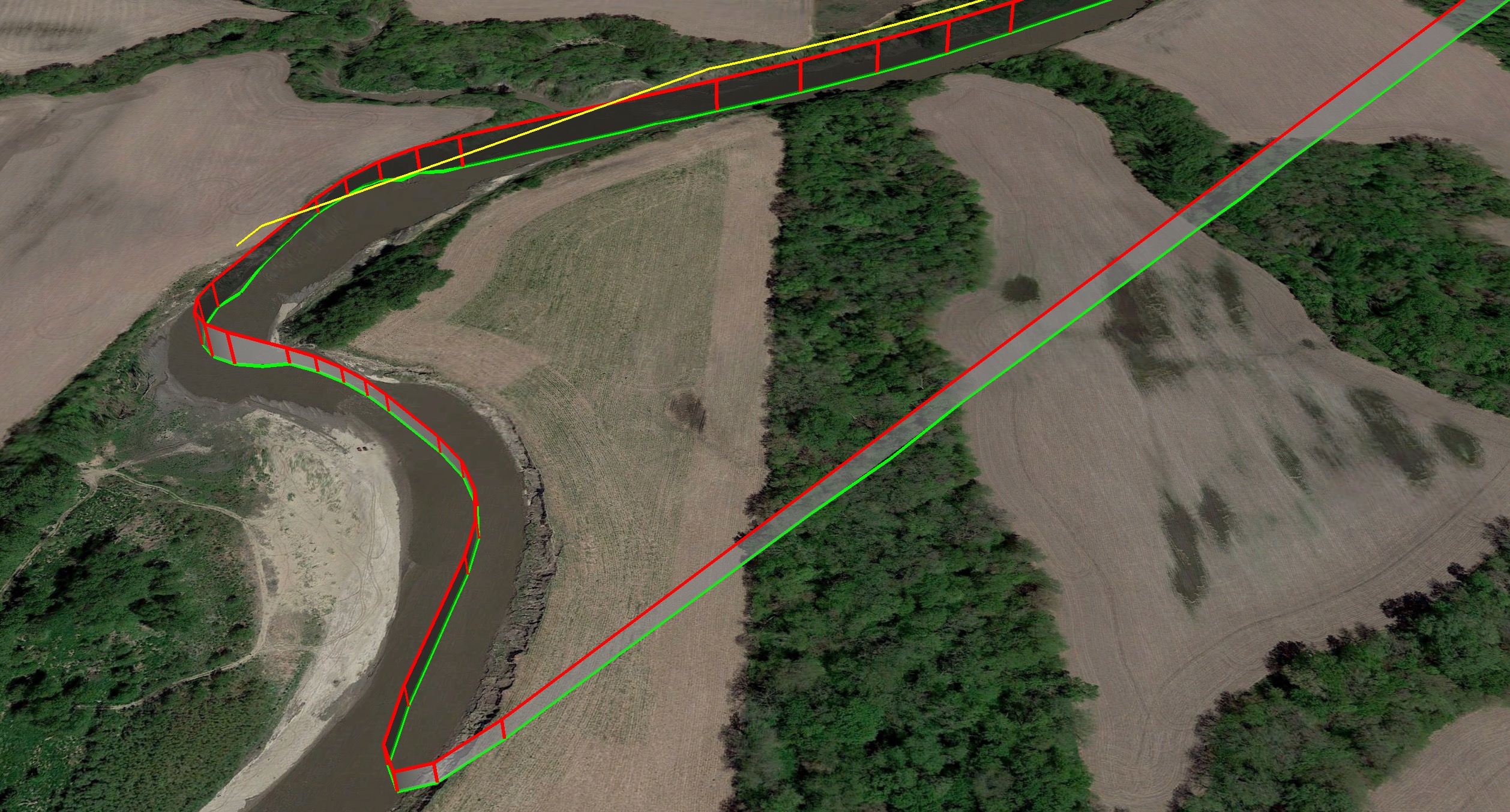

It looks like your flight was probably fine while over the water, but on the direct line return the ground clearance drops to less than 30 ft. If those trees are higher than that then it likely hit one coming back. I'd check that line.
That is what I was thinking. I went out the other day thinking it may be in the first line of trees but I could not find it. They are definitely higher than 30 feet. The snow is melting fast so I may have to go back out there!
Reactions: Wahoo_Ace
Then that's almost certainly what happened. Good luck with your search.
Reactions: MotorCycle-Man
Can you show me how you can tell it was less than 30'? I know, I know, if I can't figure this out then I shouldn't be using Litchi! Trust me, the best way to learn is to screw something up! Thank you!!
What I did was to export your Litchi mission as a 3-D kml file, import it into Google Earth, then duplicate it and clamp the duplicate track to ground. Then you can compare the flight track and ground track elevation profiles, either manually in GE, which is what I did in this case since it was pretty simple, or you can compute an actual AGL dataset as described in this post.
Amazing. Here I thought I could just upload this stuff and away I go! Great write up!
It boggles me that the drone wasn't right in the start of the tree line but I will go look again. I really screwed up by not setting waypoint 15 to a much higher elevation for the trip back home. I appreciate the help!

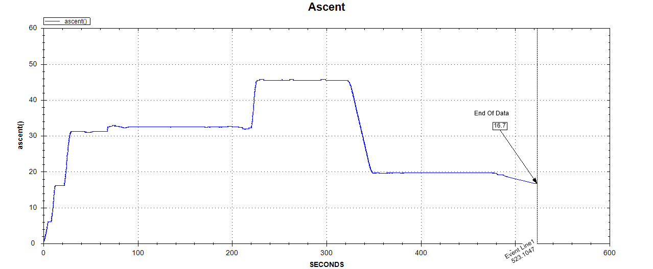

I agree with the above theories, that you didn't clear the trees on the return at Waypoint 15. This is neither here nor there at this point, but 50ft in altitude is far too low. And I will ask @sar104 to verify this, but if this is the correct altitude in feet, then it's even worse. Otherwise, the tree line would be the first choice.
Reactions: BigAl07
My plan was to fly down the middle of the creek low and then come out at the end. There is a steep cliff on each side of the creek at the end points. I went back out with my new drone and ran a mission from point 15 to 16. However, when I ran the mission, the bird was JUST above the first trees and I aborted as not to lose a second drone up in the trees! I am pretty positive it made it out from above the water.
Once I find this, I will post the video as it should be epic! :)
Reactions: BigAl07
Right - that doesn't give any clues on what happened. As I mentioned above, your hypothesis that it hit trees on the return seems most likely.
