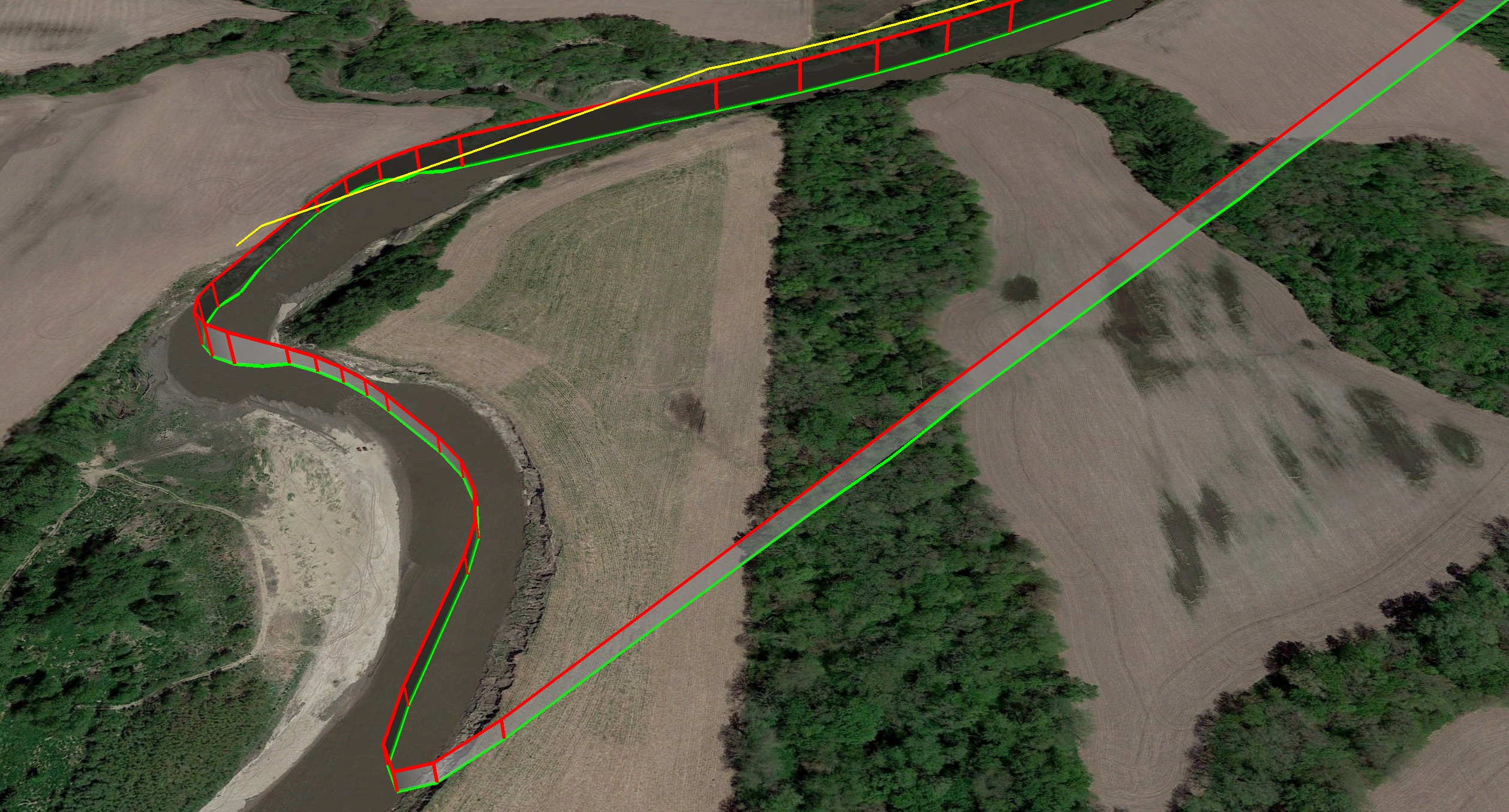

It looks like your flight was probably fine while over the water, but on the direct line return the ground clearance drops to less than 30 ft. If those trees are higher than that then it likely hit one coming back. I'd check that line.
I agree. The pilot should have inserted a waypoint just after #15 to raise the climb. My guess it will be found in the trees between #15 and #16

Perhaps in the future, an improved version of mission parameters will become available, where you could review your mission path horizontally.
The altitude deviation would have become obvious from the gitgo.
Maybe it's already there, just a thought.

As far as the branches go, I did NOT have a prop guard on! The drone was definitely doing its algorithms trying to find out where it was! I'm sure it's easier said than done but a great feature for Litchi would be to have it rise should it encounter an obstacle. More often than not I am sure obstacles will be trees and if the drone continues to rise rather than try and go around the obstacle, it may help things. I'm sure their engineers would say it is much easier to just set your waypoints higher next time!!
That would be great! However I am sure Litchi is limited to just how much info is in Google Earth. If I had a 3d view of this area I would have known. In the future I will just make sure anything over trees is above 75 feet as most trees around here are under that. Of course, while staying in VLOS!!
