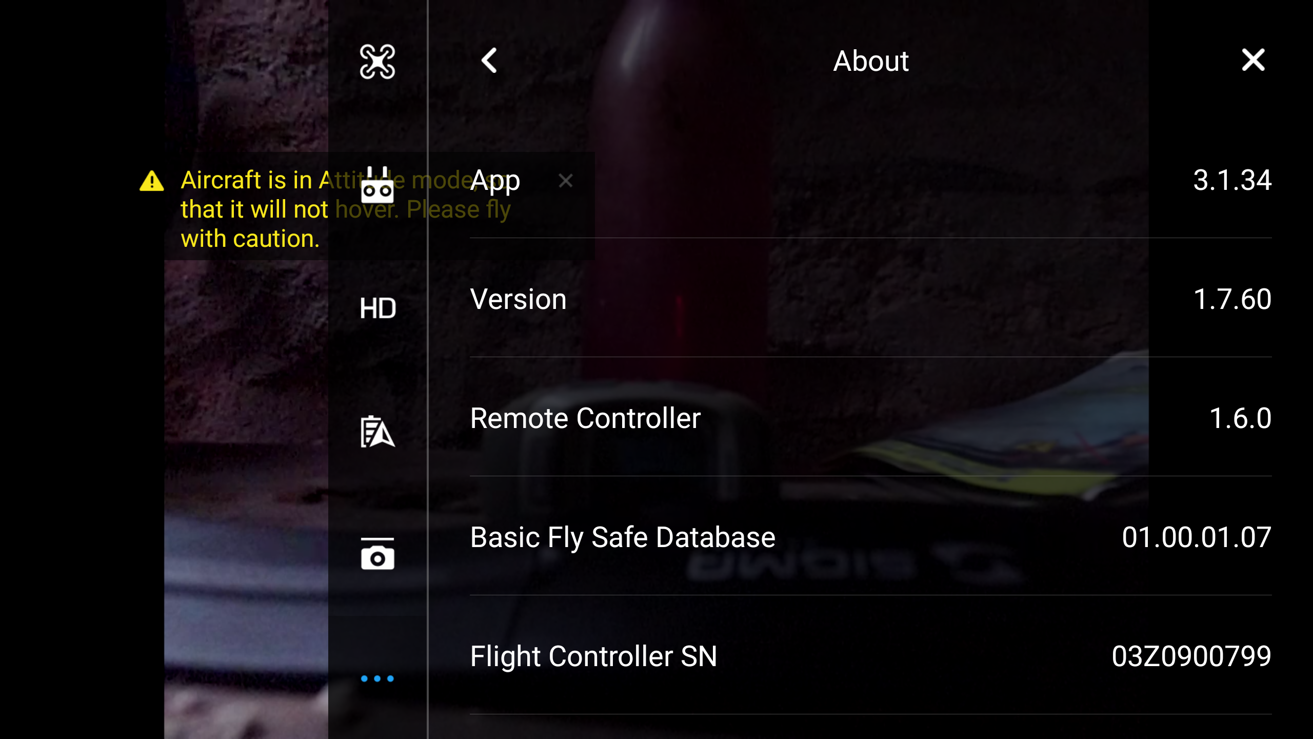

Thank you, has been successfully through your tutorial to AC relegated to 1.76, RC relegated to 1.5.8, but my test result is "DJI GO" have been unable to downgrade the RC, I'm through "DJI GO 4" downgrade RC to 1.5.8, hoping to help a friend in need.;)

    • When I went to flash from 1.8 to 1.7, it would not downgrade in the normal method, I had to use the debug file
  9. Start up the DJI Go app and check the FW versions (you must not have any plus signs next to the numbers) and use the 'restore default settings' option
    • If the DJI app shows version numbers like 1.7.6+ (note the plus sign), this means that some modules did not get rolled back as they should have. In this case, you may have various issues with the compass, video feed, gimbal, etc. Reflash the 1.7.6 FW with the 'debug' file on the SD card.
  10. Perform a reset of the settings via the app.
  11. Profit! (?)

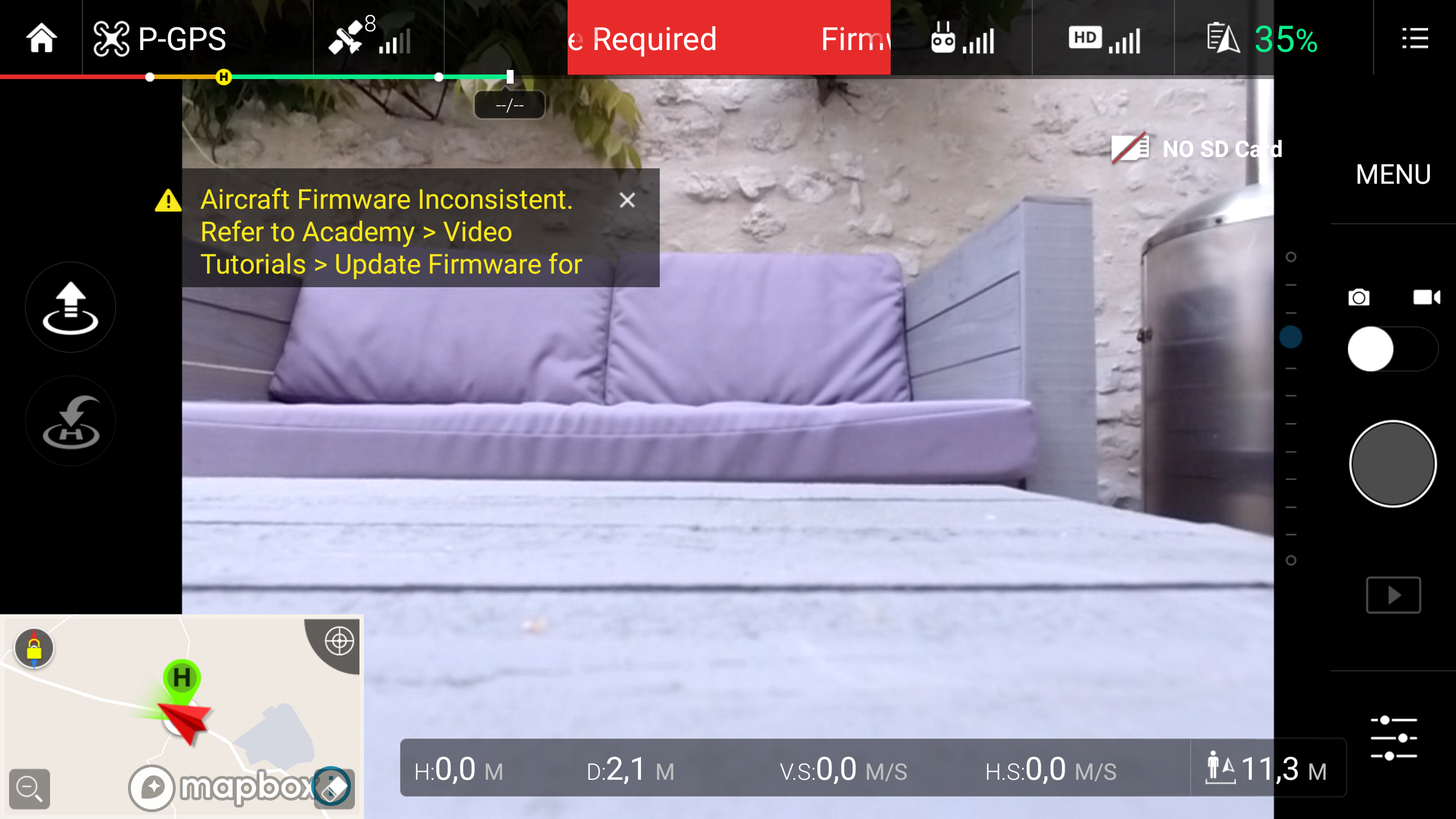

If you finish this and the FW versions list in the DJI app still show version numbers like 1.7.6+, something bad happened and a module(s) still did not get rolled back. Currently, the only possible fix is to update the firmware back to a point where the plus signs go away and work your way back again. This is not a guarantee that all will be well and you can try again, you may truly be stuck and have to send your bird in for repair.

Hello to everyone. I'm a french new owner of a second hand Phantom 3 Pro, which is my first "real drone".
Having a ESC problem, which have been temporarilly solved by the 1.11.30 DJI FW, but reappeared a few flights later, I'm assuming that this error is a software problem, so I hope downgrading my drone could solve it !
Thanks to this post, I was able to succesfully downgrade to 1.07.0060. Thank you Airbender !!!
But as you could notice, I have a Aircraft Firmware Inconsistent message. Does anybody know what it means ?
Maybe it's because I'm still using too much recent version of DJI Go ? I have downloaded a patched 2.4.2 version but still hadn't time to test it.
Other thing: it's impossible for me to downgrade my RC. I tried many times the graduation cap method, but it never worked... Always had a fail message...
