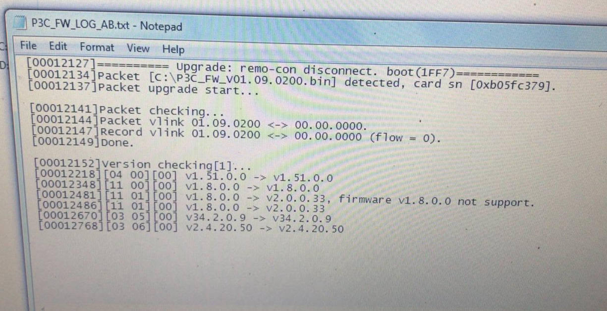

Can somebody tell me why in my log file, the versions checking start with module 400 ? For any other log files starting with 305,306.
Order doesn't matter.
And why - because this is how DJI programmed it. The order probably depends on order of responses from modules.
