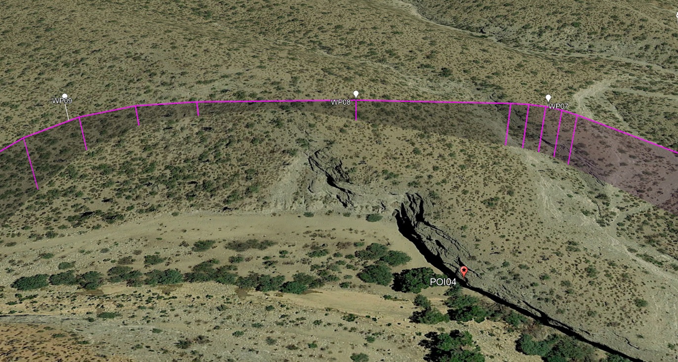

Litchi mission 35 ft AGL to search for a lost Phantom 4.
On subsequent flights the Phantom 4 was not spotted. We know the flight path and area the drone had to make contact with the ground. Can post data if anyone is interested. More search patterns planned when the weather cools in the Arizona desert.
A Phantom 4 that was lost on a Litchi mission Aug 15 was found yesterday Oct 9. A keen eye spotted the Phantom in a search video on Oct.5.
The pilot was new to Litchi and made a change in the field from 100 ft AGL to 180 ft thinking it would be safer raising the altitude. With no internet connection it actually lowered the flight altitude. After checking on Google Earth I determined the Phantom 4 flying sideways would not make it past a point between WP7 and WP9. I added the Waypoint 8 where I thought it went down. After four trips on torturous 4X4 roads and two 1 1/2 mile hikes the beautiful Phantom 4 was recovered with no visible damage, not even a broken prop.
The mission: Mission Hub - Litchi
AirData shows where signal was lost.

Fly Dawg, Thank you for your reply.The reason for the post was to share the good news that the aircraft was retrieved and also to caution changing altitude settings on a Litchi mission in the field. The cause of the crash was the altitude between two waypoints was 2 feet higher than the path of the aircraft. The aircraft most likely did not end the mission where signal was lost but continued on to the high point. The search video confirmed the aircraft was at that point.
Pilot was advised to load the mission on his tablet and take it with him on his hike. The blue dot (your tablet) will take you right to your Phantom which will be close to Waypoint 8. The aircraft will not be fired up for a few of days to make sure any moisture is gone. It was out there for almost two months with a couple periods of heavy rain. I will see if he can pull up the .dat file and post it.
The aircraft might have been recovered sooner but the temperatures were getting above 108°F. The pilot will soon be posting a YouTube video with the loss and recovery. Look for Ricks Romps
