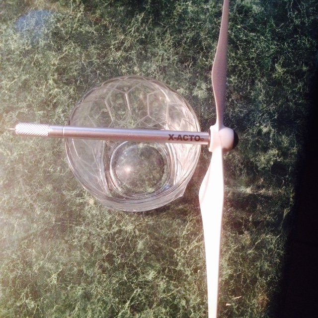

    Hey nick...ya ain't got one and in a hurry ..This works in a jam just fine to check em ;)
    nickyb likes this.

    You can do it with just the correct rod.
    Set it on a level glass or tin can as shown above, by checking in both directions you can do a pretty good job.
    I use fine sandpaper on the heavy side but some prefer tape on the light side.
    Considering the ongoing cracking incidents, anything which helps things run smooth is good.
    I found mine were out quite a bit and when new it caused jello when the motors were more stressed like strong wind or going up fast. Haven't seen that since they were balanced (and no cracks either)
