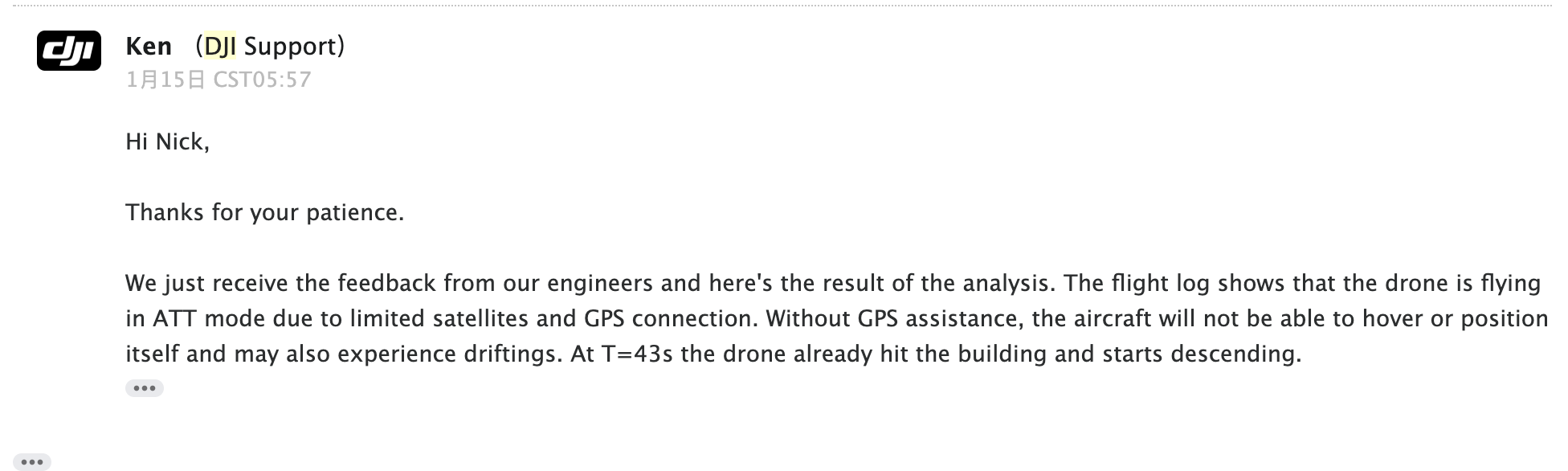

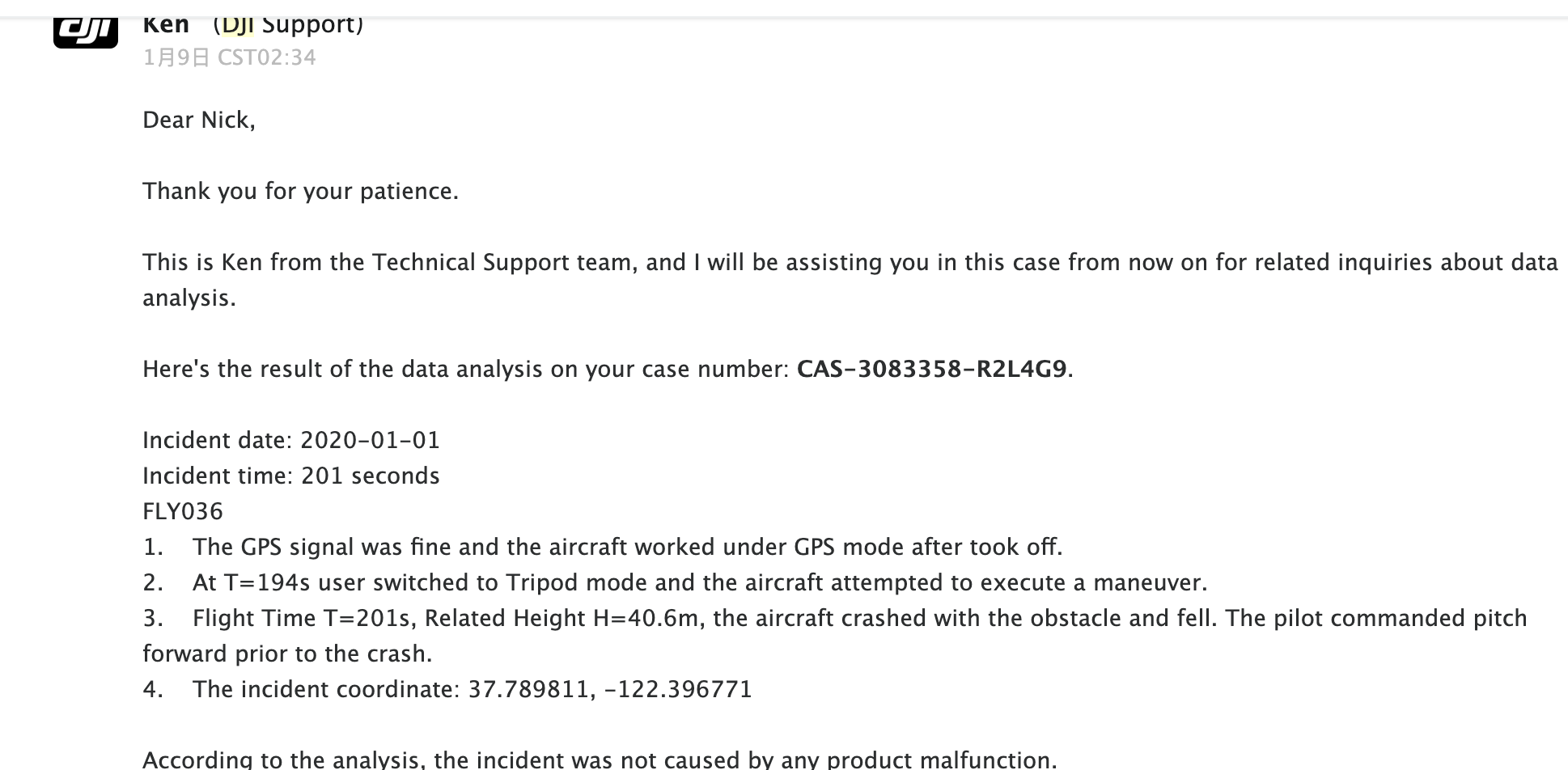

I have the mavic mini and have just had my first flyaway. I thought it would be a simple warranty repair /return since ive only flown the thing for about 30 minutes , but after a month of back and forth BS I relented and DJI sent me back a box of broken dreams. I have two questions for the group . The first is whether or not they could verfiy that there indeed was a firmware issue that caused the flyaway. The flight log records are here FlightRecord - Google Drive . On new years day I was in downtown SF and wanted to get some shots near Embarcadero. Due to the notorious GPS unfriendly neighborhood, I had to recalibrate that thing every time I took off so Im confident that I had done so before the last flight. In any case, on my last flight I flew my mavic straight up for about 40 seconds before it just darted off on its own about 20 -30 ft towards the nearby skyscraper. There was no other flight control input other than ascend. The drone smashed into the building than came straight back down to the ground in pieces.
I submitted this information and my drone to DJI . The first tech told me the GPS was working fine and that i made it crash into the nearby building. After i questioned this, he revised his statement and then said that after analysis, in fact the GPS wasnt working, I lifted off in bad conditions, and again it was my fault for the crash. I have enclosed the two conflicting assessments . This brings me to my next question which is if a DJI tech cant tell me exactly why my drone flew away , other than it was clearly my fault, who am i supposed go to in order to properly assess the cause of my crash
It would be very, very rare for a firmware issue to cause a flight incident, lots of other users would also have similar incidents if it did.
I've looked at your flight data and can verify that the issue was not due to a firmware issue.
Your flight data shows that you never had any GPS reception for the duration of the flight which was in atti mode.
Without GPS, your Mavic had no ability to hold position and no "brakes" and would easily be blown around by any wind.
While most of the control inputs were the left stick to climb, you also made inputs in each control axis.
Without brakes, the Mavic would have continued coasting for any horizontal movements you commanded.
The crash happened at 43 seconds, immediately after you had applied full right stick for 1.2 seconds and that will have been the cause of the crash.
The first assessment must have been for a different flight since the last flight was over in less than 50 seconds.
The second assessment appears to properly match what the flight data shows and is correct.

This is what I see:
  • You took off without GPS assistance
  • The aircraft ascended nearly straight up to 126 feet
  • You switched the flight mode to Tripod and ascended up to 132 feet
  • The aircraft crashed into an obstacle after you commanded it forward with the right stick in the full up position for about one second
It looks like you might have been flying closer to the skyscraper than it appeared from the ground and accidentally maneuvered the aircraft into that building.

The above assements are correct. As are those from your screen shot from DJI. Your last elevator input caused the aircraft to impact the building.
27.5 FLY WITH CAUTION (NO GPS)
35.0 AGPS SIGNAL WEAK. HOVERING UNSTABLE. FLY WITH CAUTION(CODE: 30002)
35.8 AGPS SIGNAL WEAK. HOVERING UNSTABLE. FLY WITH CAUTION(CODE: 30002)
38.8 AGPS SIGNAL WEAK. HOVERING UNSTABLE. FLY WITH CAUTION(CODE: 30002)
43.0 AGPS SIGNAL WEAK. HOVERING UNSTABLE. FLY WITH CAUTION(CODE: 30002)
43.9 AGPS SIGNAL WEAK. HOVERING UNSTABLE. FLY WITH CAUTION(CODE: 30002)
45.9 _MOTOR UNABLE TO ROTATE. CHECK FOR OBJECTS BLOCKING MOTOR OR CONTACT DJI SUPPORT FOR ASSISTANCE.)
45.9 `MOTOR STUCK. CHECK FOR OBJECTS BLOCKING MOTOR OR CONTACT DJI SUPPORT FOR ASSISTANCE(CODE: 30165)AGPS SIGNAL WEAK. HOVERING UNSTABLE. FLY WITH CAUTION(CODE: 30002)
46.9 `MOTOR STUCK. CHECK FOR OBJECTS BLOCKING MOTOR OR CONTACT DJI SUPPORT FOR ASSISTANCE(CODE: 30165)AGPS SIGNAL WEAK. HOVERING UNSTABLE. FLY WITH CAUTION(CODE: 30002)
47.9 2MOTOR ERROR. CHECK PROPELLERS AND FLY WITH CAUTION)
48.9 IAIRCRAFT IN ATTITUDE MODE. UNABLE TO HOVER. FLY WITH CAUTION(CODE: 30004)`MOTOR STUCK. CHECK FOR OBJECTS BLOCKING MOTOR OR CONTACT DJI SUPPORT FOR ASSISTANCE(CODE: 30165)
48.9 FLY WITH CAUTION (ATTITUDE MODE)
49.7 VGPS SIGNAL WEAK. SWITCHED TO ATTITUDE MODE. AIRCRAFT UNABLE TO HOVER. FLY WITH CAUTION)
49.7 49.7 IAIRCRAFT IN ATTITUDE MODE. UNABLE TO HOVER. FLY WITH CAUTION(CODE: 30004)`MOTOR STUCK. CHECK FOR OBJECTS BLOCKING MOTOR OR CONTACT DJI SUPPORT FOR ASSISTANCE(CODE: 30165)
