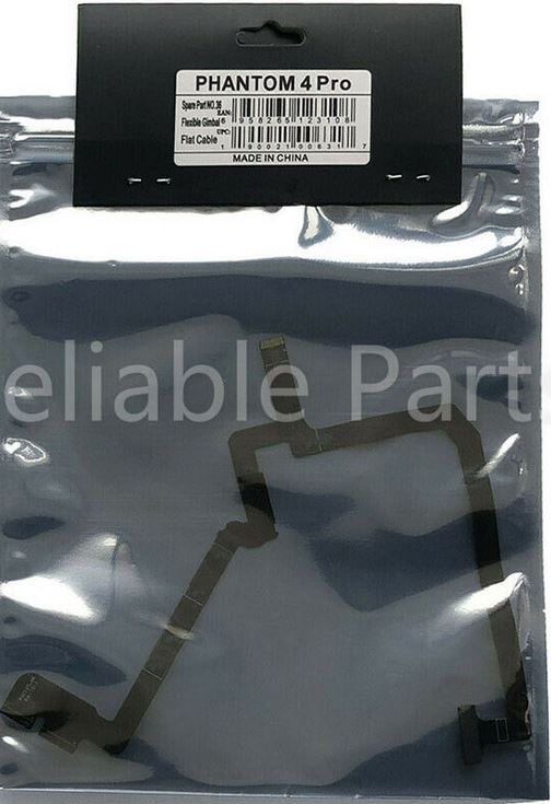

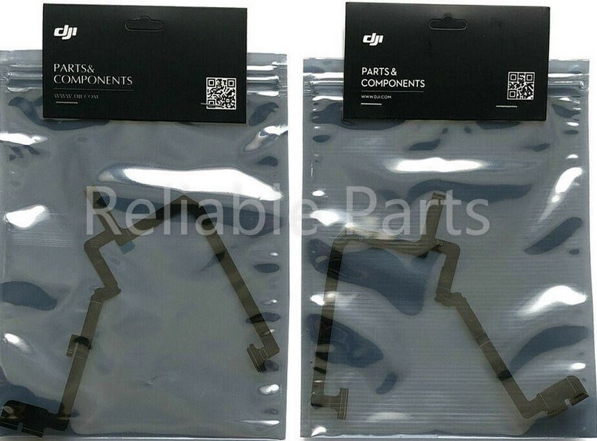

When ordering the flex cable, it's recommended to get the Genuine DJI part.
And then - be sure to get the correct DJI part.
This is where the confusion comes in and apparently, this is a common issue.

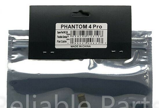

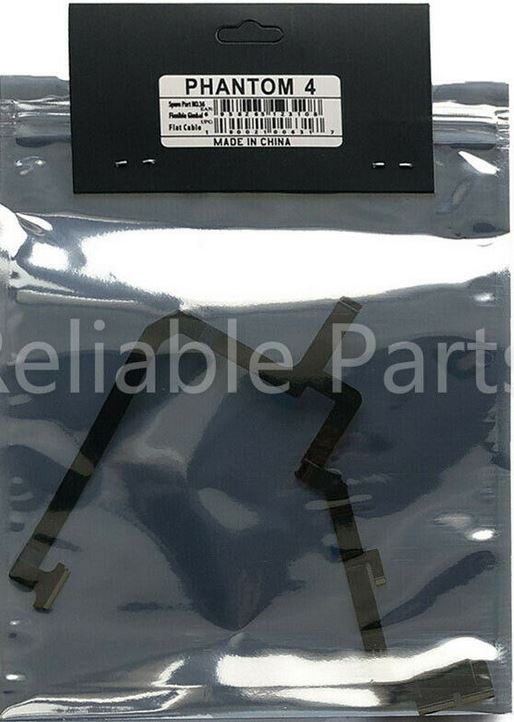

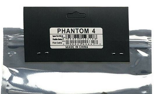

The Phantom 4, Phantom 4 Pro & Advance all use DJI Spare Part #36.
As everyone knows, the cameras on these models are different.
THE FLEX CABLES ARE DIFFERENT TOO
Notice the extra "branch" on one leg of the P4 ribbon..
To the best of my knowledge -
Get the "Phantom 4 Pro Spare Part #36" for use on Phantom 4 Pro V1 & V2 and Phantom 4 Advance.
Get the "Phantom 4 Spare Part #36" for use on Phantom 4.
