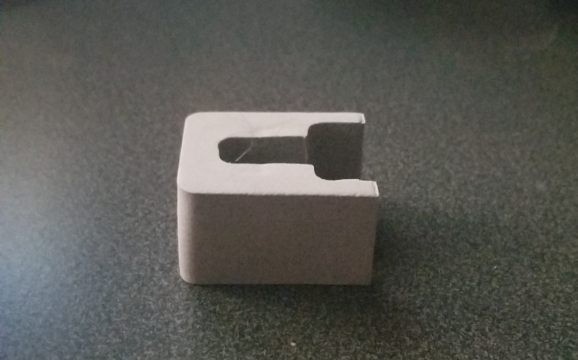

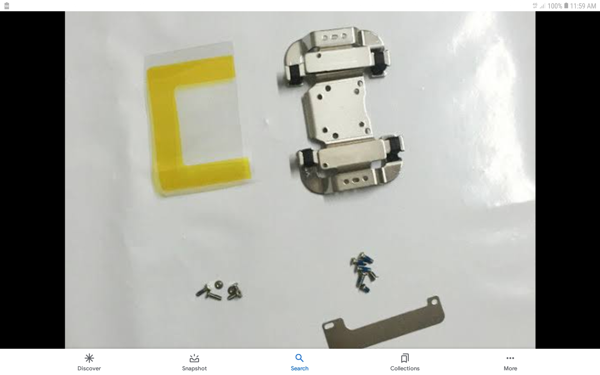

I am gonna just put this out there. There is a small foam rubber gimbal support that attaches just under the bottom side of the hull and wraps around the gimbal arm. It is easy to miss. My first phantom 4 Pro V2 was purchased used, so it did not have this gimbal support attached. On my new one, just purchased last Tuesday, had one and I never noticed, I had the same shaky footage. It was not until I had the drone on my desk and was doing an update that I got a gimbal overheating warning and noticed the support on the gimbal. Took it off and things were fine after that.
hmm, you might have solved my problem. I never saw the gimbal support foam but I will look for it. I may have figured it was part of the gimbal attachment. My drone was purchased brand new from DJI. And you aren't referring to the gimbal lock? The plastic piece that attaches to the gimbal and the landing feet.
Would someone from these forums post a picture of this rubber foam gimbal support?
Oh I think I got it, instead of removing that rubber gimbal support I just removed the sticker. I'm almost certain this is the problem. Once I get it on Monday I will post an update.
Update: The sticker that says "remove before flight" is where this small rubber foam is located.
