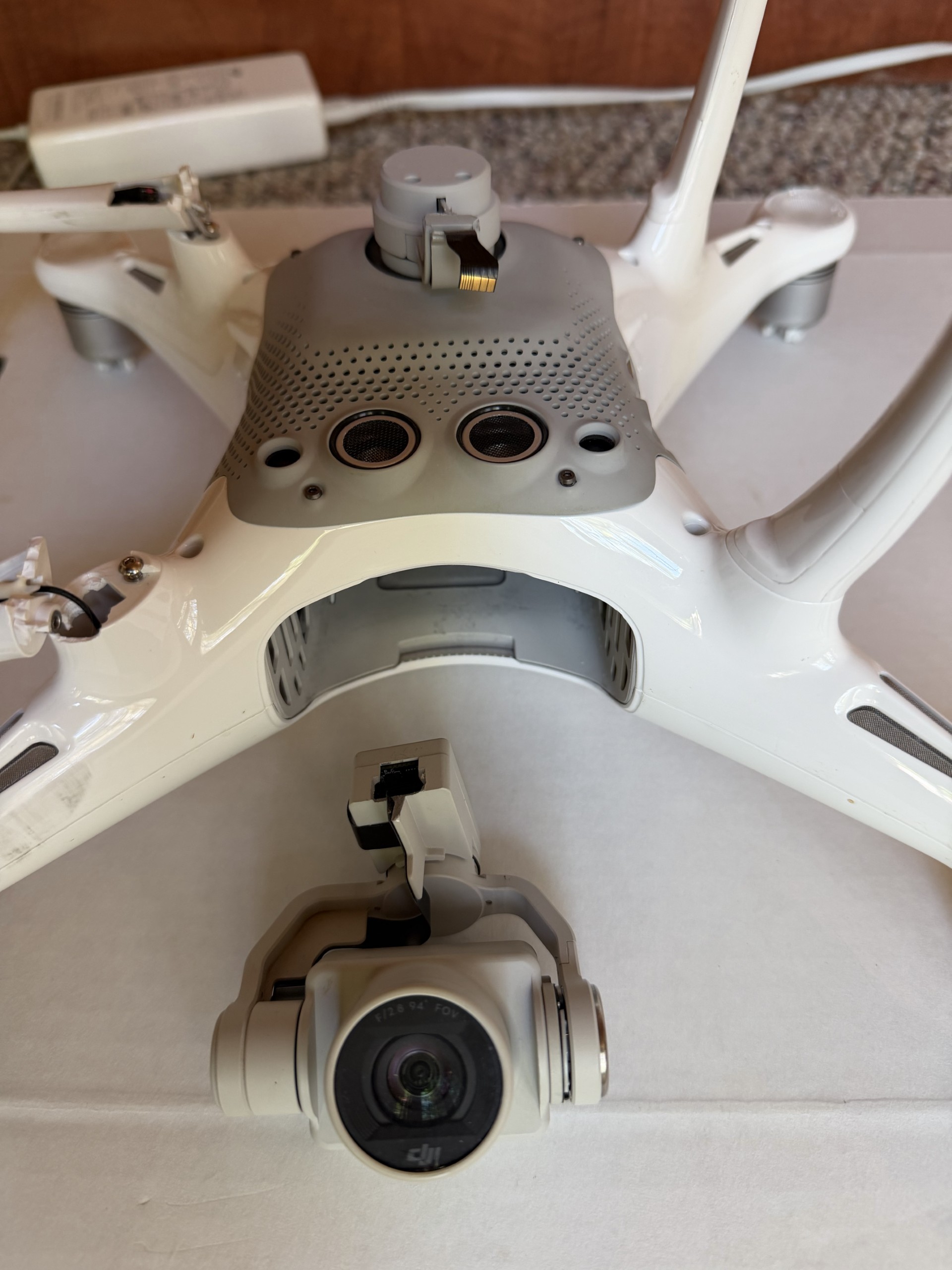

I have a DJI Phantom 4 with a detached camera - is it fixable/usable?
Reactions: RodPad
I get that question a lot. It is very fixable. I have repaired thousands that look just like that. Looks like a Phantom 4 Standard. Needs a cable, yaw arm and probably the yaw motor. I’d be glad to help with that
Much thanks for all the replies. Regrading "I'd be glad to help" can you provide more info on how to go about determining if the camera works on this drone? I look forward to your kind reply.
