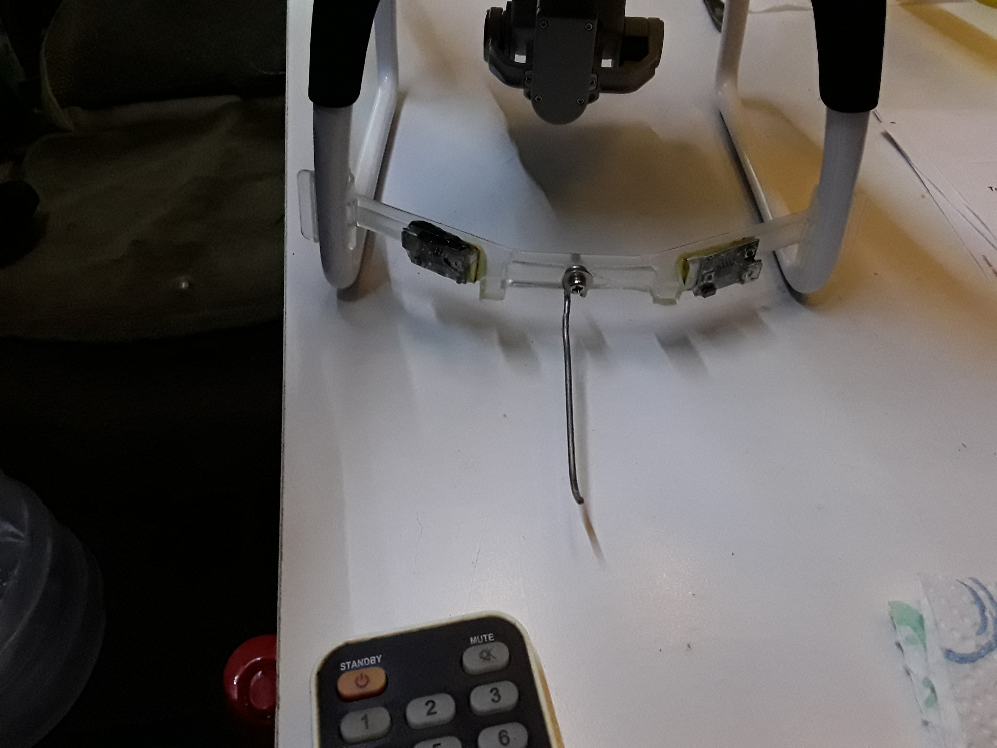

I made this cheap device for taking line from surfcaster for fishing,can drop water balloons too but all must be done in sport mode so you got power there,gps mode makes drone work bit hard ,,,this set up works from adding drag on fishing reel which cause line clip to slide off with out issues,,a simple reverse and stop slides balloons off back,but as above watch what you drop cause anything hurts from height,,,you can get proper release dropper but you not mention what you flying
