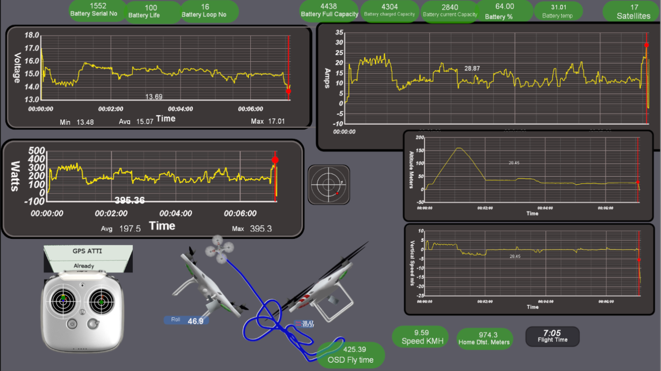

Looking at the txt log in Dashware you can see a sudden jump in amps and decrease in voltage at end of flight. This can happen when you apply full throttle which will increase altitude but you don't see that in the graphs.
So could mean you hit something.
@Luap thx for watching my flight. Than maybe I got hit, I do not know anymore. I do remember that when I started to tumble I gave full throttle. The prop could not be broken because that day I flew with carbon fibre reinforced props. Maybe the motor got ripped out. There were some cracks visible. I dont now, but what I do now is that tommorrow a brand new Phantom is being deliverd. And that I can fly again. Prices for the phantom went down on the right time. Thx again @Luap for checking my flight.

Wow. Sorry you lost the aircraft. The compass seemed to go crazy at the crash area.
