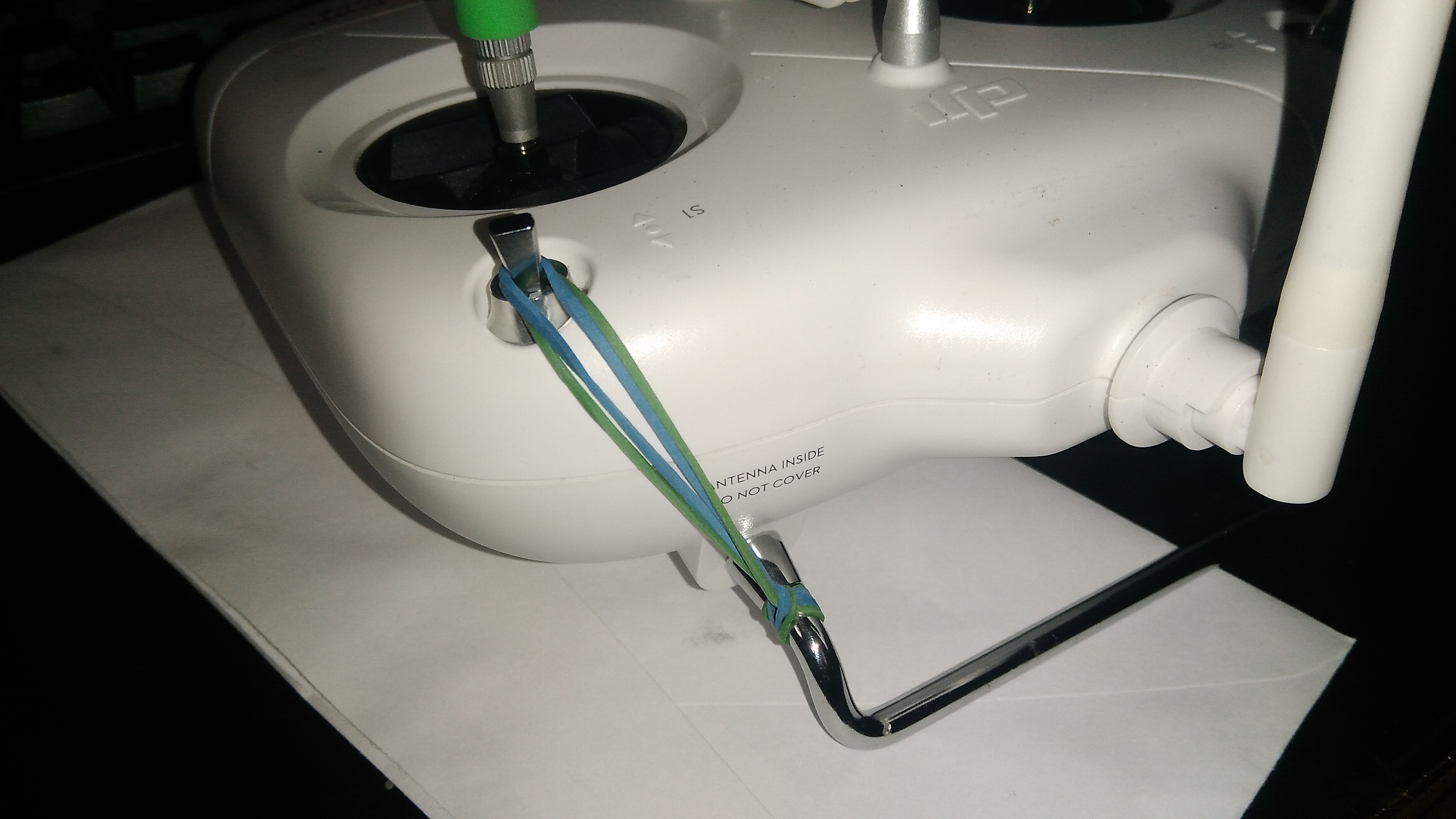

One time i had a very scary flight all of a sudden....Things had changed then drastically for my drone flight i checked and found out my finger had hit the Gps / Atti mode switch and i was NOT in GPS mode No More !...So i added a few rubber bands to the switch to prevent it happening again and it is easy to remove if i need to !
I don't care who ya are that's funny right there
