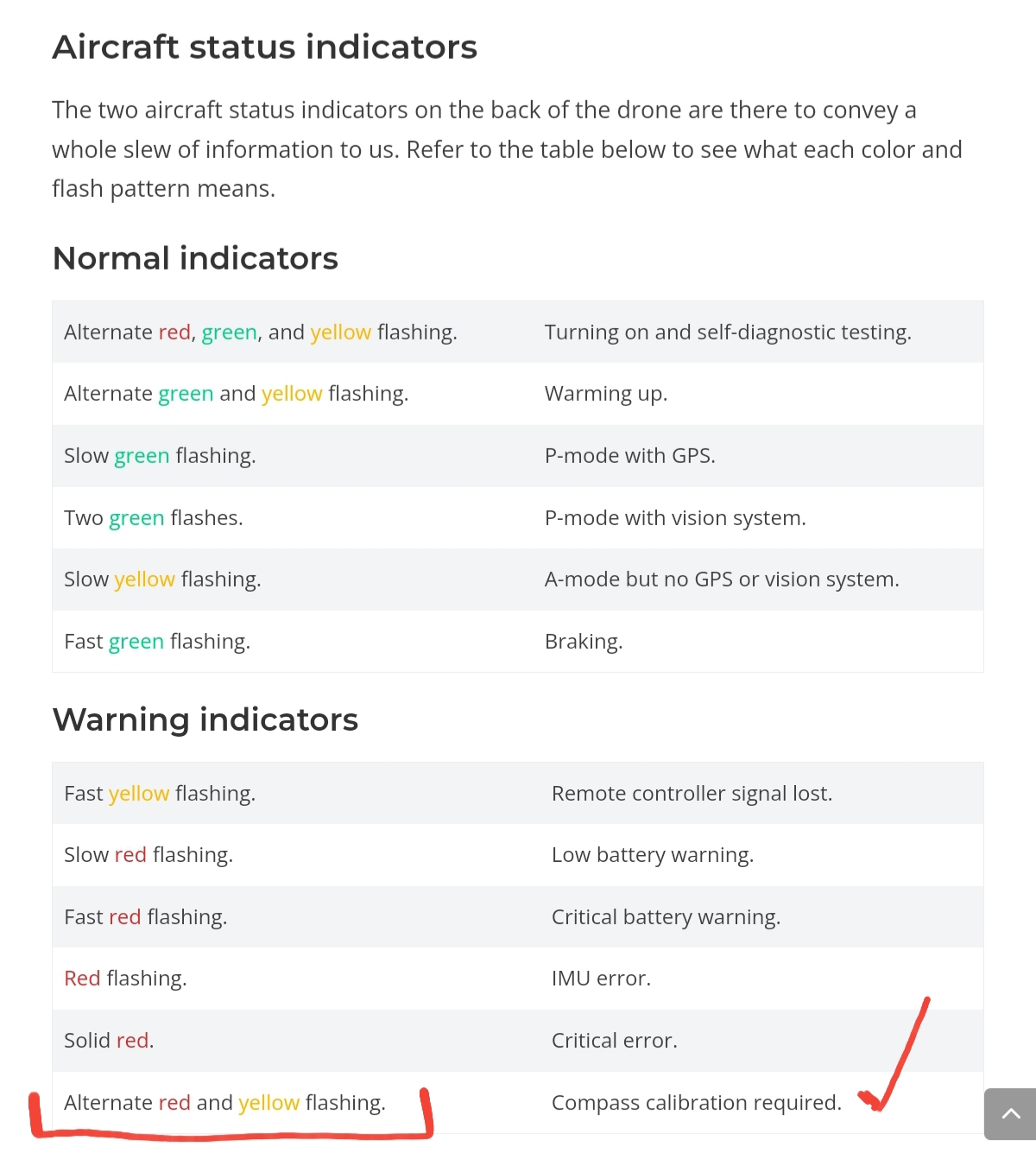

OK p4p light chart
Your previous post #9 says " red and yellow flashing "
Red and yellow flash on this chart says - calibrate compass- hope this helps

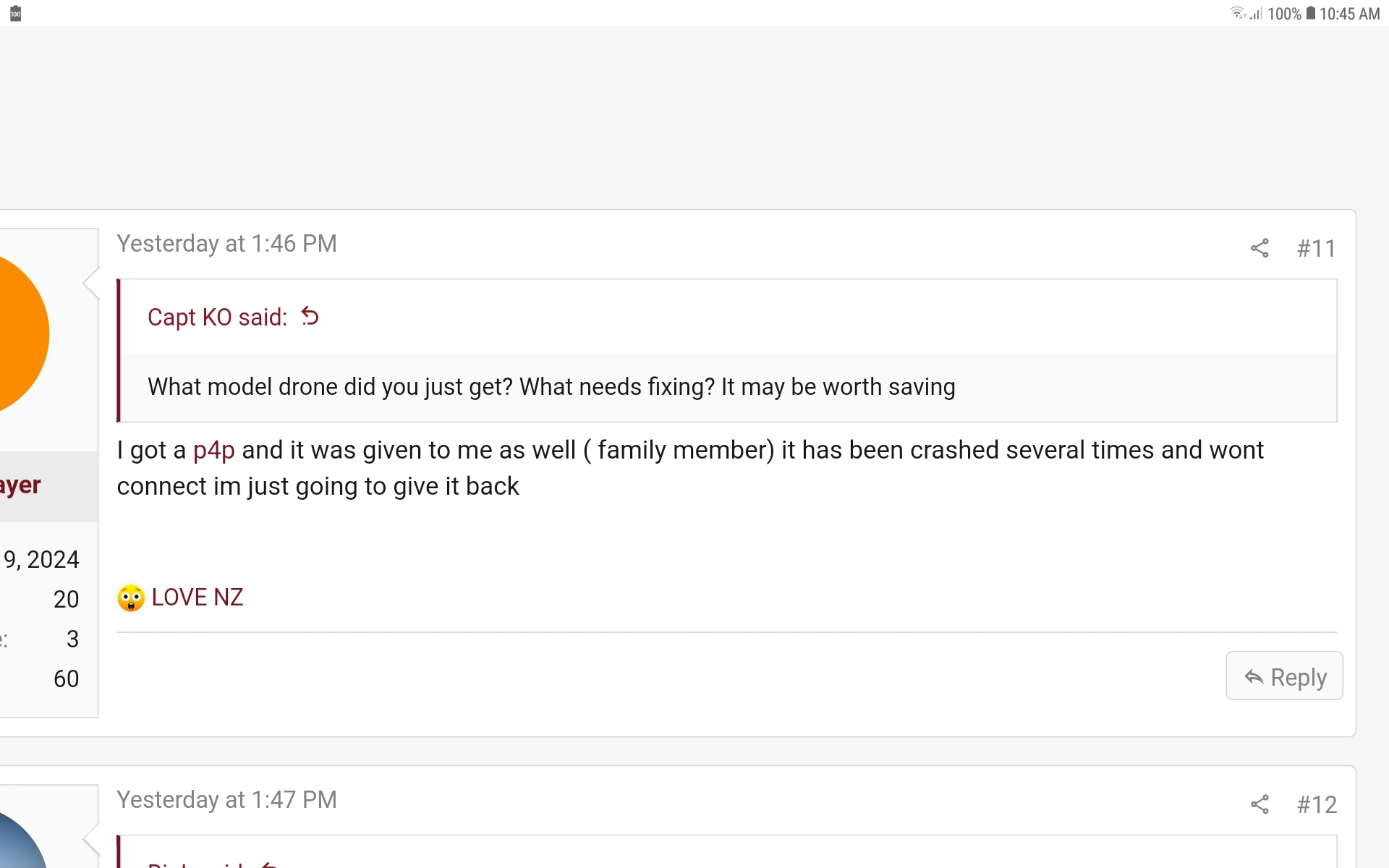

This info that you say in another thread that it's been crashed several times is crucial information in this thread ,if I knew it geen crashed 7 times my reply would have been different
Not mind readers here and to try fix anything whomever needs all info
Otherwise waste of time anyone here trying to help,
Ps,,I couident watch your clip,and still cant

"This info that you say in another thread that it's been crashed several times is crucial information in this thread ,if I knew it geen crashed 7 times my reply would have been different"
Would be nice if you shared the other threads.
In his defense he joined Saturday. :rolleyes:
Rod ..
Ah yeh it was from " 2 Phantom to give away " post #11 yesterday,
Much be cold cause I cant post the thread but here screenshot
I didnt mean no disrespect to the OP but it was never mentioned in this thread ,could be part cause of its issue and seems overlooked,dont know what previous owner tryed either. Just saying it wont connect is easy ,always 2 parts to every story and this is a where to start one,
