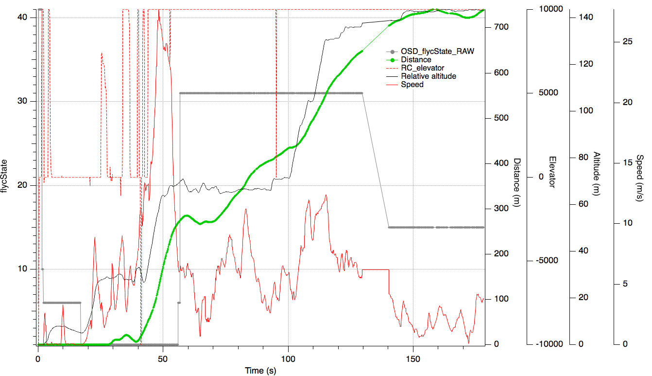

I'm a bit late on this problem, and the results are not likely to help much. The issue was the wind aloft, as noted by others. The first part of the flight does allow an estimate of wind speed and direction at the final elevation:
The aircraft was in ATTI mode from 17 to 56 seconds, but that wasn't relevant to the outcome. The most useful period was between 129 and 140 seconds when the link was lost. The aircraft entered RTH and the rate of drift gives a reasonable estimate how fast the aircraft drifted at 140 m AGL in RTH. That yields 5.3 m/s on a heading of 49°.

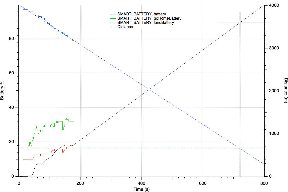

Looking at the rate of battery depletion relative to the smart battery autoland level shows the following:

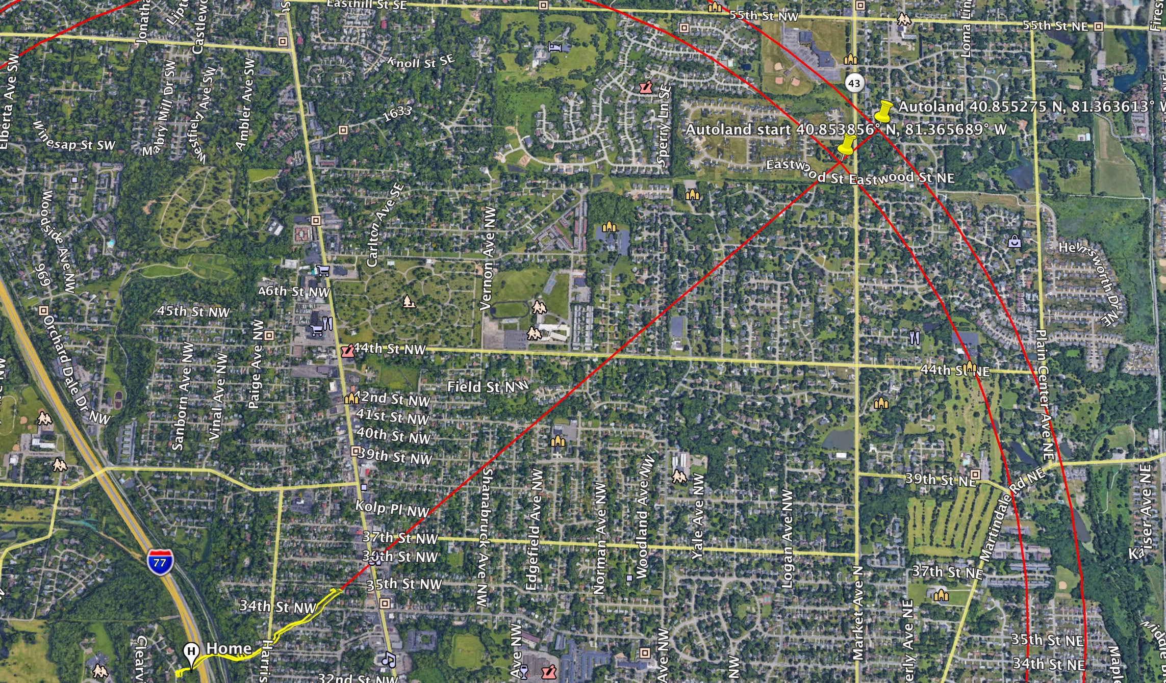

That suggests that after the final disconnect, the aircraft will have drifted until flight time 722 seconds, at which time it will commence autoland at a distance of around 3600 m, or 2860 m from its last known location. From 140 m altitude it will have taken another 45 seconds to descend, and could have travelled another 230 m.
Plotting those on Google Earth gives:
There is considerable uncertainty in that estimate, of course, and it is hard to quantify errors with such an extrapolation, but may give some idea where it might have ended up.
