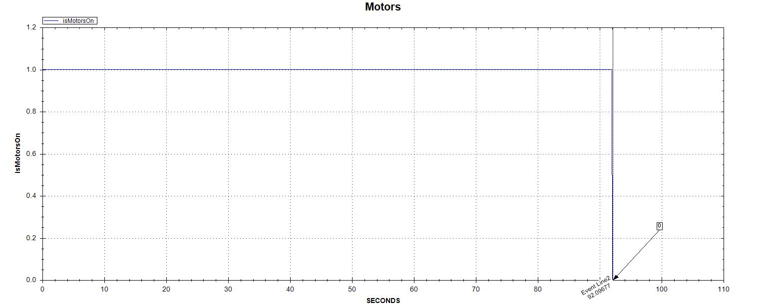

Crash while using Litchi
According to the data, the motors were on until 92 Seconds. That does not mean however that they were spinning. Would need the .dat file from the AC to see that.
Yes battery was fine. After crash powered down then back up with no problems.
Phantom was still powered on?

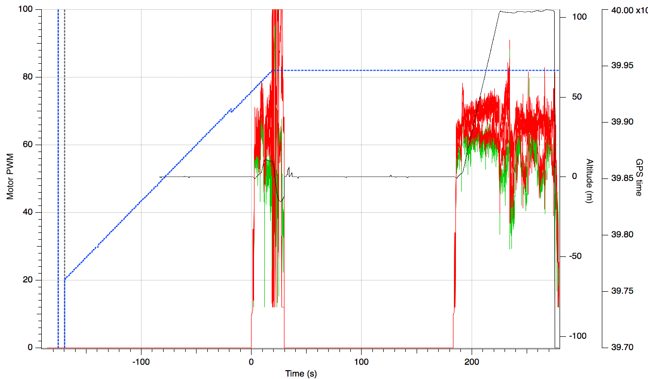

The log file reads like a really bad nightmare. I cannot untangle the series of events but, if you consider the entire power up, which was more than one motor start and takeoff, things started to go bad very early on. At 18 s (during the first flight) the GPS stops reporting with an update rate error. The GPS time and location never changes after that, even though the IMU apparently continues to try to update position. At 273 s, during the second flight, the IMU stops reporting position and at 275 s all IMU reporting seems to end.

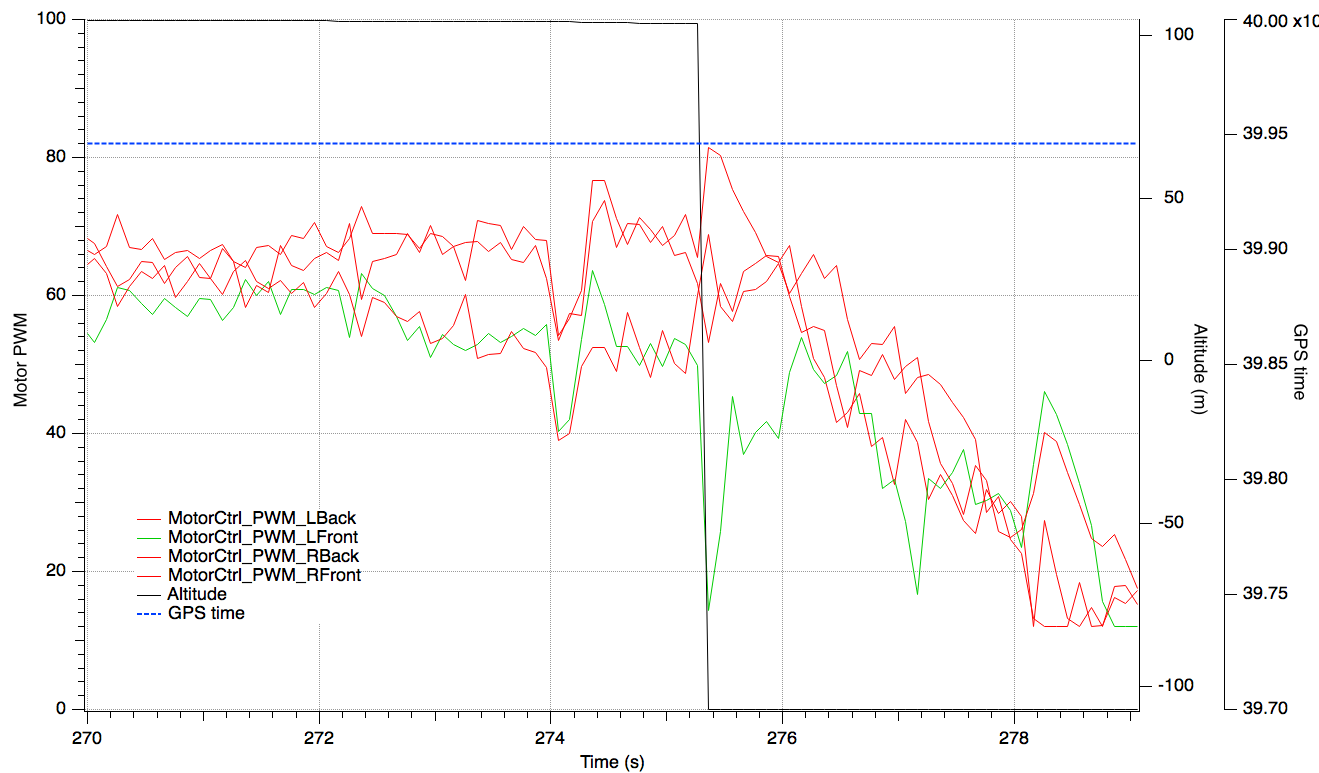

Looking at the end of the data stream shows the motor behavior. The motors simply spool down when the IMU quits, resulting in an uncontrolled descent with the motors idling.
I've never seen anything quite like that - the IMU operating system looks like it simply froze. The final log status entries make sad reading. The final line is particularly potent.

So look like IMU problem?
Yeah, this is a strange one. I can add some more but it doesn't get us any closer to knowing what happened. At 275 secs the smoothed barometer data stopped being computed but the raw barometer data continued being logged (as was the accelZ data). It's like the FC decided to quit computing the smooth barometer values but nothing was said about this in the eventLog stream.
Notice the high negative accelZ about 10 secs later. Probably due to the impact when it hit those brambles.
