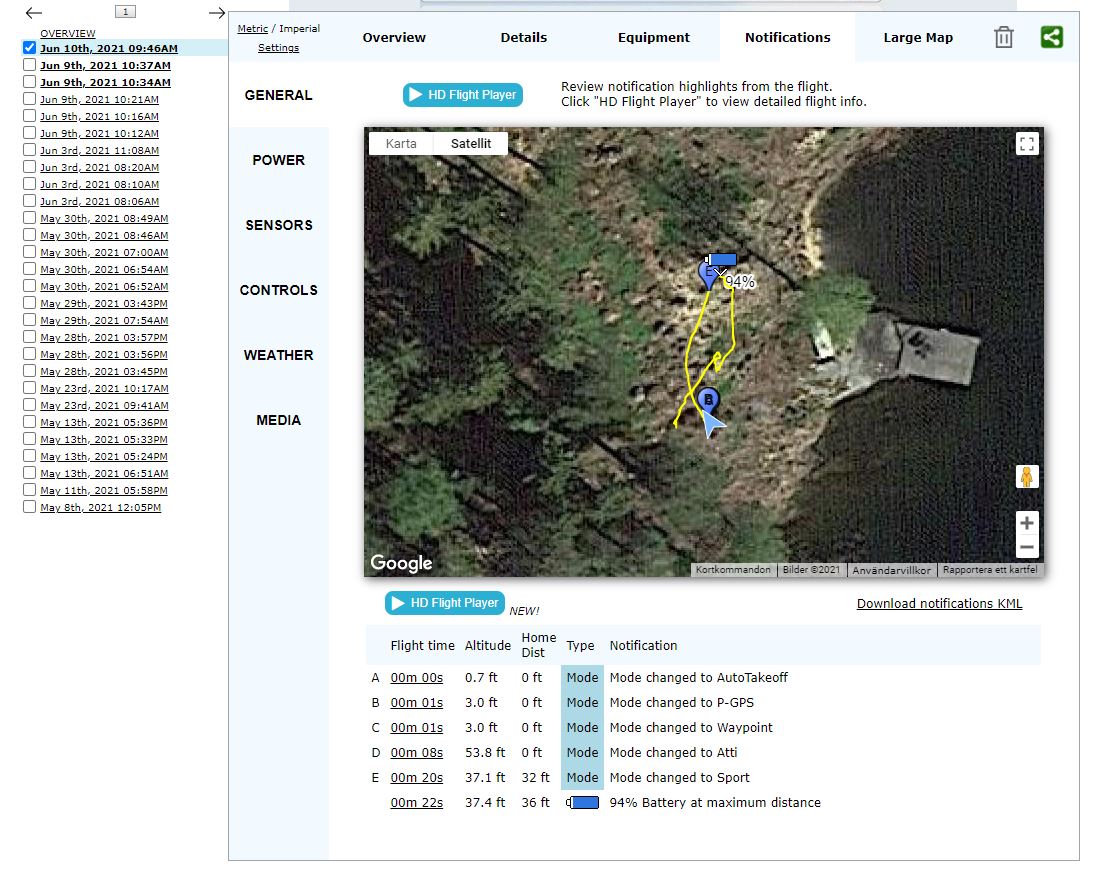

I have studied (or at least tried to) the flight log on Airdata. As you can see from images below, the flight was not as intended.
View attachment 122350View attachment 122351

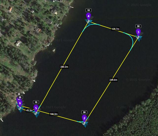

- Since camera was pointing towards the shore during entire mission, this time I placed the drone with the back towards WP #1. Could that be an explanation?

Attaching images again which hopefully will answer your questions.

Your drone's GPS Health never changed from 0/5. (hence the weak GPS message)
It needs to be 4 or 5 before the flight controller accepts the data.
Your drone never went into GPS mode and never recorded a home point.
So it had no horizontal position holding and was never ready to start the mission.
Before launching for a waypoint mission, it is essential that you wait for the app to advise that the home point is recorded and the drone is in P-GPS mode.

I looked into the actual data, which you can see by clicking the CSV link under the map in teh Airdata overview page.
It has two columns for GPS number of sats and GPS Level, which is an indication of the flight controller's assessment of GPS data quality
I can't say why it indicates the drone went to P-GPS.
It's a false indication as the GPS health never went above zero.
It has to be either 4 or 5 before the drone will actually go to P-GPS.
