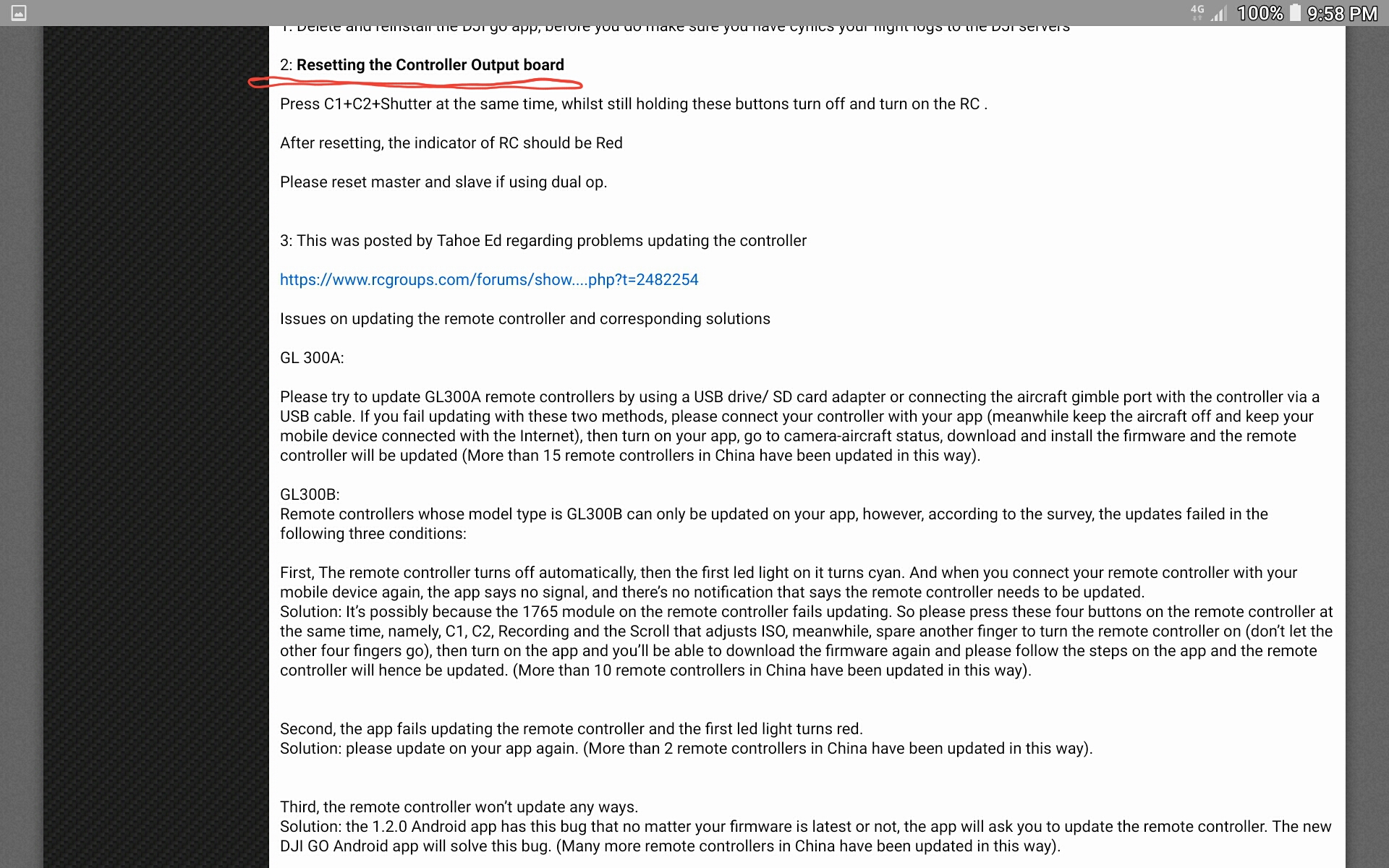

I cant start the motors, but I can control the gimbal. my controller light is alternating red/green. It was a solid green until I reset the controller and relinked. Tried re-linking multiple times....still red/green.
No, nothing autostarts when connected. I have tried with my samsung galaxy s7 and ipad mini4. I cant see anything. My s7 says charging when connected. I tried holding down the 3 bar menu in the upper right for 10sec or so to see if it would show fw version, but it just shows as disconnected
I will give that a shot thanks.
I also have a feeling that part of the issue is a firmware mismatch between controller and aircraft, but without being able to access the app I can see current versions. Also I tried upgrading to current firmware on AC and it failed. Also tried installing 1.3.2 and it failed. Maybe the gimbal board wont allow the update? Im not sure. I’d like to try another gimbal board just for loading fw.
Omg I got lost trying to catch up,,no can still fly with different versions on rc and AC, can enter app view when drone is off ? Read so much can't remember if I saw a try change usb cable post or not,what happens if you turn airplane mode and wifi off and try conect to app? You tryed controller reset ay,

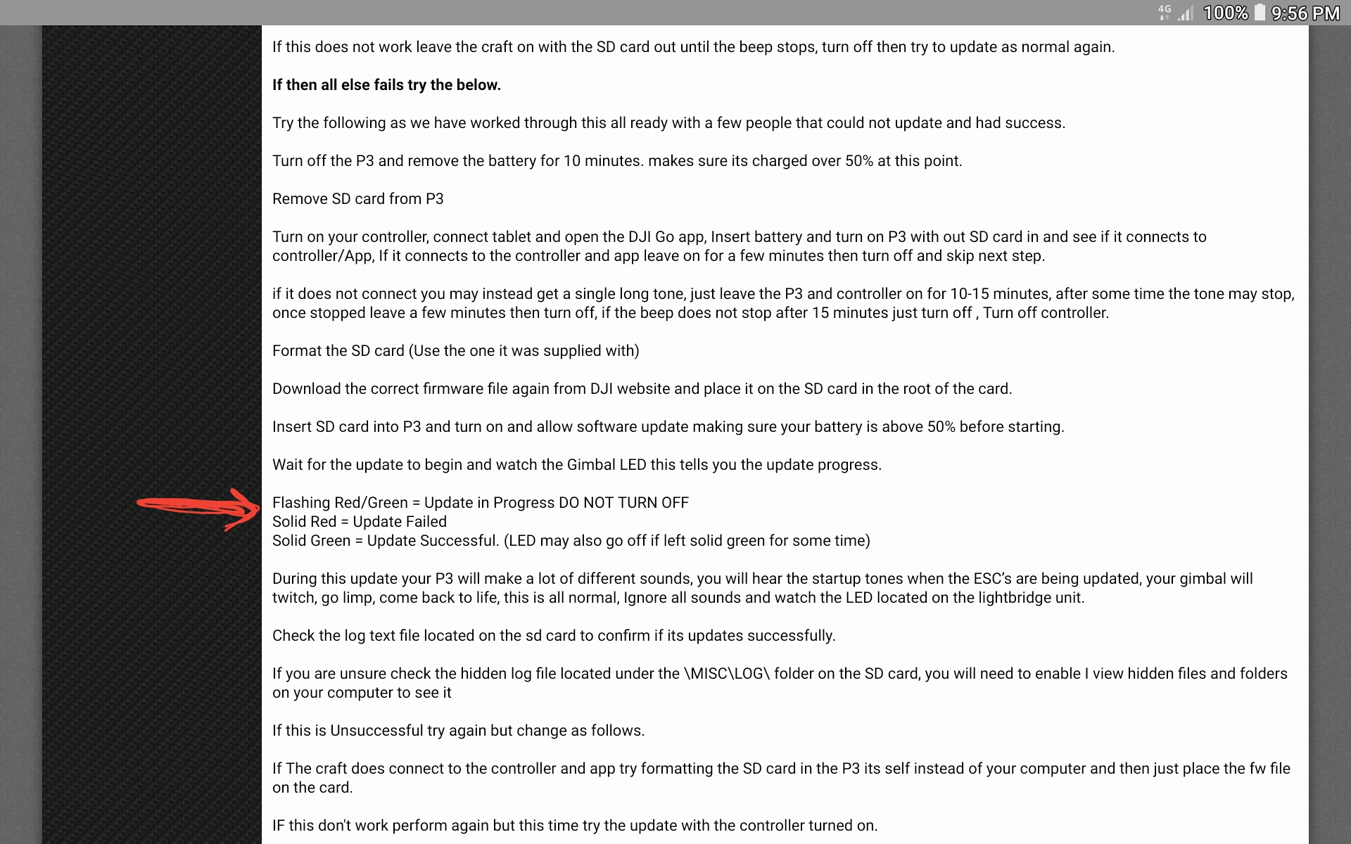

OK found this aswell ,,,red and green flashing here says update in progress
OK found this aswell ,,,red and green flashing here says update in progressView attachment 103515 View attachment 103516
I just tried the reset mentioned in your last post, as well as turning off wifi and airplane mode. Still not connecting.
I can try to swap cables, but I am using cables that came with the iPad and controller so I thought they should be good.
You should try cable ,these can be faulty even new,some new ones I have purchased don't even work,would not hurt to try,after all it uses usb for conection for your device.....unsure but could explain remote behavior
