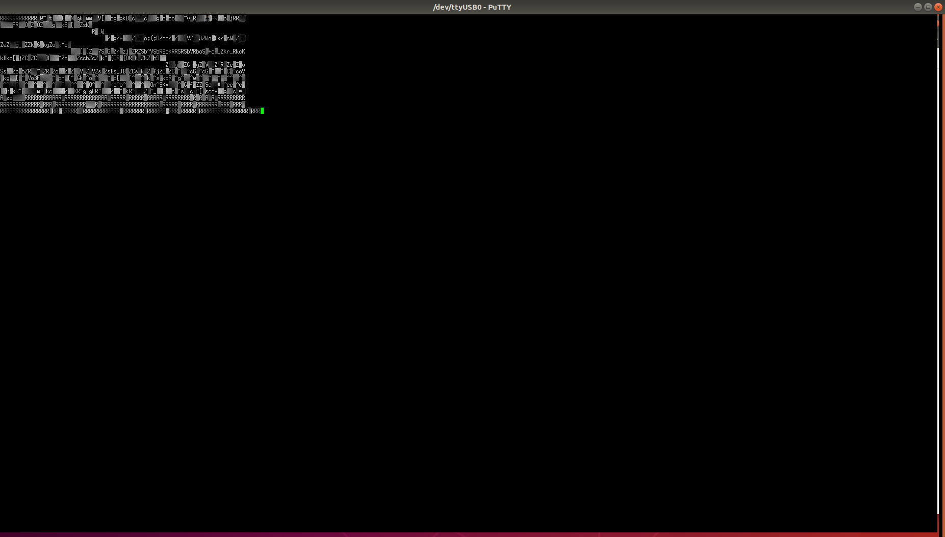

I'm obviously doing something wrong. (See attached)
Is there a way to do this in windows? I am more familiar with the windows OS.
Yes - note I mentioned PuTTY.
The output suggests invalid transmission params. Check them, especially baud rate.
It was the baud rate causing the issues.

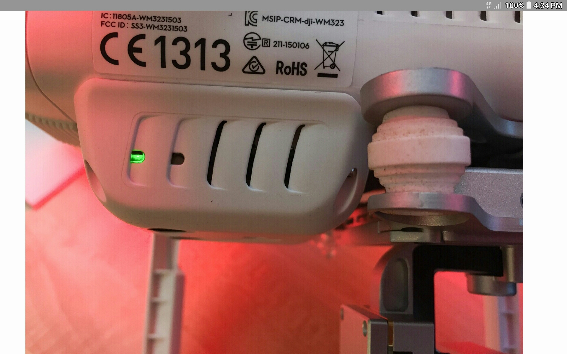

drone lights are 2 solid red, 2 yellow flashing (cant remember if fast or slow, will have to power up in a bit to check)

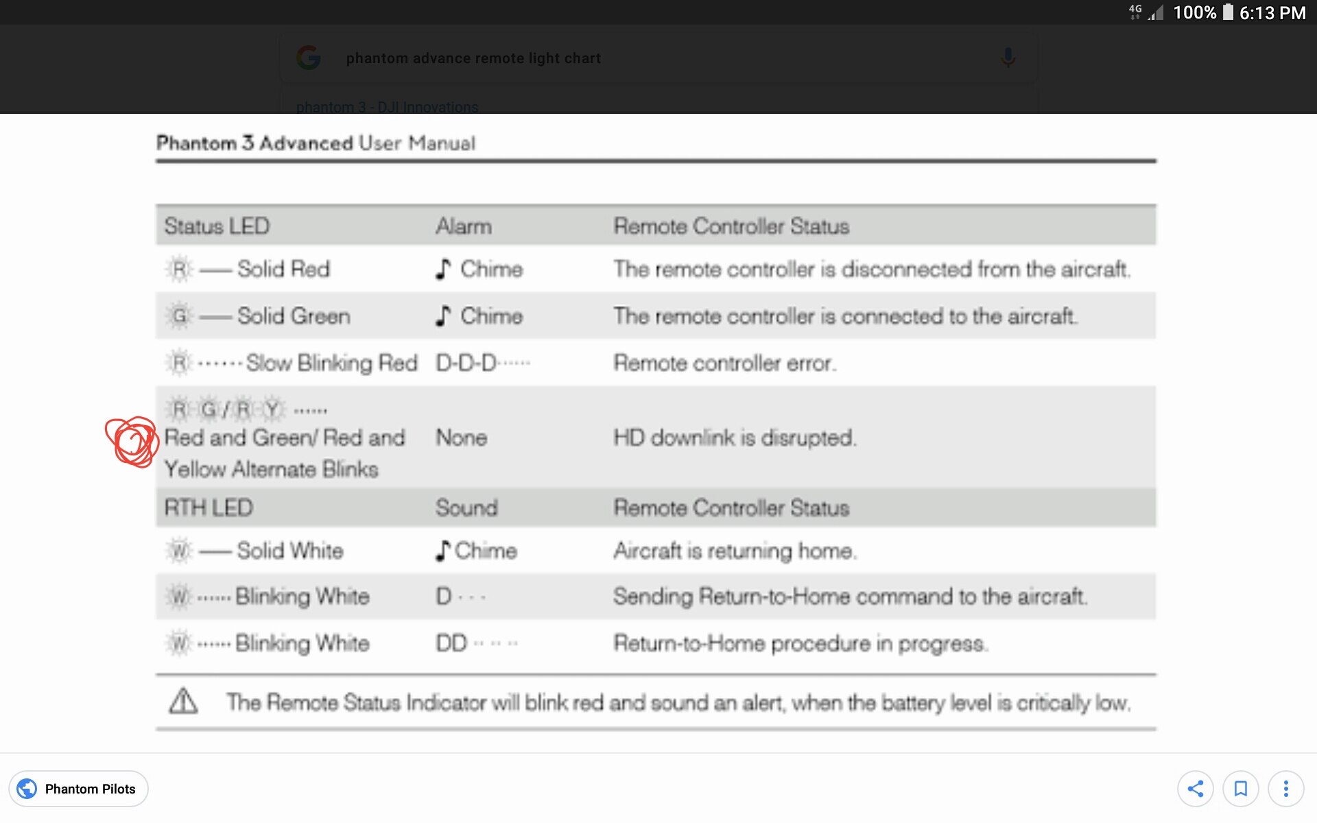

Its strange because when I first got the controller and linked it to the AC, the light was solid green. Then once I realized I couldn’t connect to the app, I reset the controller via C1 + C2 + record button, then clicked the camera wheel once I heard the beep. This turned the light to blinking blue, so I linked the RC and AC again. This is when the alternating red/green began.
Front always solid red unless turn off,what colour gimble light,is link light on drone red or green,,,green if linked red or orange if not,take note of these colours these say what drone is doing
Front always solid red unless turn off,what colour gimble light,is link light on drone red or green,,,green if linked red or orange if not,take note of these colours these say what drone is doingView attachment 103572

OK this light chart says different again,,did you try usb,any difference,,by this chart it say HD downlink disrupted
