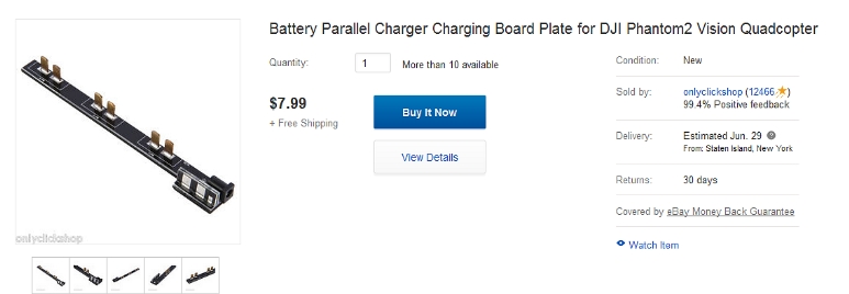

I bought one of these multi-battery charging boards for $8. You can charge 3 batteries with it, and power can be supplied by either the dji power supply, or another source. I had an old cig lighter plug lying around, bought the correct coaxial adapter for the board, and spliced it in. You could also buy alligator clips and connect it directly to the battery terminals, bypassing the lighter socket fuse.
http://www.ebay.com/itm/like/201140559715?lpid=82&chn=ps

looks nice CapnBob. i checked that out although i already bought a charger w/ multi connections to charge 3 P2V+v3.0 LiPo batteries simultaneously.
are you aware of any USB type...or do you think it's possible/easy to connect a usb instead of a cig lighter?
Check these ebay cheap adapters carefully, one I bought had a large solder blob on the battery connector and was slightly thicker than the standard blade - you do not really want to be stretching your battery connections?!?
Absolutely. I do so with everything I buy, and have had to do pre-use fixes and even re-engineering on more than a couple of purchases. The fact is though, it would cost me 4-5 times the purchase price in cash and time to come up with something on my own. It's an economical starting point, but that is all.

Well, you will now be running 3 Li-Po chargers in parallel from another Li-Po charger. Not sure how that will play out. Don't know why you would want to do that.
USB should even not be in the equation. Remember, USB 1.x and 2.0 specifications provide a 5 V supply on a single wire to power connected USB devices. A unit load is defined as 100 mA in USB 2.0, and 150 mA in USB 3.0. A device may draw a maximum of 5 unit loads (500 mA) from a port in USB 2.0; 6 (900 mA) in USB 3.0.
In any case, I would run it directly from the battery if possible, so as to bypass any inline fuses. A 5400MAH 3S pack can draw 5.4+ amps while charging. 3 could draw 16.2+ amps.
