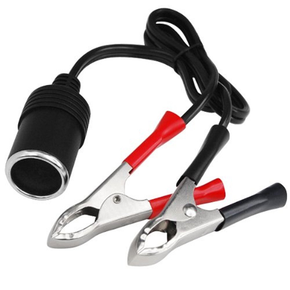

You could get adapter leads for croc clips to cig lighter socket (see photo from UK Amazon) and then just use the proper DJI charger (C4S90-4)?
Not sure I'd really want to use anything non-DJI on a battery that costs £170!
Honestly, if I were going to go this route, I would simply cut the cigarette lighter bullet off the end and install a pair of clips. I may still do this. I was hoping there was a more eloquent solution already out there, used, and tested by the aerial community. Still hoping I don't have to build one....

OK, FWIW I use the DJI unit when driving (engine stop-start tech seems to upset it) but often hook it up to my camper leisure battery using an adapter similar to above. As far as I know there is a fuse built in to the DJI unit in the cig plug.
