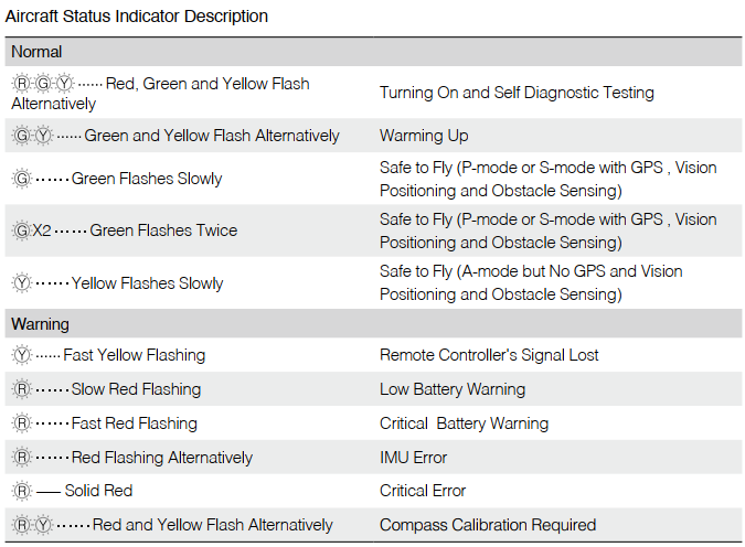

Quick question, I know this thread is kinda old. So when you linked the Gl658 to the P4, does the lights on the bird and RC turn green?
I somehow managed to get them linked, light on the controller is green but the light on the bird blinks red. The app shows I'm connected, I get image on my phone, bird starts and flies but the blinking red light bothers me a bit. I do get gps lock and the go fly message
I have a GL658A if that means anything.
Sorry, I didn't clarify my question better.
The red light I'm referring to is the bind light, next to the sd card slot.
