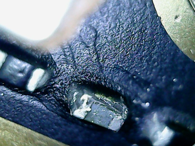

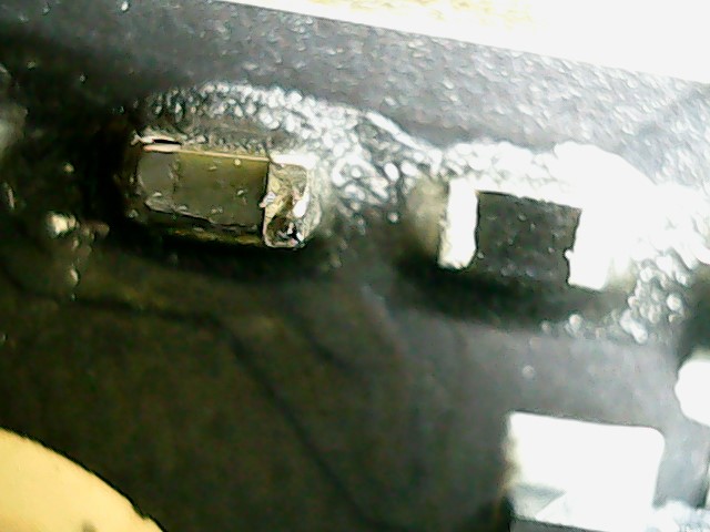

I have found what was the problem.
I used screw with wrong lenght on clip which is securing flex cable from mainboard to camera. Which was fatal for capacitor under the heatsing. :eek:o_O
after replacing it everything works as before.
its located right under the hole for the screw in heatsing ... near cam conector.
