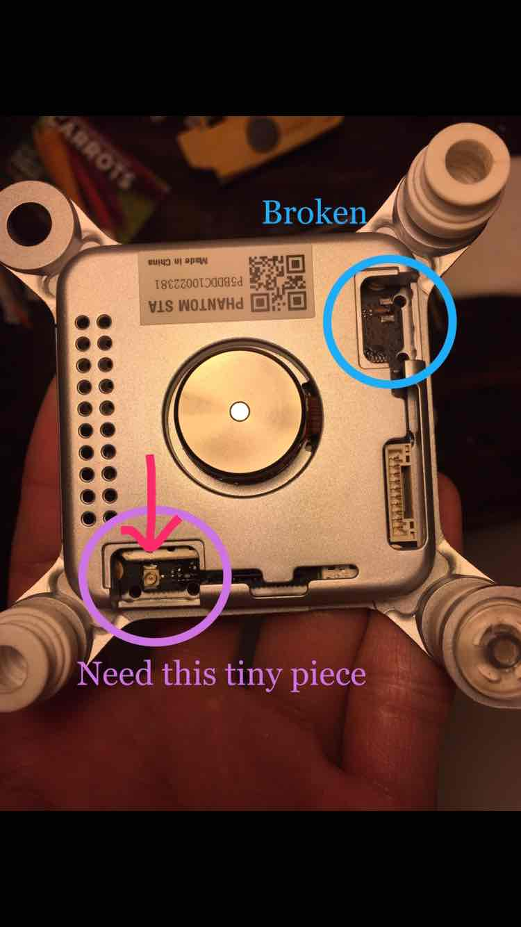

My camera started having an intermittent issue on my last flight the other day.
Noticed the black wire, that runs from bottom of drone to the camera/gimbal, had more slack in it than usual. Took the anti-drop pins off, un-clipped the flat/ grey wire, then took the cover off from where the black wire enters/exits.
The black wire was not connected to anything. It has a push-type connector, but the "nub" the connector snaps onto, is missing.
How can this be fixed, without boxing the complete drone up and sending it out to be fixed. Can solder be used?? The contact is still there, but not enough left to clip the wire to.
Any suggestions would be greatly appreciated. H.P.

Thanks msinger. Looking at your link, the issue with mine is, in your pic, the black wire with the brass/copper end, is were I've got the issue. That end connects to the top of the camera/gimbal mount, inside a cover on the electronic board of the camera assy.. From what I can tell, the antenna is in the drone body/fuselage and it works as should. The spot, on the board, were the wire connects to, d/n have much contact area for that copper/brass connector, to connect/push on to. It looks to me, like that area has eroded away and has not left me much to make a solid connection to. That's why I asked about solder or some liquid type of solder, to secure it to the contact point.

Thanks! But, that's not my issue. Not trying to be a pita, but, it's those antenna wires that connect into the main body of the camera. There's a circuit board, that those wires connect to, in the top motor(?) assy. of the camera itself.
The "nub" on the board itself, has eroded away and the wire just barley attaches, but, not enough to were the connector will stay on, even with the little access cover in place. That's my issue. Thanks again! H.P.
ETA: here's a pic.
So, the connector on the end of the black cable isn't damaged? If that's the case, then you'll need to replace that board -- unless you can find someone who has the skills to repair it.

It appears you'd be correct on this. I just found an old thread on here, and that was what was recommended. Again thanks for the help on this. H.P.
Update: Well, took the plunge and purchased a cheap Soldering Iron.
With unsteady hands (old ya know and why I was hoping for an easier/cheaper fix), soldered the connector to the board. Put it all back together, installed a battery., fired up the controller, let the bird warm-up and low and behold, got video, camera yawed side to side (small amount, as normal), and up and down.

Update #2: Wx cooperated today. Flew a couple of batt. worth of flight time and had no issues. Held alt. & pos., camera rotated up/down, recorded video and took stills. Sooooo, my shaky/old hands were able to still do the job, just like my younger days.
Looks like I dodged a bullet and didn't have to spend $300-$400 bucks on another camera (couldn't find a board) and didn't have to sell it on Ebay or some crap, as a parts drone. So, there's that.
