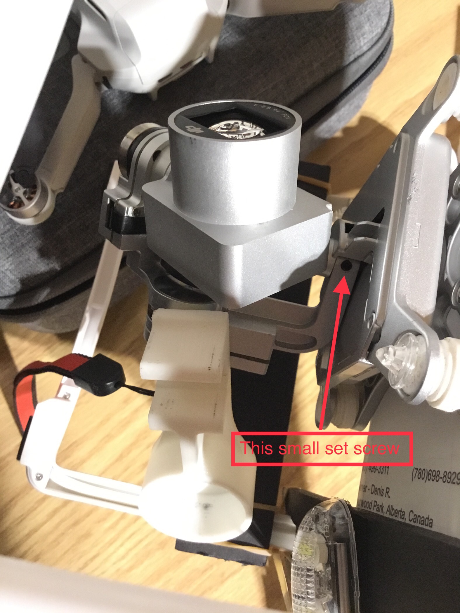

Hi Rootman. If it’s that bit of jello effect in the video you are trying to resolve, check the attached picture. That set screw on mine became slightly loose and I had intermittent jello effect. Once I tightened it, all was good again.
Hope this is your issue as well, cause it’s an easy fix.

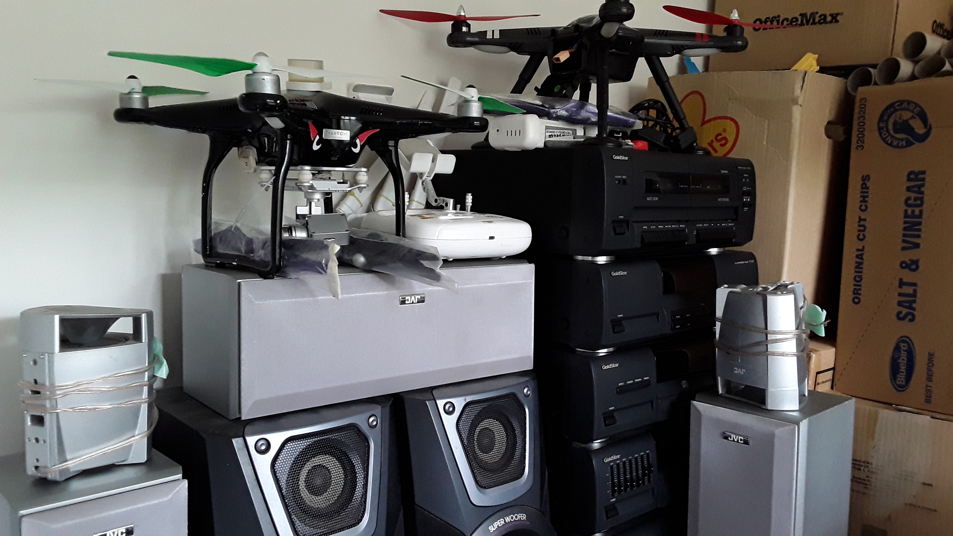

Omg ha yip laughing at meself. I blame medication lol,,views sure looked great but didn't even notice the waves till I watch it back,,I know,,I did also think the title "waves" was you on the ground somewhere waving at the p3,,even after reading I still assumed it was just a flight to get the dust off and without issue,,I need to stop taking something lol,,well you got 3 of each so one must work,,,very good luck,I've been lucky on that side of things,,,yes me p3s just sits at me brothers house with some my stuff,its old faithfull and goes all the time and batterys always charged,keeps the detect x380 company,,good luck with the p3,I'm sure you'll sort it,,;)
I definitely will check that out first. I need all the help I can get. Lol. Thanks for the tip.
Omg ha yip laughing at meself. I blame medication lol,,views sure looked great but didn't even notice the waves till I watch it back,,I know,,I did also think the title "waves" was you on the ground somewhere waving at the p3,,even after reading I still assumed it was just a flight to get the dust off and without issue,,I need to stop taking something lol,,well you got 3 of each so one must work,,,very good luck,I've been lucky on that side of things,,,yes me p3s just sits at me brothers house with some my stuff,its old faithfull and goes all the time and batterys always charged,keeps the detect x380 company,,good luck with the p3,I'm sure you'll sort it,,;)View attachment 121777
