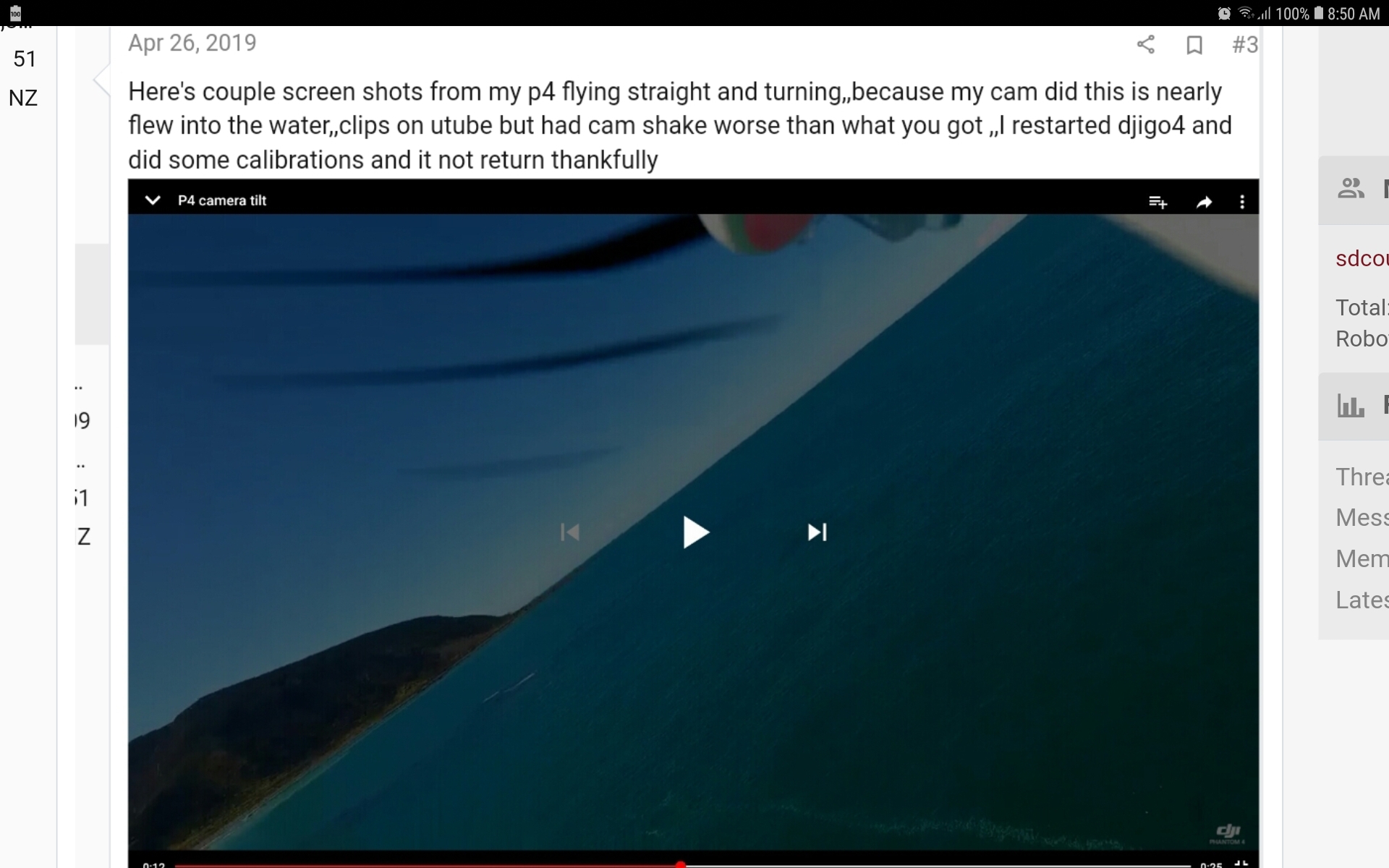

Yip had that before and lots have ,screenshot of previous thread ,,search cam tilt with search logo and some threads come up,,,ones below happen with no wind,,hopefully you dont get yo experience the limp gimble in flight,,that gives impression of free falling,,I've had both and scary moments at first....cant do nothing to avoid it ,calibration can help but they just fo it from time to time
