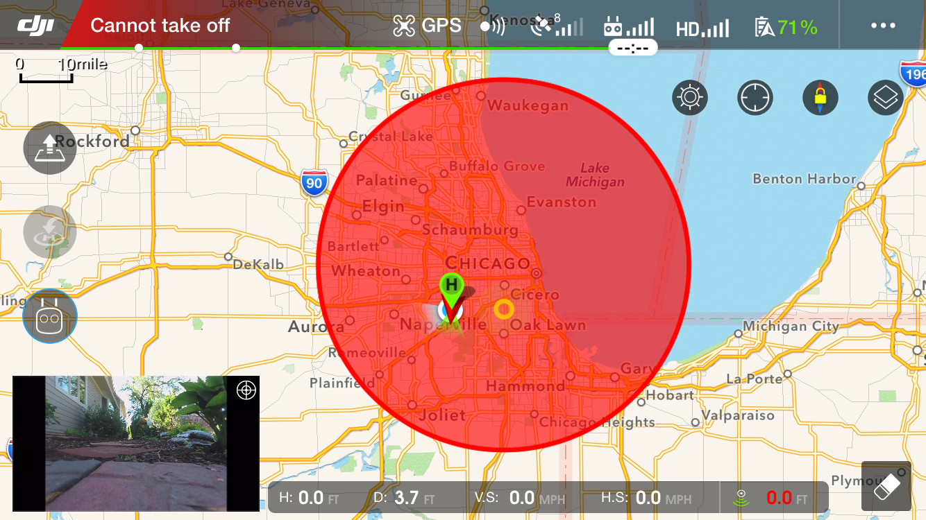

Hi need help, I use meu Phantom 4 to work and today have a work in airport and have the the msg No Fly Zone. Need help, what is possible to do to unlock this?
Is that with GEO "on" or "off"?
The NFZ may be smaller, or even gone, with GEO turned on.
Otherwise, you may need a tin hat over the top, to block GPS reception, and need to fly without GPS, and fly using VPS and ATTI only. Unlocking NFZ's through DJI can take weeks, especially during Chinese holidays. Good luck!

Hi this is a big problem to me, part of my work is in no fly zones, I work with Airport construtores, if i need to check a Light / radio tower etc, I cant do the Job
Got to agree with gadget guy. Make it a one time software switch (a log on) that you enter your license or authorization code ONCE when you turn on the machine, if you want to protect the system from idiots who think it's cool to endanger lives or break laws but don't allow just anyone to interfere..... yes interfere..... with your national sovereignty. Sovereignty isn't just border control its freedom to act according to your own laws.

Unfortunately, that slider will soon be disappearing. DJI has made it very clear that GEO is temporarily optional, and will be made mandatory, once they are satisfied with it. Get your feedback in now, while you still have a voice! Their version of its implementation will be much harder to change later on!
as a company we perform aerial survey and photogrammetry. Some of our work has to do with airport infrastructure.
As other has explained, you can get DJI to unlock a restricted zone, for a given radius and a given period. There are however two problems.
You need to unblock the controller every time you want to take off, thus you need a constant internet connection. Not a huge problem but annoying
The unlock system does just work for manual flight. NOT using any intelligent mode. The big problem is, all software for photogrammetry -Altizure, Mapsmademagic, and all others- command the drone using the intelligent mode commands.
Which means that yes you can fly but no you can't work.
Reiterated contact with DJI brought as a result:
"Sorry for the inconvenience caused accordingly and your understanding is highly appreciated."
This means either buy another drone of find somebody able to hack the system, finding the file containing the coordinates of the restricted zones in the soft of the controller and edit it.

Interesting that you posted this today. I just came back from an adventure where I A L M O S T left drone, remote and phone on the side of the road blinking away.
I usually just fly around my house and subdivision, but wanted to go to the country and try out a range booster reflector. I drove out 20 miles into the farm land and stopped on the side of the road and prepped to fly. After warm up the bird would not start and in DJI Go I got a "The GEO System has detected 2 nearby Authorization Zones....blah blah...
So I looked around and saw a Fire tower and blamed it on that and went about 5 miles on down the road. Next stop same message. Grrrr and nothing but tomato plantations. % more miles, now I am by my odometer, 35 miles from city limits where I set the trip odometer. This time I say Yes I want to unlock the areas and fly, type in my user name and password and DJI tells me there is no network available.
I walked around the car a couple times with the urge to just get in, fire it up and come home and hope somebody can get a couple bucks for the worthless drone they found.
I eventually literally threw all that sh** into the trunk and came home. I am becoming less than enthused about this little hobby. I was suspicious to begin with of anything that is supposed to be fun that makes almost no noise and does not have spark plugs. My initial qualms are beginning to look pretty good.

Turn GEO to Off in DJI GO. Problem solved, for now, until they make it mandatory, and remove that option.:cool:
Reactions: Rich M
May the Lord bless you my Son. :) I could not find where to turn it off, but I was out in the sun and couldn't half see my phone. I will find it before daybreak. Thanks a gazillion. I got the impression today that it was not opional, but something was wrong.
Thanks Again.
