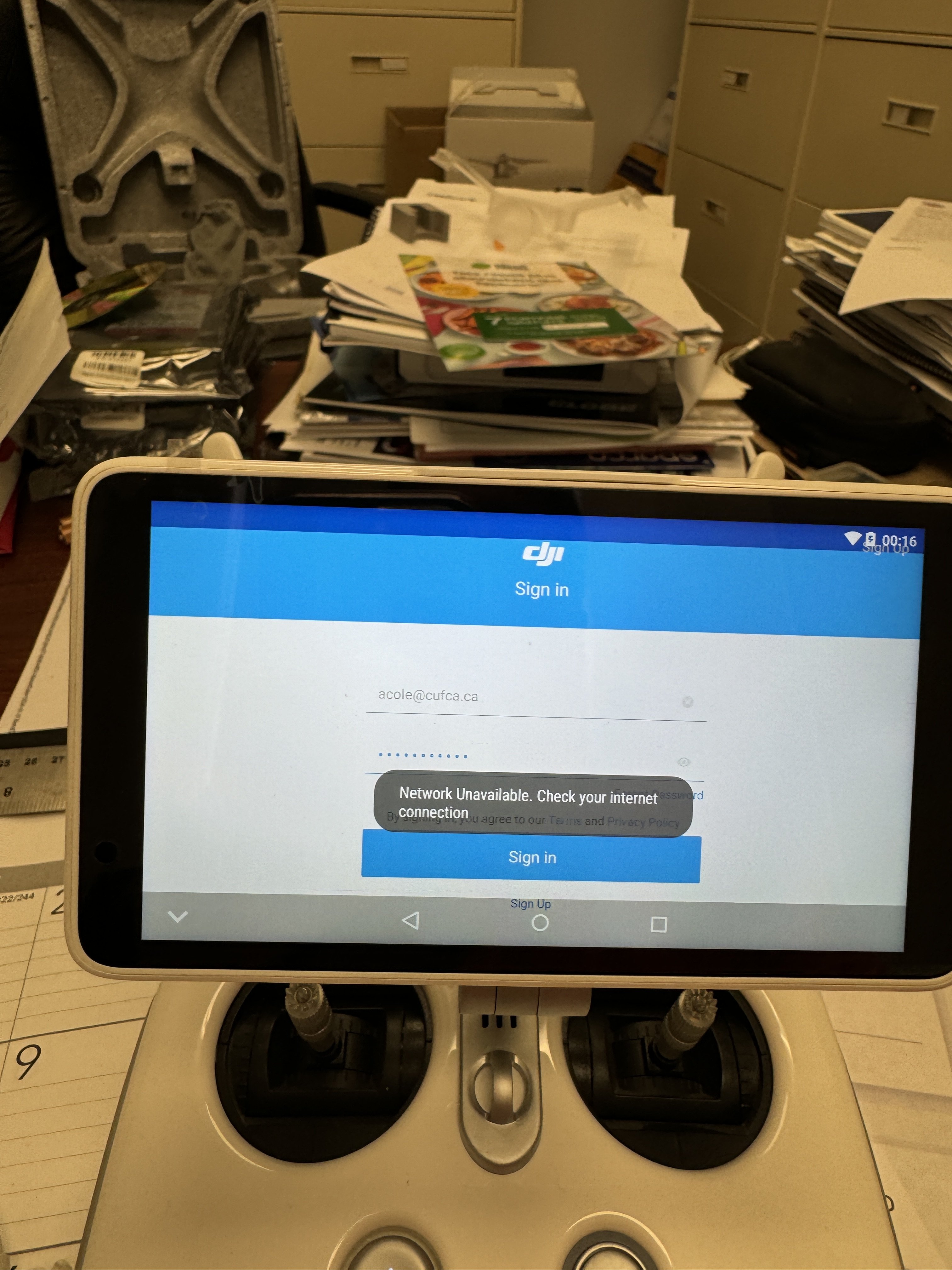

Thanks for the add. I am a new member with a problem with an older unit. I have a Phantom 4PRO+ that I have not used in years. One of those buys for a specific project then no other needs came up. Trying to dust it off and use it again, tried to power up. At first the screen came up as usual. required the calibration on the gyro. no problem but then went to a sign in screen mode and will not move passed. It is prompting me to login to my DJI account. I put in the email and password and nothing. It says it cannot connect to network. I have made the WIFI connection many times. So now I cannot seem to get passed this screen. Any thoughts? hat to think the unit is a brick. It has had minimal use and while an older bigger unit, I really have no need to upgrade if this can be made functional. I am guessing DJI no longer supports this unit from what I can see on their site.

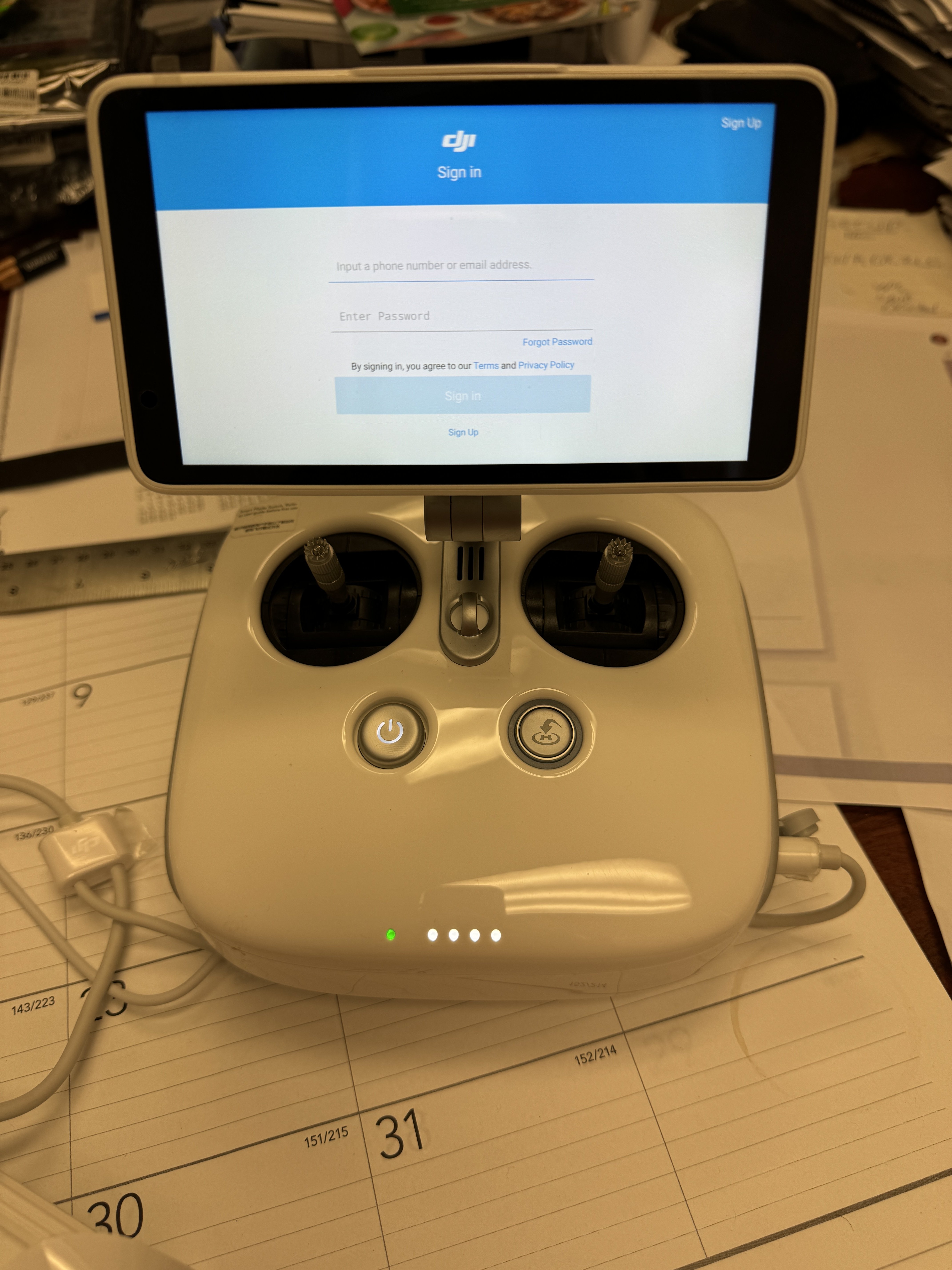

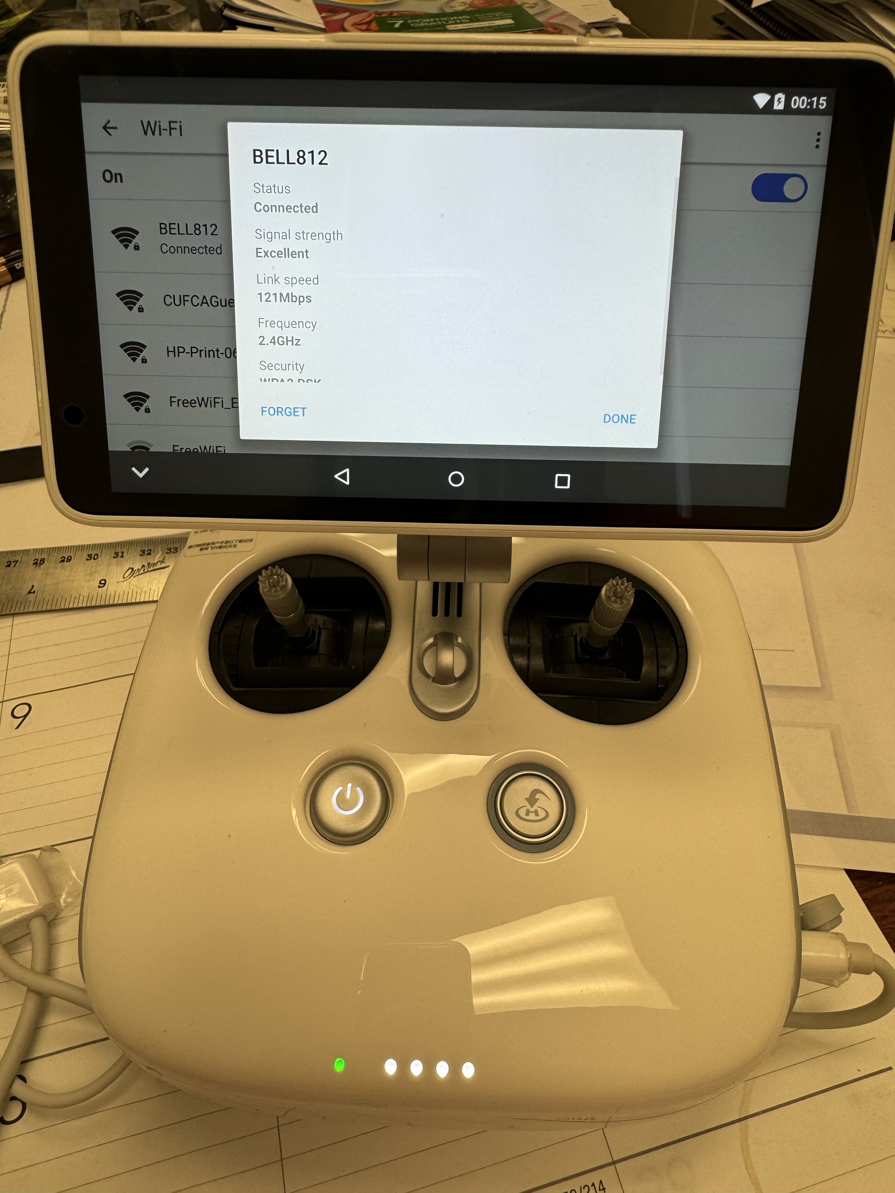

So here is what I am stuck with. Photos attached.

Go into settings and make sure you are connected to your network.
Reactions: RodPad
I see you're connected to the wifi, and assuming that there is internet connection, I wouldn't know what else to suggest other than reaching out to DJI support.
Can you successfully log into your DJI account via a laptop that uses the same WiFi network? If not, your modem may need to be re-booted.

The screen message you are getting says Network unavailable.
That's an indication that you aren't getting through to DJI's server.
It could be an issue at your end or something at DJI's end.
There may be nothing wrong with your drone at all.

May want to pick up a used 300F remote for use with phone or tablet. I use both remotes, your 300E and F, with my P4Ps. Try installing GO4 on a phone or tablet (from DJI downloads) to see if your network can login to DJI on that device. Once logged in, it may open the connection to your built in screen.
It’s been some time since I’ve had the plus style controller in my hands but is there not a check box that shows up after you enter your sign in info that pertains to the
“Terms and Privacy Policy”. Has that box been checked?

Hi A Been there done that. and those and even reset. I bought a used controller. Had mapbox sign in from old owner. My dji sign in kept kicking me out. Had to un install mapbox, downgrade operating sys before it knew something was up and asked for my login and accessed the internet proper. Long story short. There are a few things that can screw with the works. First tho..u say screen freeze. You mean its always there under other screens or comes back to that when you close anything else? Some sys think they are online because they get networks timing signals. Software signals may not be shared proper between devices. You won't find much help from dji. But this forum is full of experts and others willing to help. The key to all of this is information. The more we can get from you the easier it will be to cure you of your ills. Let us know for better or worse we are here. P4P+2,P4P+,P4P,P3,P2

What caught my attention was second picture on,
Then @Starz,
I really think there is a connection there?

Did you try to reset your wifi on your moble? Turn off and back on? And see if it finds the Phantom? I have P4PP too, I bought in 2018, flew a couple of times, as a recreational, then got tired of nosy drone haters, and over zelous cops, and parked it in my closet. I just took it out couple of months ago, but now even recreationals have to go through a test of sorts, and have to mount a remote Id xponder to relay the Id. etc.. I vaguely remember having to go through the log on issue, but in my case I was not able to connect to wifi because I had moved to a different place and had a new wifi, with new password. When I resolved it, the rest was fine. I can now fly it fine. No connectivity issues.
