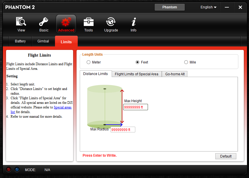

1.If you get out of range of (Home point) Will you still be in control if your receiver is still within range of the Phantom2v+ ?
In the Phantom Assistant application, set your limits to something large -- like this
+1.
Set to max in the case that YOU move out of the range. The phantom will just hover and land when the battery depletes.
