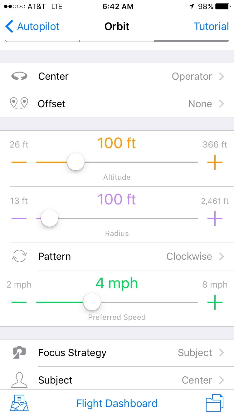

I think instead of a slider for changing data inputs. They should have a box where you just type in the number. The slider is very sensitive imo
Hello, when making adjustments you can use the slider which is fast and easy or you can just tap the plus or minus signs to make changes as well.
Reactions: Jack Ley
Hello, when making adjustments you can use the slider which is fast and easy or you can just tap the plus or minus signs to make changes as well. View attachment 43887
Yes I relealize that. But when you barely touch the slider you can go from 0 distance to 3 miles distance. A simple input box would make it easer IMO
I agree the slider does sometimes go from one extreme to the other and if you are not careful and let go at the wrong time you can have the Phantom fly off further than expected, the input box might be an idea or a full screen slider used on some apps if held down. Raise it with Autoflight Logic, they're very receptive to new ideas. I'dd do the same when I next contact them.
You should consider changing the Max Altitude and Max Distance Mode Control settings. If you choose smaller values the sliders will be much less sensitive.
