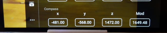

I am wondering where the numbers for your compass settings came from?

I don't know how to post the .dat file but here is a screenshot of it.
You need to share it with dropbox, onedrive, googledrive, etc.
