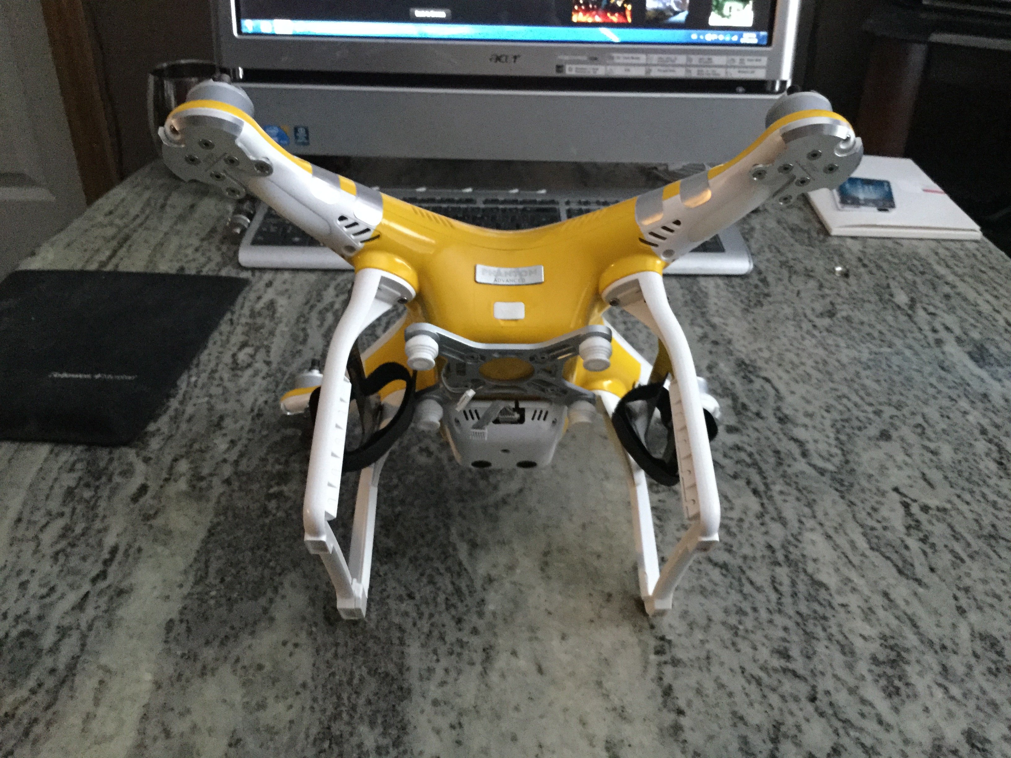

With out the strong arms it is far worse for cracking I still think that the strong arms help.my first shell was cracked all pods.this post is ment to help and be aware that things still can be a problem.i will still use them with out the strong arms it will be worse.looks like I will have to buy an inspire next time...this is still the V1 shell and to be clear about things I am also using battery mod more weight and flying in sub zero temperatures.i will be installing the new V2 hope this works no more cracking!!!!!i will still use the strong arms as well !!!Fly safe
Well well well take a good look at this even with strong arms!!!!!! Flukkkkkkk....body replacement 2-3hrs 80.00 bucks new shell. it's still under warranty but the hassle!!!! Ccccccrrrraaaaaaccccckkkkkeeeeeddddd Again seems to be more frequent on back motors #3 podView attachment 40428
It shows crack not on the motor mounting screws but somewhere on shell's neck.
