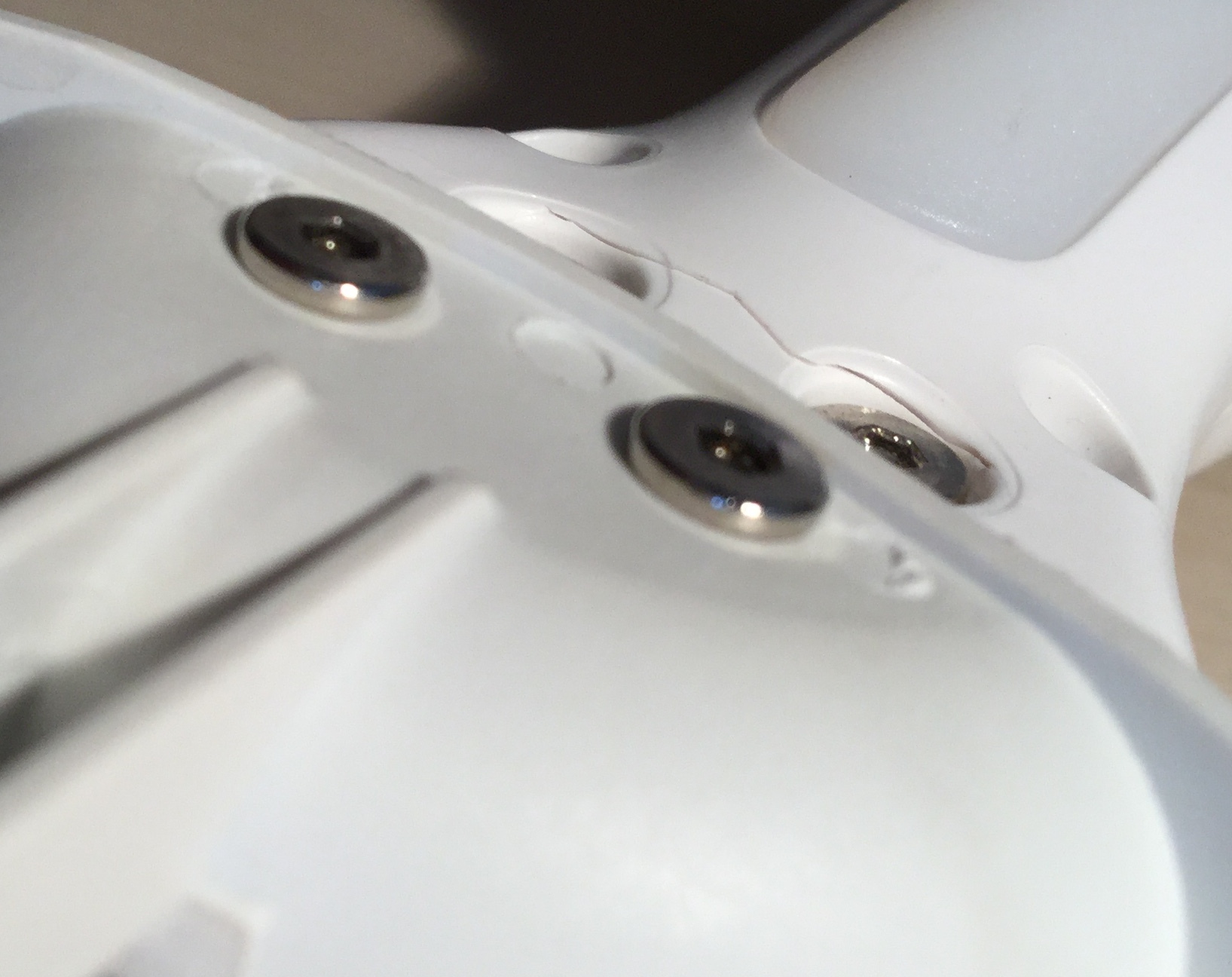

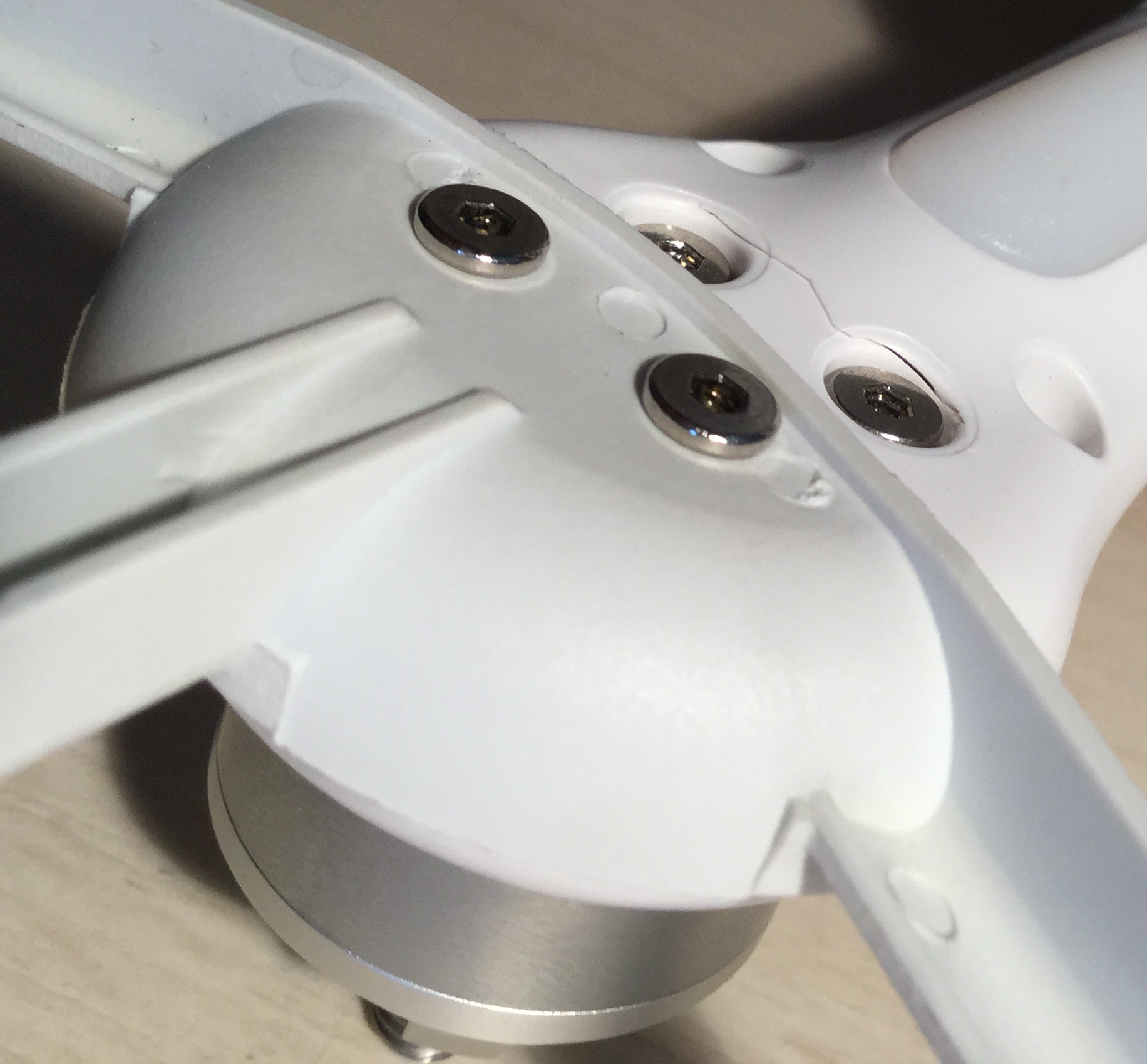

I have a stress crack in one of the arms. Because I can't send it in for free warranty repair, I installed the UAV BITS strong arms for removable prop guards, am I'm happy to report that after 19 flights (11 of those without prop guards), the crack has stayed stable. I think it'll stay stable, so I'll stop periodically taking off the strong arm to verify the crack.
This is the crack before installing the strong arms:
Next time I can I'll buy the strong arms for flying without prop guards, because now when I fly without guards the strong arms are secured with only 4 out of the 6 screws.
As for the cause of the crack, I think it's possible at least one time I flew without the 2 motor screws that go where the prop guards are screwed, because when I take out the prop guards I was often too lazy to put the short screws back on for transport, leaving just 2 screwed on every motor. If that was the case, it's most likely it would have caused the crack. Lesson learned, always put all 4 screws on even if just transporting.
Also, I'd get some good locktite epoxy, and gently fill that crack in
Wow.. Mine was far less than that...Mine is going to DJI. They can fix it.
If you are happy with the strong arms, fix the crack first and them properly mount strong arms with all the screws.

I'm not good with repairs, but the knowledgeable friends I've consulted have said that in order to fill the crack with glue I'd have to open it up a bit more, risking extending the fissure a bit. Should I still glue it? Is there another way?
