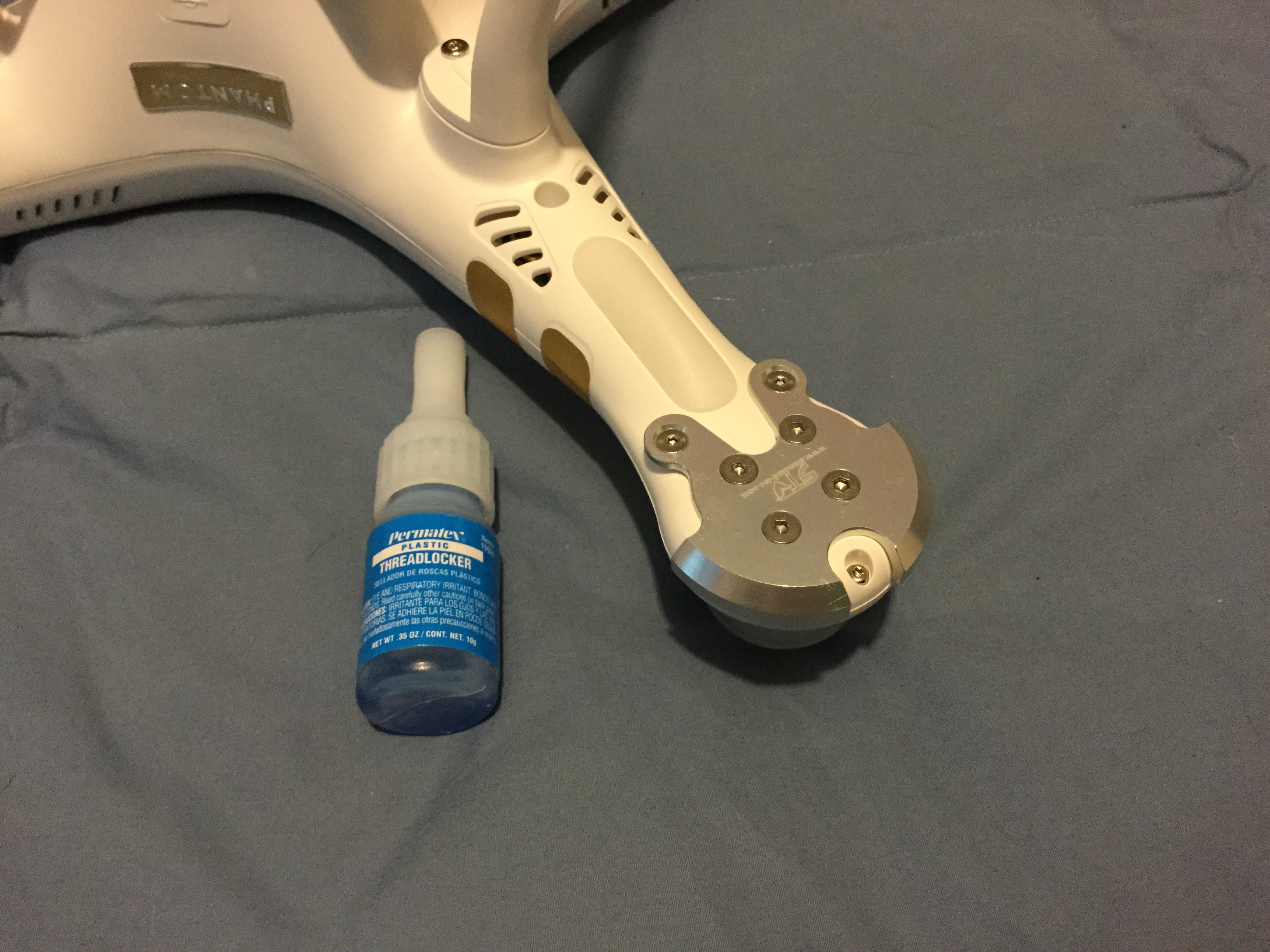

Finally got the Permatex plastic safe thread locker delivered and installed these: Standard Tech Operation - Motor Reinforcement Mount for Phantom 4pcs/ Silvery 10570008
They feel solid, and look great. We will see how it goes.

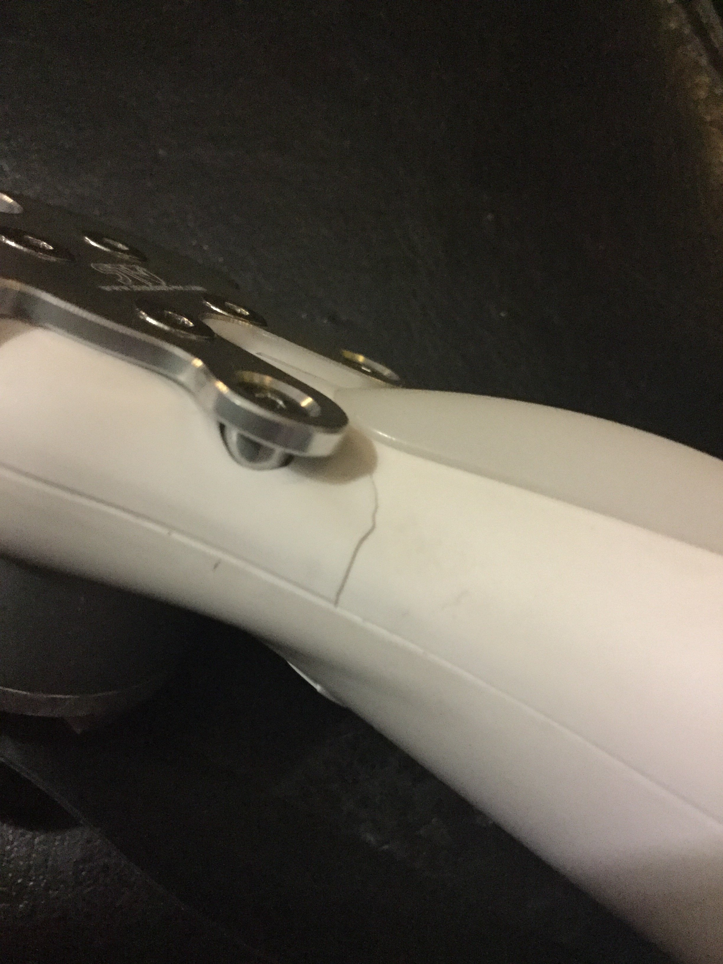

Well well well take a good look at this even with strong arms!!!!!! Flukkkkkkk....body replacement 2-3hrs 80.00 bucks new shell. it's still under warranty but the hassle!!!! Ccccccrrrraaaaaaccccckkkkkeeeeeddddd Again seems to be more frequent on back motors #3 pod
Reactions: Kevin Cabral
Well well well take a good look at this even with strong arms!!!!!! Flukkkkkkk....body replacement 2-3hrs 80.00 bucks new shell. it's still under warranty but the hassle!!!! Ccccccrrrraaaaaaccccckkkkkeeeeeddddd Again seems to be more frequent on back motors #3 podView attachment 40428
That's awful! I had mine installed but removed them because I thought I needed a repair from installing firmware 1.6. Haven't installed them back. I used white nail polish for loctite. Noticed white nail polish on the shell and inside the screw holes. Had to scrap them off. Well tried the best I can. Left markings on the shell from the scrapping though. The plastic should handle scrapping no? After your photo, I'm not going to install the plates. Lol...
I am sure I read before that they are a waste of time on the phantom 3 thread on rcgroups. It was a engineer explaining that the stress has to go somewhere and they made it worse.
I might be wrong but worth looking into.
