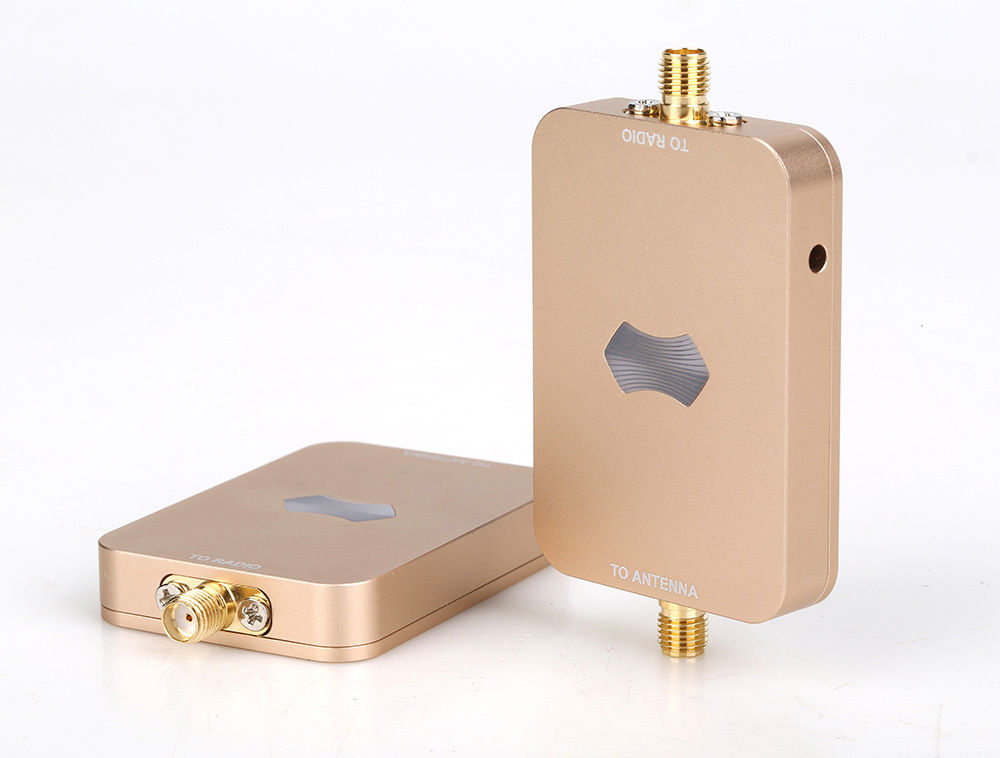

Here's a video showing the half-white and half-blue lights on my Sunhans amps:
The blue light on top amp is camera right. Blue light on bottom amp is camera left. I adjusted the exposure from light to dark, and dark to light, to show the blinking I mentioned in my first post. Everything was on and connected to P3P. Is there something wrong with my amps?
Never seen this version of sunhans amp, mine has 2 leds, green and blue. Green=power, blue=activity. Steady blue when remote is powered on = control link. Since your version is with 1 led only, it might act just as simple "power on" light.

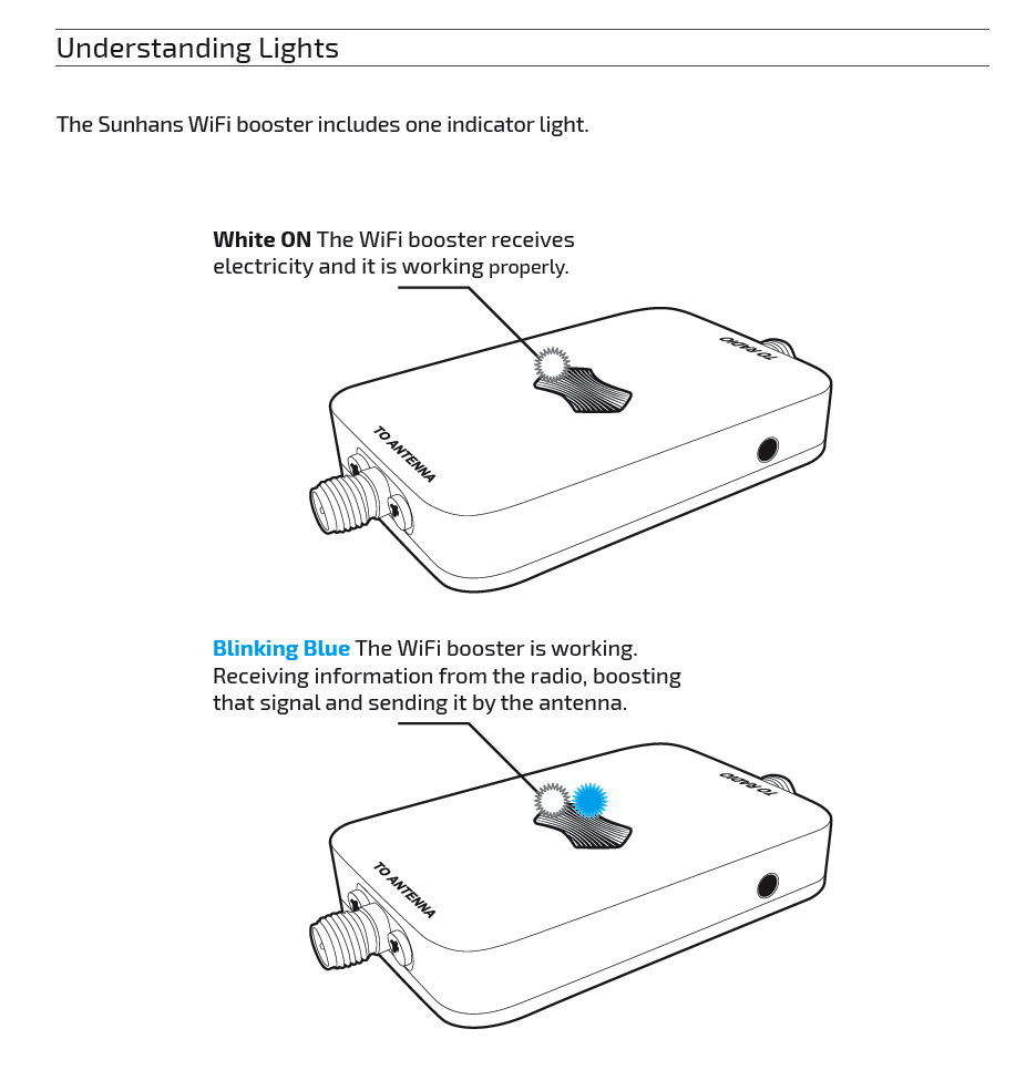

Each amp has 2 leds, blue and white. Manual says blue light should be blinking, but I could never see it blinking unless I video record it and lower the exposure. Not sure if this is good or bad.
That's what I need help with. I'd like to know if I'm doing anything wrong...or if this is normal.

Im pretty sure you are ok, when i had 2 amps connected before birdside mod, the other one was blinking so fast, it was also hard to tell. Those are new 3w versions?

There seems to be some confusion with the blinking (or not blinking) of blue/green/red (or whatever color it is) lights. I have the new 3W (gold/bronze?) Sunhans amp on my P3P controller with DBS antenna. They've always stayed solid blue (NOT blinking), no matter what I do. The only way I was able to make it seem like they're blinking was to use the camera on my iphone 6 and lower the exposure (make it look darker). That's when I could see it blinking really fast. It could be the frequency of the camera/iphone, or something like that. All I know is that with the "naked" eye, I could not see the blue lights blink.

I have the older silver Sunhans amps for my P2V setup. Each amp has two lamps, one green and one blue. If the amp has current, the green lamp lights up. The blue lamp will stay off unless there is RF moving to/through the amp. Once there is RF moving to/through the amp, the blue lamp will light up.
The question seems to be the blinking. From what I can tell in the manual and reading online, the blue lamp should blink intermittently indicating signal is moving through. And that is what I remember. I even looked it up on youtube and it showed a P2V Tx and RE with both amps and both amps were blinking intermittently.
But my 5.8 amp is now a solid blue. Was it always solid blue? I don't think so. Is it supposed to be solid blue? I don't think so. I even checked it in the dark to make sure it wasn't just blinking super fast, but it's a solid blue.
The 2.4 amp works as it should - the blue light blinking intermittently.
So what is up with the 5.8 amp?
I don't have an inline RF meter - all I have is an EMF meter, so I used that to test. I held the EMF meter 12 inches from the front face of the ITELITE antenna on all these tests. I held the device the same way - with my thumb and index finger holding the bottom side edges of the device.
First I tested it with everything off. It showed an HF energy rating around 1.0 (obviously it is reading energy radiating from other areas of my kitchen).
Then I tested with the P2V+ transmitter on - just the ITELITE antenna connected. No amps. It showed a rating of around 40.
Next I tested with the transmitter on AND the Sunhans 5.8 amp powered up and with the solid blue lamp. The rating now is 1827. That is the maximum number, it won't go any higher.
So my conclusion is the blue lamp indicates the amp is working correctly whether it is intermittent blue or solid blue.

I don't think I've ever seen mine blink, it just stays solid blue when in use.
