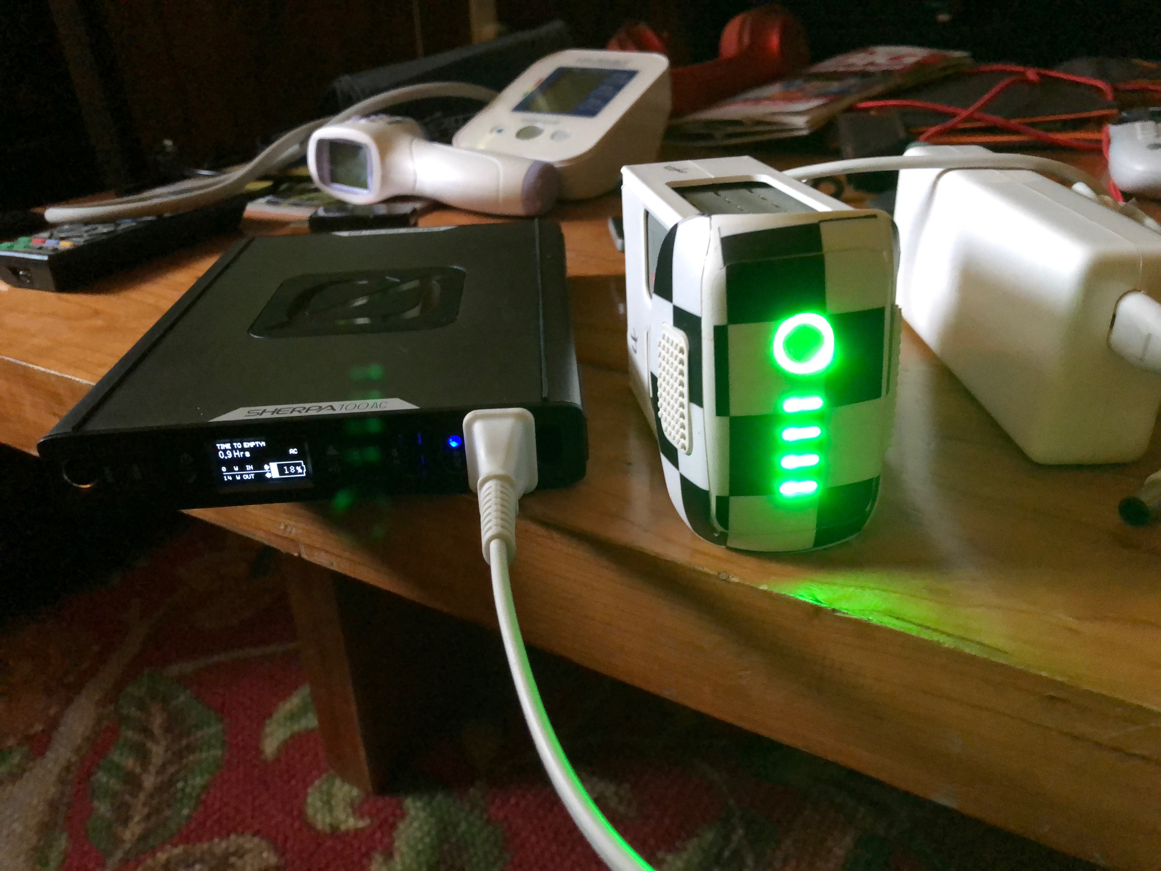

Here's my review of the Goal Zero Sherpa 100AC, which is compact, weighs 2 pounds and charges charges the Phantom 4 batteries without a hiccup. This also compares the Sherpa100AC to similar power banks.
I was not compensated in any way for this review or posting.
The Goal Zero Sherpa 110AC is under-promised and over-delivered.
I charged my Sherpa 100AC to 100% from 110v power adapter when I first received it. Then I put it to its first and stringent test: charging a DJI Phantom 4 Pro battery from the Sherpa 100AC's 110V AC-port. Mind you that the Sherpa 100AC is rated "up to 100 Watts" (.9 Amps). The Sherpa 100AC charged the DJI Phantom 4 Pro battery from depleted to 100% without a hiccup. At times, the Sherpa's informative and always visible illuminated display showed the drone battery drawing as much as 122 Watts.

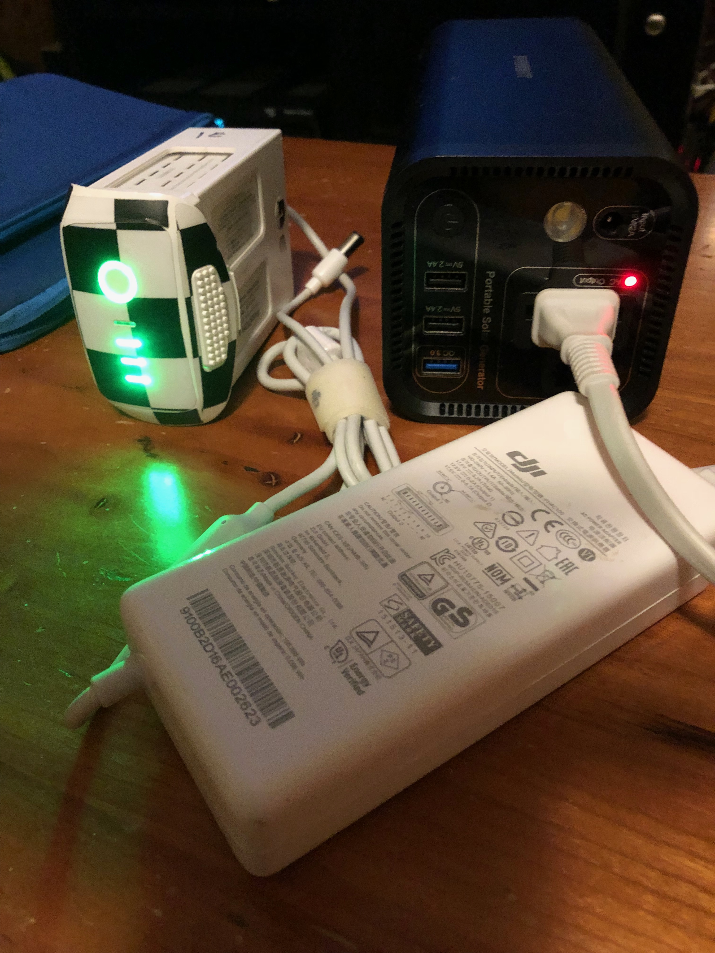

Now, admittedly an OCD person when it comes to "backups" of every type, I have many different "power banks" and solar panels...Although mostly Goal Zero. My place looks like a Goal Zero showroom. I tested the DJI Phantom 4 Pro drone battery against two other types of, supposedly higher capacity, power banks: The "Suaoki S270 Portable Power Station 150Wh Quiet Gas Free Camping Generator QC3.0 UPS Lithium Power Supply", rated at 150Wh and "max 100W, peak power 150W". After a few minutes of charging the DJI drone battery, the Suaoki Shut down completely. I restarted the S270 and again, after a few minutes, it shut down completely. While the S270 has several 12V, USB and 2 110V AC outlets, it does not have a Qi 5W wireless charger like the Sherpa 110AC does, not is it as compact as the Sherpa 110AC or have an informative display like the Sherpa 110AC does.
Next, I tested it against a iPrigent "Portable Solar Generator Power Source - 41600mAh 154Wh" which claims to have a 120 Watt inverter output. When I attempted to charger the DJI Phantom 4 Pro battery, it shut down in less than a minute. The iPrigent has a single 110 v output port/receptacle and two USB ports. The input port is a DC 19 volt, 2 Amp socket that charges the unit from an AC-adapter or solar panel. It lacks any "informative display" and simply states it remaining capacity with a series of 4 tiny blue LEDs.

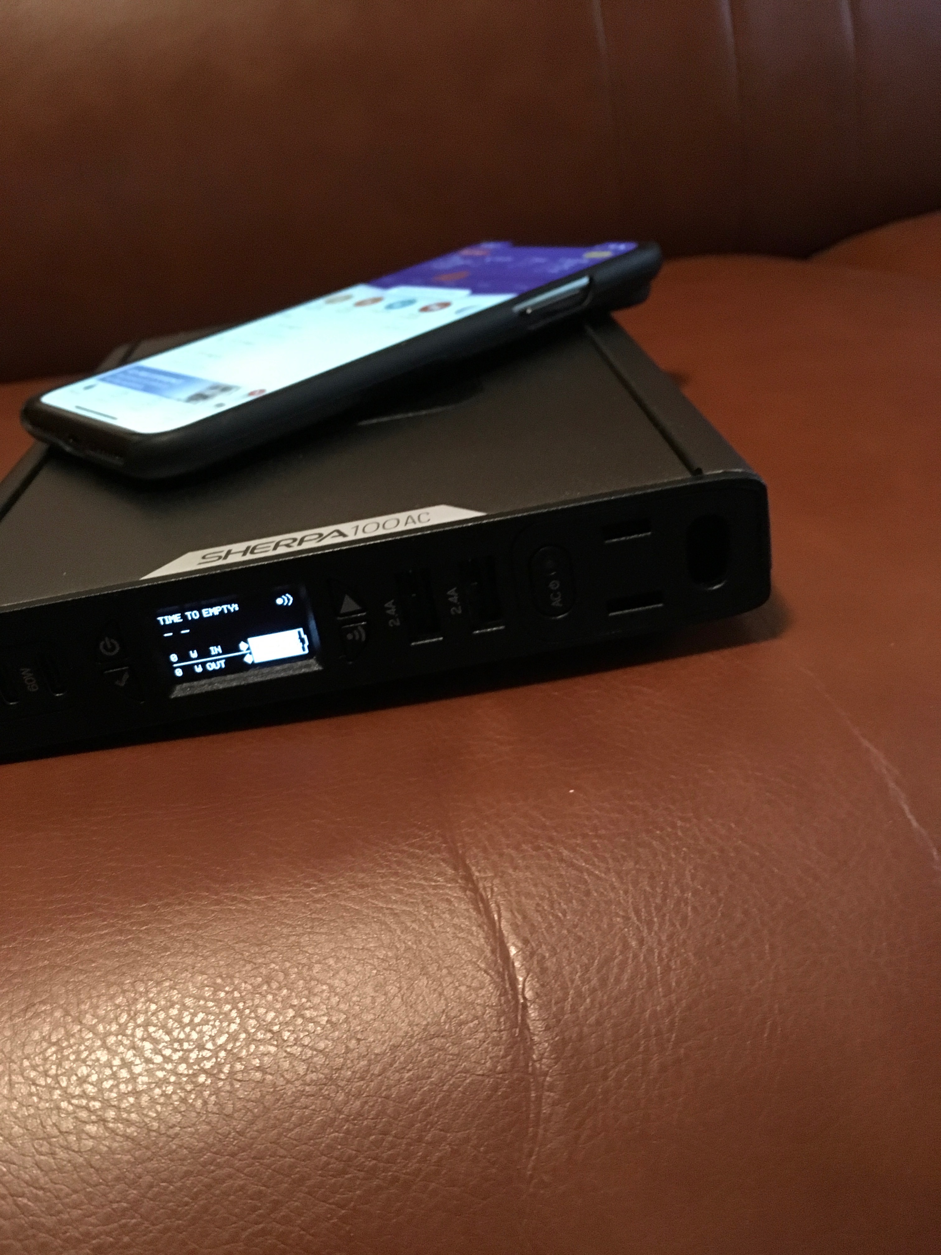

For input (recharging it) it has a standard 8mm Goal Zero input receptacle and two Type C connectors, each rated at 60 Watts each. The Type C connector is 2 way so it can be used for input (recharging) and output (charging something else). It can be recharged with a 12v car adapter as well. The Sherpa 100AC has 2 USB ports rated at 2.4 Ams each, and 1 110 volt AC receptacle . It has a wireless Qi 5 Watt charging pad for phones that have Qi compatible wireless charging, as with the latest iPhones and many Android devices and tablets.
I used the Sherpa 100AC to wireless-charge my nearly dead iPhone X, which took between 2 and 3 hours and only consumed 22% of the Sherpa 100AC's capacity.
