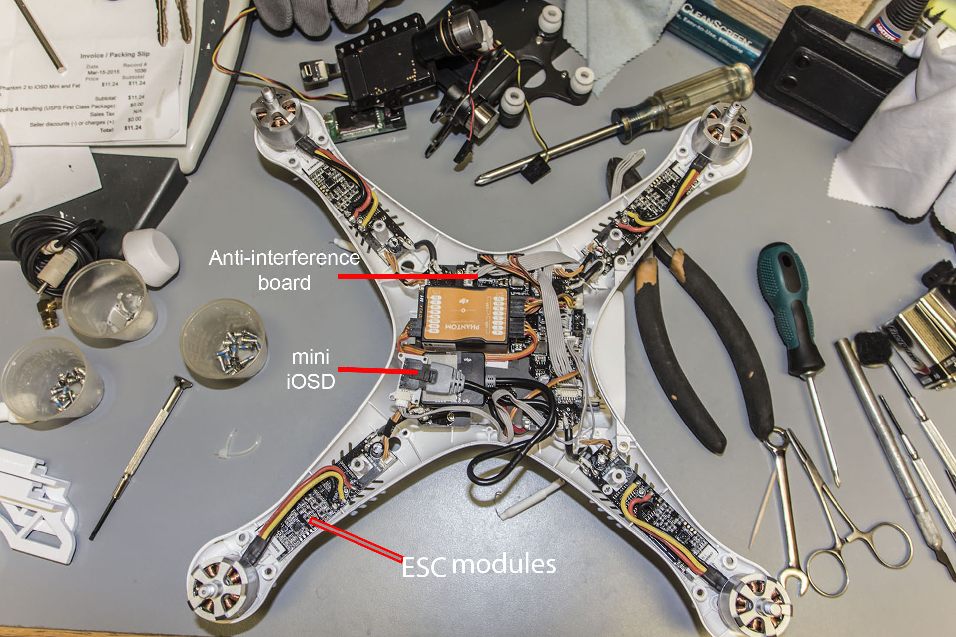

Another problem could be how you wired up the motors. Check out this photo:

Check the motor placement and wiring. Since the photo, I sent the battery compartment is to the right and CCW motor is top right while the other CCW motor is bottom left. Then check your solder connection for the motor which isn't working and solder connection from the ESC to the main board. Also, make sure the ESC board is plugged in correctly it is indexed.
