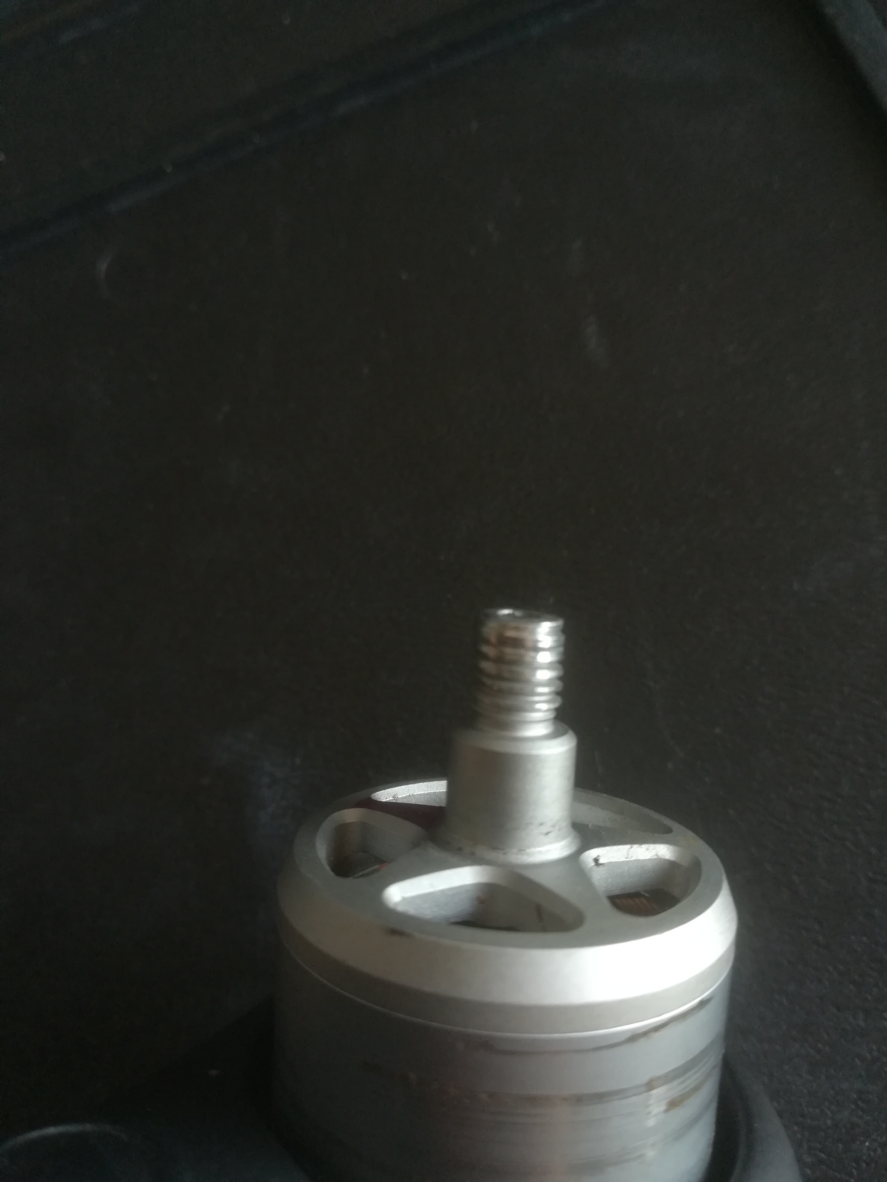

Specs: P3SE 2nd hand, with signs of having crashed before. One motor has a dent on the prop screw; I use always the same prop in that position (since the nick created new grooves). Have flown it a few times and it seemed to be flying well.
Problem: Today I went out to sea (I'm a marine biologist and the drone is a work instrument). Did a flight to photograph a marine turtle and when I was returning to the boat i saw the image turning up (see video below) and a message about something in the motor appeared briefly (I cannot remember the exact message). Got a bit scared, aborted a return-home request and brought it back to be hand retrieved. Upon seeing the video, I noticed that additionally to the jerk I saw, there was another one to the end of the video, when I was about to switch the camera off.

I tested the motors (without props) and cannot see or hear any difference among them. Also tried to turn them by hand and don't feel any noticeable difference.

Without having looked at the flight data but from your description, my initial rough guess would be that the fault lies with the dent on the prop screw. A picture of that might also be helpful. If the prop is somehow slipping then you can see how that one motor loses thrust and the drone tips in that direction. Luckily it re-engaged and you did not lose the drone. If it was me, I wouldn't fly until that issue gets resolved.
The solution would be to replace the motor. The cost is minimal (about $15 US). It does take a bit of work to replace the motor since you need to take off the shell, un-solder the old motor leads from the ESC and then solder the new motor leads to the ESC. If you're adept at disassembling electronics and soldering, it isn't bad. If you're not good with soldering, I would let a professional do it.

Thank you @PhantomFandom for the prompt and insightful reply. It makes sense. It's not easy to see in the pic but the screw is a bit worn. I will look into this more carefully. If needed, I can change the motor. I have some spares from a p3s that I believe are compatible

Yes i see the groove and I would not trust that prop shaft.
The P3 series had two different motor types (2312 and 2312A) although I believe the P3S only ever used one model. The two motors look physically different so just make sure it looks the same. Also do make sure you have the proper rotation (CW vs CCW), or you'll have bigger issues than you have now.
Yip that motor is poop,,every time you screw prop down it will never grab proper and will also kill thread inside prop,,have not seen a motor burred with thread like that,,,,,possibly cause is way to tight on prop thread or incorrect or cross threading when installing prop,,,,yip your very lucky not to be swimming ?
