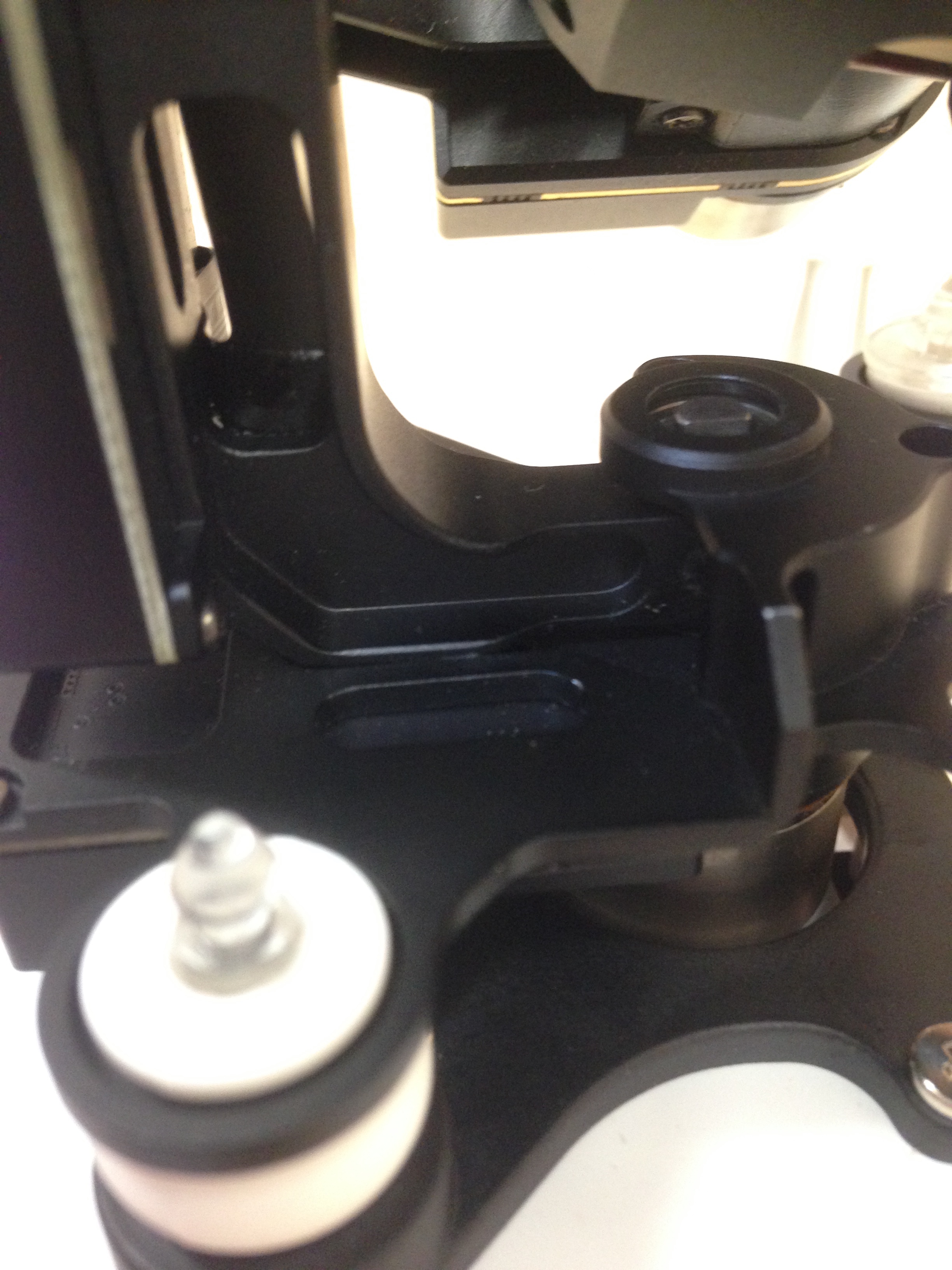

Yes I tried to see if I could ship one of these anti-interference board but it costs a 100$ to ship one from the US. It seems that I still have a problem as I just powered the drone and the gimbal, it lit up perfectly but as I observed the gimbal more precisely, the vertical axis is blocked while the two others work fine.
The vertical axis seems to be pushed towards the drone and is prevented from moving. I don't know if you see what I mean through the picture below.
Your photo is absolutely useless.
More then likely the gimbal vertical arm is at the pot of its travel on the motor shaft. there is a screw on the vertical arm loosen it and move it down then
re-tighten it.
Hi Jason,
Sorry for the photo quality, I did what you told me but in fact my vertical axis is not working anymore and as I moved it, the gimbal balance is completely disturbed. The second thing is that the whole gimbal was burning hot when I lit off the drone, this might explain why the anti interference board was blown up. I'm given the impression that I should rather buy another gimbal, except if you have a better idea.
