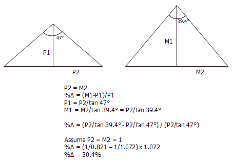

I simulated (through a professional software) various photogrammetric flights with Mavic.
I feel I can say that this drone is ABSOLUTELY not suitable for this type of application.
Setting a flying height compatible with the accuracy required to the ground, setting just a discrete overlapping and speed parameters, due to the reduced FOV, the complexity of the flights (number of strips and photos) increases in an unacceptable way.
The issue ends here for me... the optics of this drone is not suitable for making topography...

Pardon me, but surely for mapping purposes you'll need as long a lens as possible to prevent parallax errors, and using a 'longer' lens at a greater height with the same resolution would produce more usable results? I'm not certain I follow your reasoning in any case...
So what you're saying is... the Mavic, with its slightly lower FOV, would be even better because it reduces distortions... just go up 10 meters in flight altitude to keep the same number of photos, with less distortions... i'm right ?
Are your calculations based on square images?
4:3 format
Yep, pretty much. We used to have quite a list of issues due to parallax and distortion with GoPro fisheye's than the P3 series camera for mapping. I admit the stitching programs have evolved quite a bit in that sense but beyond that, capturing is a lot easier and also faster with P3/P4's 2.8 and the results have improved. The whole process is now a lot smoother. Of course time will tell, once it's out and working in the field we'll see about that but judging from specs IMO the Mavic's 2.2 shouldn't be a problem for photogrammetry.

Calculations on hands... or the FOV is narrower than what the DJI stated in the specifications or the focal length is lower than that DJI stated in the technical specifications...
It's not a question of flying higher... it's not a matter of tapping to focus... the optics of this drone is "lower" than that of the Phantom... its good just for selfies and social content...
It's hard to understand what your opinions are based on Pete. Would be interesting to ascertain what, if any, facts have allowed you to arrive at the conclusion the Mavic imaging system is inferior to phantom. By all accounts the images from the reviews suggest the Mavic is as good, it may be better. The sensor specs are the same. The lens may be physically smaller however that is not determinant if imaging quality. Just look at how a Leica Summicron 50mm compares physically to a canon f1.2 L series 50mm and consider the merits of the resultant images. The summicron pulls the pants down on just about anything going.
As to suitability for photogrammetric imaging your simulations demonstrate nothing. Reality is that any flyable imaging system with a rectilinear lens (within an appropriate focal length range) may be successfully used. 16 to 50mm (35mm full frame dslr equivalent) would all prove suitable.

From DJI official FAQ:
The two cameras have the same features, but the Mavic’s camera has a smaller FOV, is able to focus as closely as 0.5m and can be rotated 90° for portrait shots and selfies. The Phantom 4’s larger FOV makes it better suited for landscape imaging.
What do you mean by 'lower"? Most of the comparisons I've seen published so far have clearly shown the the resolution/sharpness of the Mavic images are as good if not better than those of the P4.
