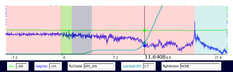

I looked at this flight some and will speculate there two problems.Clearly, the GPS module needs help.I'm still puzzled why the GPS is OK on the ground but starts failing with altitude.
It also appears the launch site was geomagnetically distorted as @F3honda4me was supposing.. At launch the difference between the magnetometer heading and the FC heading was about 10 degrees. During ascent the difference increased to about 35 degrees when the AC reached 3.7 meters.
It would seem that the Mavic FC is smart enough to take corrective action when this happens. Recorded flight data vs real time data The P4 Pro probably is as well. However, with the GPS problems it wasn't able to.
I couldn't find any data or reason to suspect the compass needed calibrating
It would seem that the Mavic FC is smart enough to take corrective action when this happens. Recorded flight data vs real time data The P4 Pro probably is as well. However, with the GPS problems is wasn't able to.
